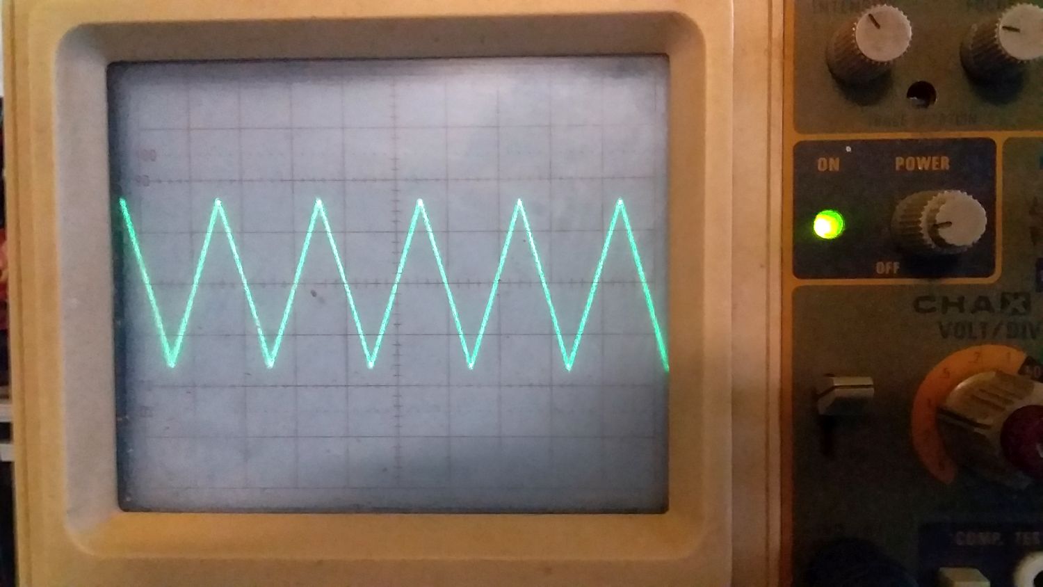

Here's what a 1kHz Triangle wave signal looks like on the Oscilloscope screen:
Attachment 36084

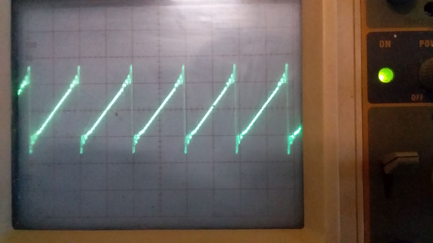

And here's what a 1kHz Sawtooth wave signal looks like on the Oscilloscope screen:
Attachment 36085
Notice how our 1kHz Sawtooth waveform has a bit of ringing at the top and bottom sharp corners?, that's because it is a digitally-generated Sawtooth waveform, a Sawtooth waveform generated by an analog circuit doesn't have that ringing, but for the purpose of this mini-tutorial, the digitally-generated Sawtooth waveform is good enough.

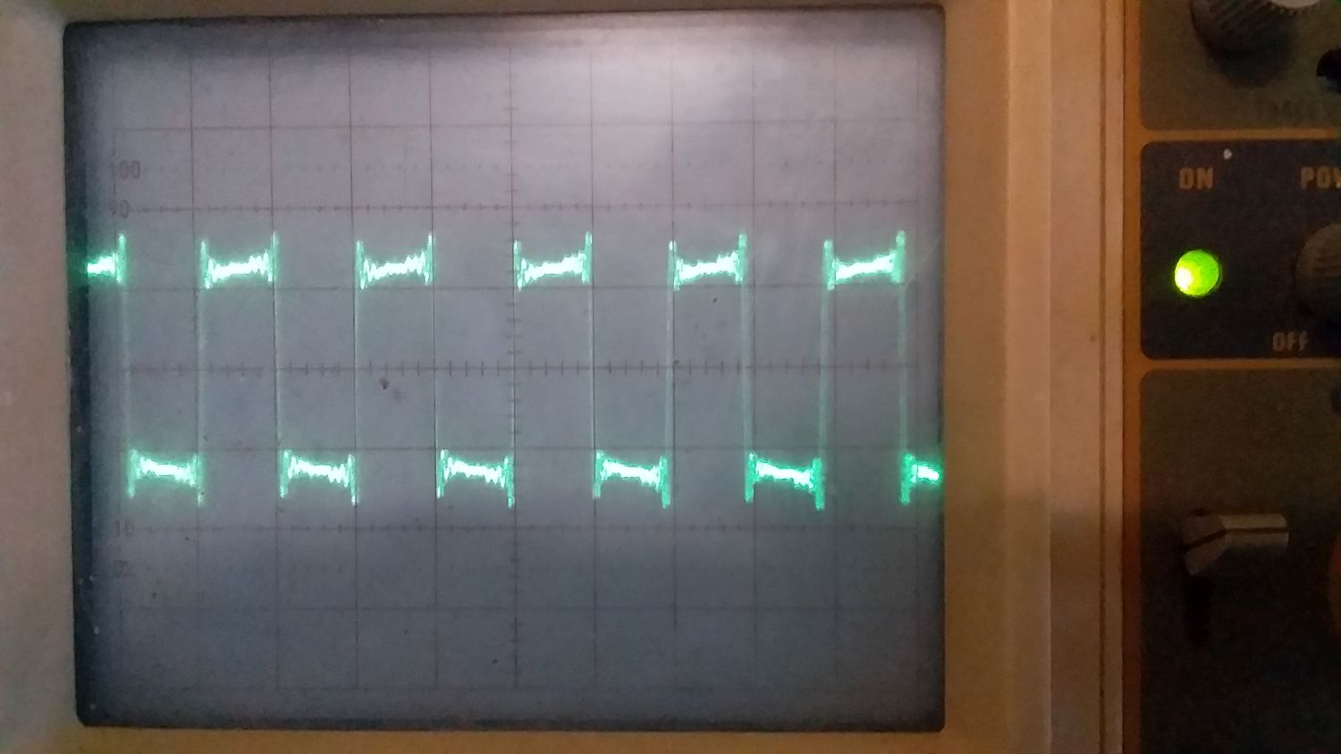

Finally, here's what a 1kHz Square wave signal looks like on the Oscilloscope screen:
Attachment 36086
Again, we see ringing on the top and bottom of the waveform due to it being generated digitally:
In each case, I had the main Time/Div. control set to .5ms/Div., that means for every 1cm horizontal graticule mark, that represents a time-interval of .5ms (mili-seconds), each of the signal waveforms takes two 1cm horizontal graticule marks to complete one-cycle, so the total-time for one complete cycle is .5ms+.5ms= 1ms.

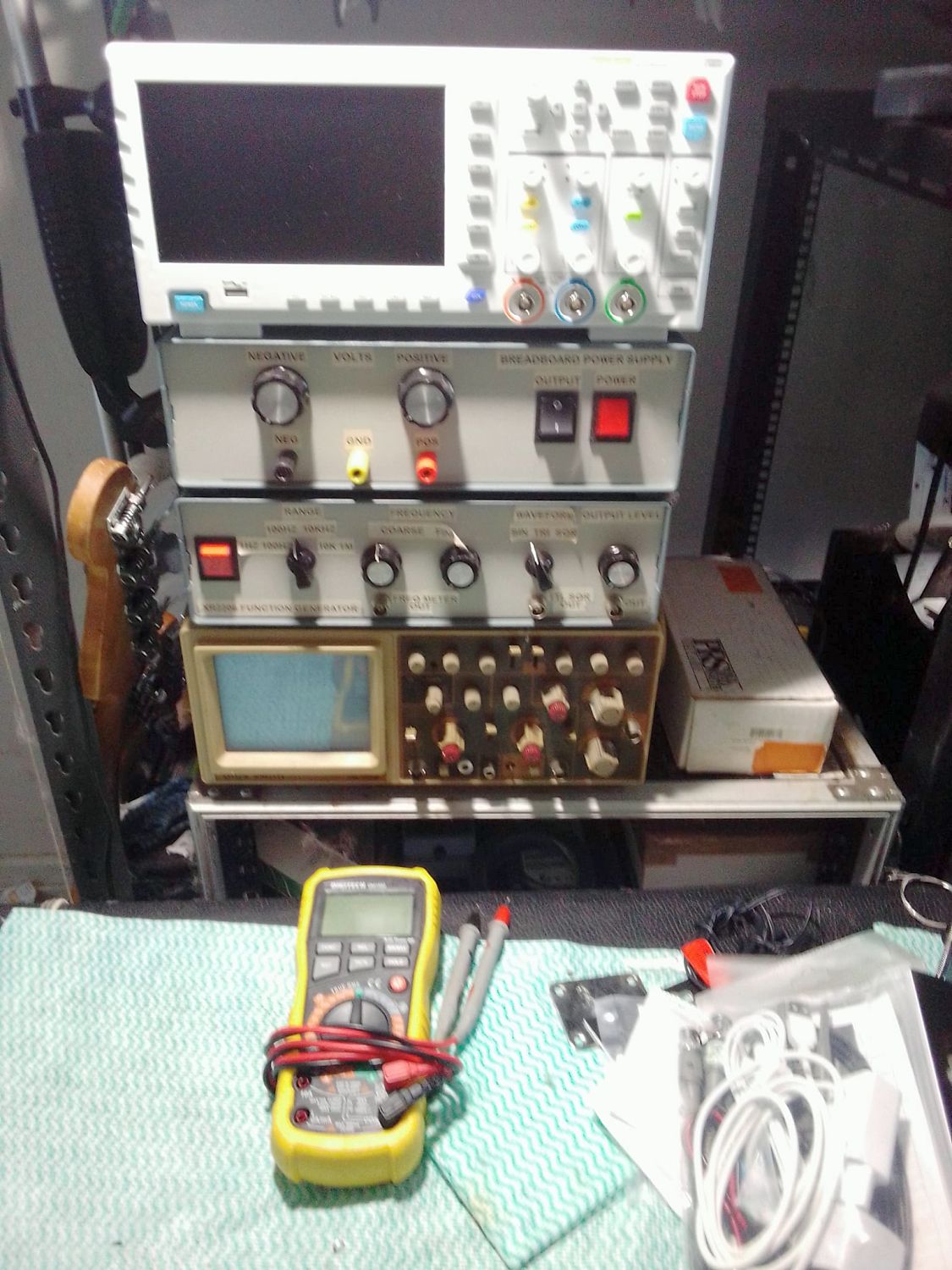

		I ended-up buying myself a new FNIRSI 100MHz Dual Trace Digital Oscilloscope/Function Generator, here's a pic of it sitting on top of my other pieces of test equipment, underneath it is a +/- 15V/500mA Dual Tracking Breadboard Power Supply I built, underneath that is an XR2206 Function Generator I also built, and underneath that is my old DSE Q-1804 20MHz Analog Dual Trace Oscilloscope.
Attachment 45687
