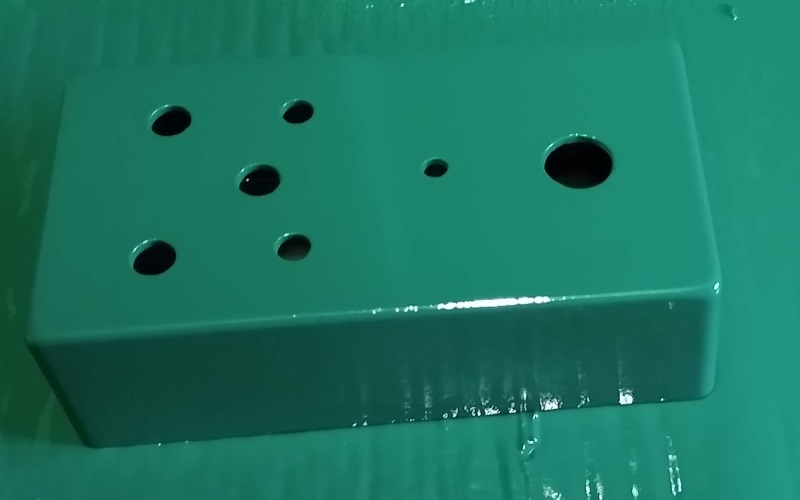

A little more progress today (although mostly focused on getting the Direct Drive finished) painting the enclosure. It's not Tube Screamer green, but it's green enough I hope. It's also the only green I have on hand. What a coincidence!
Attachment 35559
I'm so happy you are doing this build for FW. I was just playing my TS clone today and loving every minute of it.
