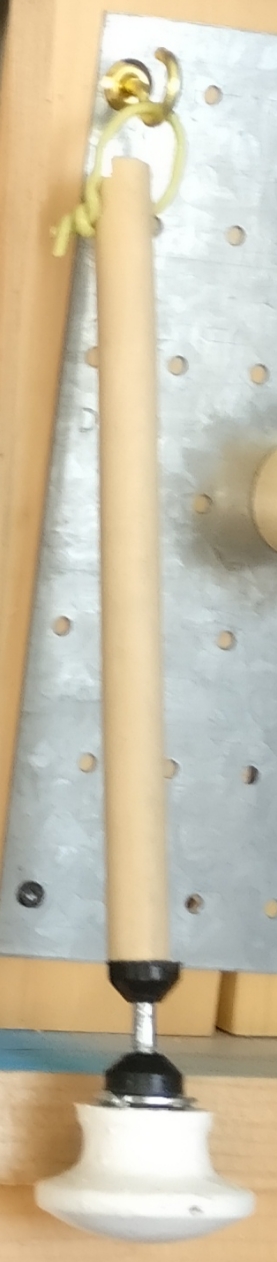

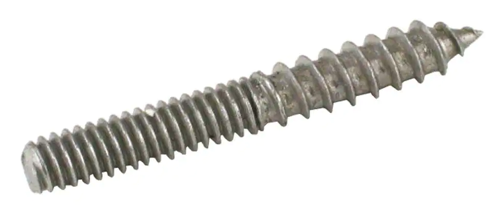

I put the handle in the neck pickup cavity because it felt like it balanced a bit better. I don't think your screws need to be very long. The wood inside the cavity is paulownia. It's soft, but also light. Paulownia is very easy to dent, but I have even mounted a string-on-top bass bridge without having a screw pull out. The lightness also helps. I have made two basses with these bodies. They weight is about 3.4 kg with the neck and all the hardware and strings in place, so I don't think you need to worry too much about a screw pulling out. You just need to be careful not to drill too deep! On the other hand, if you are worried then use the bridge cavity. I don't think it makes that much difference.
If you make a tool like the one I used for flipping the neck I would suggest using a small nut and compression washer rather than the large knob I used. The knob was fine for me because I would flip the neck and then take the tool off for a brush on finish. Since you are spraying, it would be best to leave it in place, so you want a smaller foot print so that it does not interfere with the spray.
Also, with regard to the handles, I would make them as short as is practical. It has to be long enoug for you to get a good grip, but the shorter it is the less it will get in your way when spraying.
