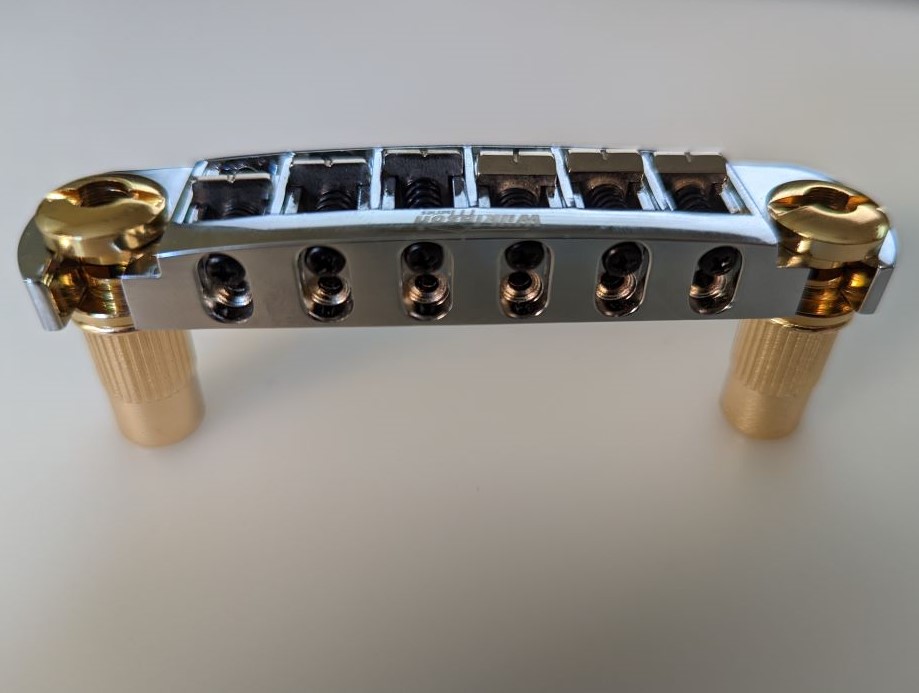

I ended up binning the locking studs. They didn’t fit the musiclily or kit bridge at all. Also the musiclily bridge vibrated way too much but it had good intonation adjustment range. I ended up with a gotoh bridge which has a locking post system built in. No rattles and much better sustain. How ever the intonation range adjust is very limited and I neatly had a dud guitar. Luckily reversing the saddles did the trick.
Thanks. I saw your previous post about the studs not fitting. Did you purchase the metric version?
My set are ok. I haven’t tried them with the kit bridge but they are fine with my Wilkinson replacement. You just need to line up the slot correctly otherwise they won’t close down properly when you tighten the screw.
Yep purchased the metric version and lined the slots up. Still didn’t fit. It was a blessing in disguise as it forced me to upgrade my bridge which is much better from a tone perspective.
I am loving the tone out of the Tonerider ac2 pickups. I noticed you bought the same pickups. The coil split tone is really nice with the hollowbody. Sound better than my real prs solid body.
https://www.pedalpartsaustralia.com/...oducts_id=2281
Here is a link for the socket
Here's a photo of mine. It's a little fidgety to set up but fits nicely.
So far the black allen key screws seem to be ok. But I will look to replace as the black colour doesn't quite suit.

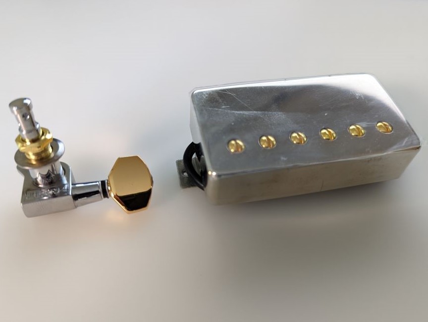

Nice to hear. Yes, I have the AC2s. I will coil split also (using a push/pull for the tone knob).
Here's how the pickup and machine head looks in my two tone scheme:
