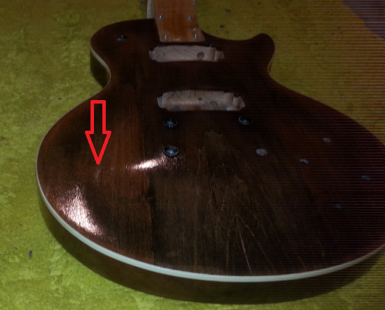

Headstock looks great.
Depending on where you live and what the weather conditions have been like may dictate how long to leave things. 22 coats sounds like plenty but it also depends on how many periodic wet sandings were done as each session would remove some of the layers?
If it were mine I would start with nothing under 1500 at this stage of the build as you are now trying to polish it up rather than sand off imperfections and too coarse a grit will do just that. Still need to go easy with both 1500 & 2000 as they can also strip more off than anticipated.
Whilst wet the body should start to feel very smooth and glassy which becomes a hint to move up to the next finer grit. If you haven't already got some micro mesh pads it would be a good idea to order some as they really bring home the glassy look.
