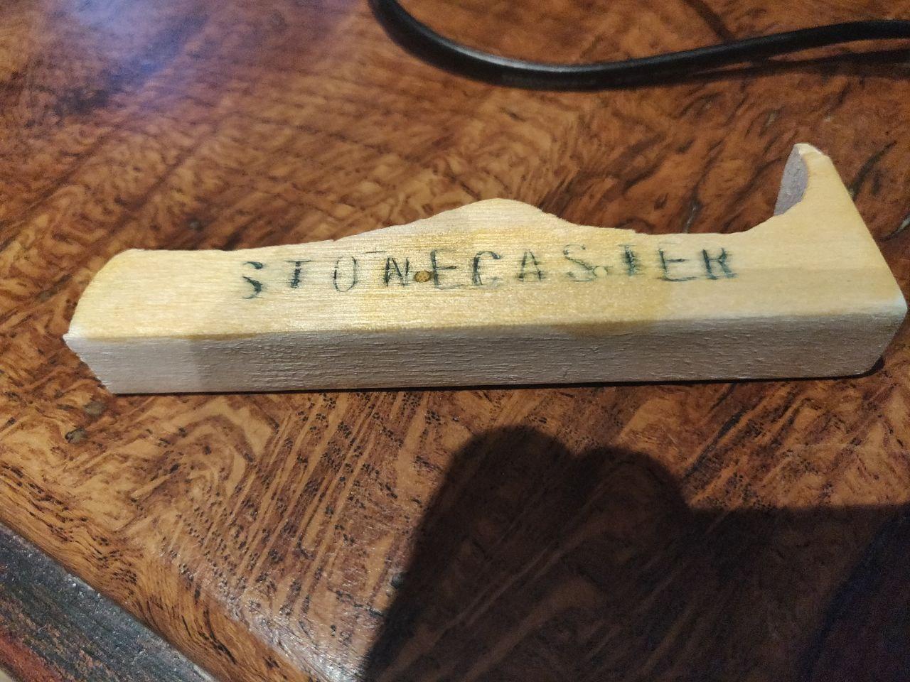

Tried using punches to spell out the name on the headstock offcut, then filling the letters with a sharpie and wiping off the excess. I kind of like the effect:
Attachment 34588
...though I should have used a jig to keep the line a bit straighter. But while it's a pretty cool rustic effect, I think it's too rustic for this build. Better to go for a decal, I think.

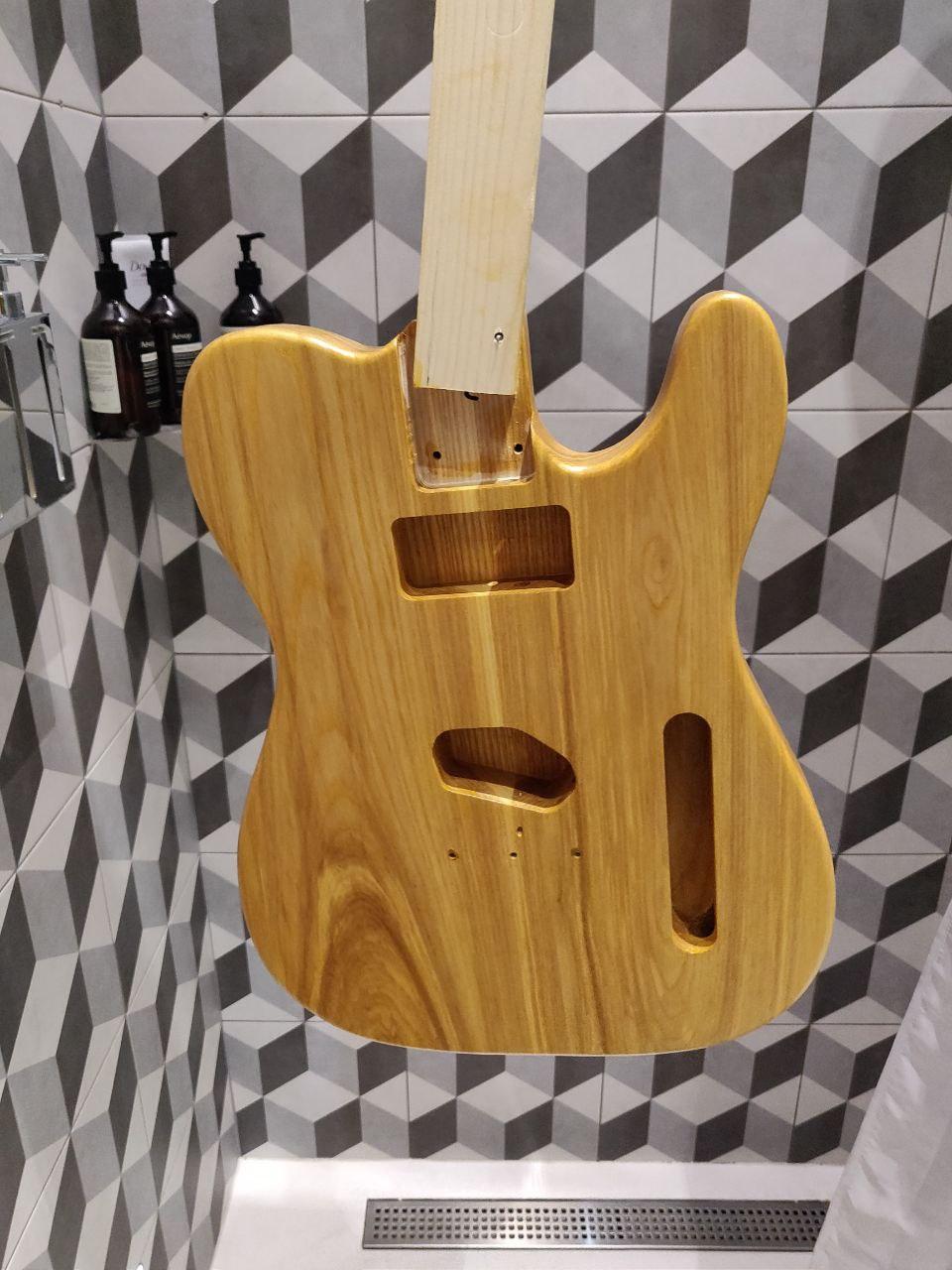

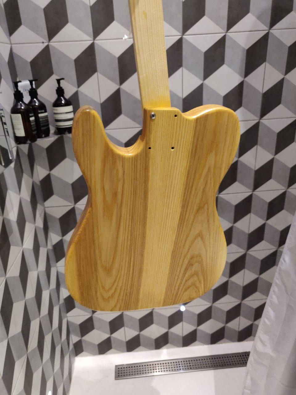

So anyway, I've now learned why builds go dark at about this stage. Getting a good finish does take quite a while!
Eight coats of the base coat on the body, which took it to the colour I wanted, then six of the clear top coat.
Attachment 34797
Attachment 34798
Looks good, but maybe a little shinier than I wanted; although the bottle says satin, each coat makes it a bit glossier, which is understandable. Maybe a light rub with some sandpaper (1000 grit?) would make it closer to what I want? If so, perhaps a few more coats of top coat would be a good idea for protection, then a final satinisation...

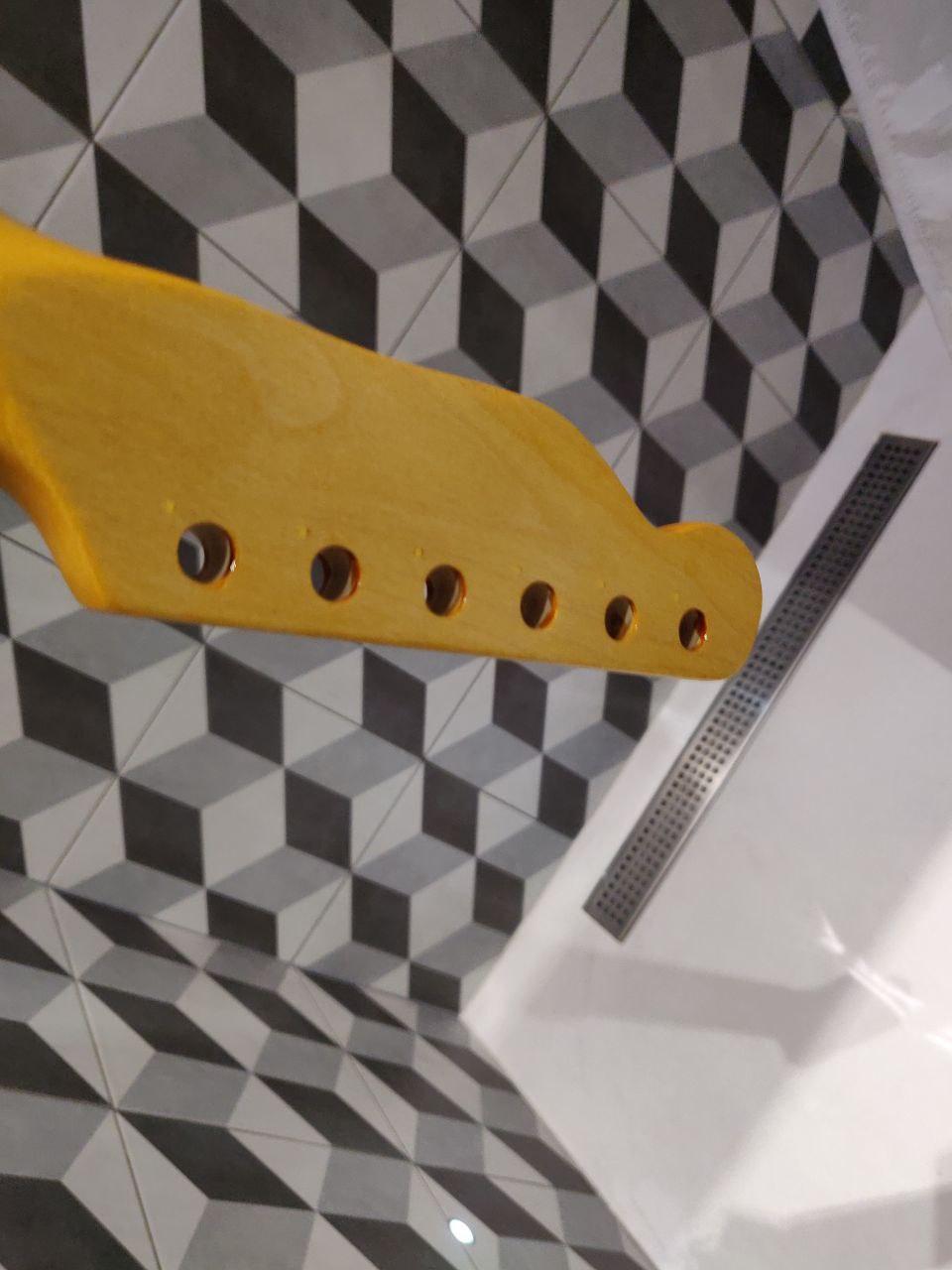

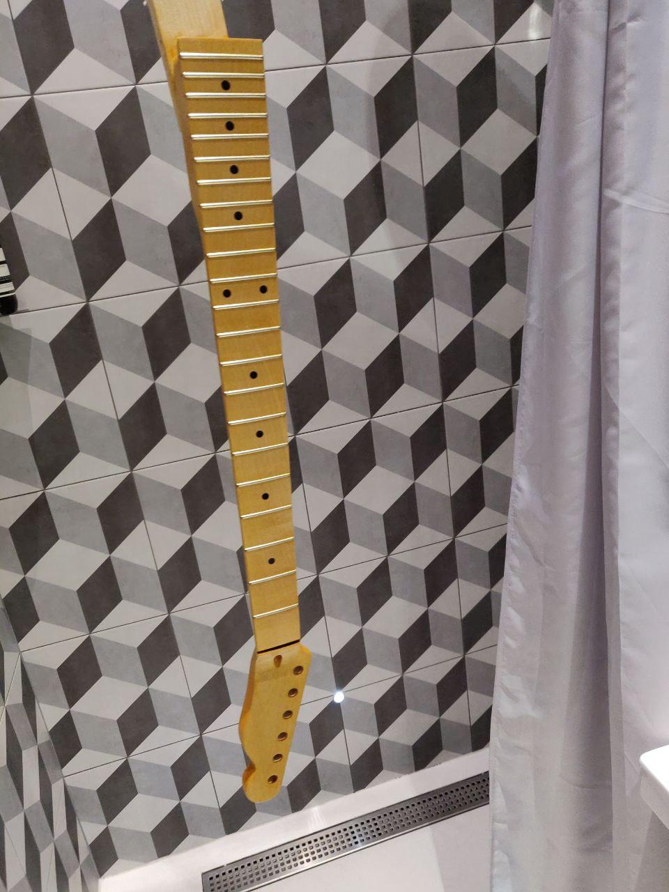

Only six coats of colour on the neck, and so far one of the top coat.
Attachment 34799
Attachment 34800
I think I'll give it another top coat before putting on the decals, then a bunch more to protect it. Here I do want a nice smooth finish, for obvious playability reasons....
