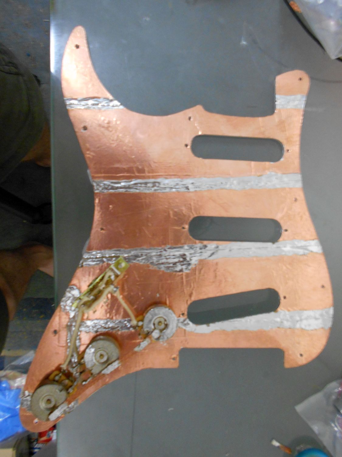

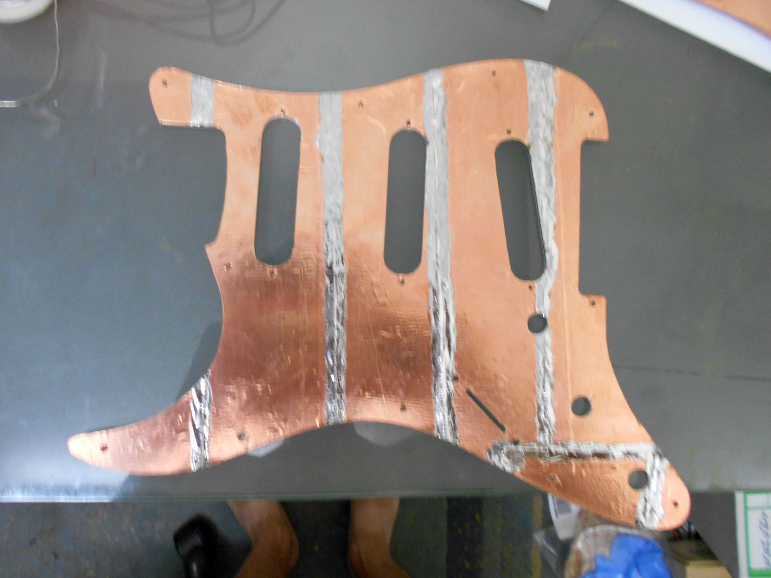

I decided to go all-out with the shielding on the scratchplate and covered it completely with the copper shielding-foil, now some builders may think that's a bit excessive, but personally I think you need a good solid ground-plane in a device, or instrument, that's generating a relatively low-voltage, low-current signal in order to reduce the susceptibility to hum and radio-frequency noise, the last thing you want to hear in a live, or recording situation is either a constant..mmmmmmmmmmmmmm.....in the background, or some radio station broadcast from a foreign country to disrupt your performance of that meticulously constructed epic solo, or song, which tends to happen when you least want it to, i.e. right at the start or right in the middle of it when you're all hyped up.
Once I got the shielding all done, I used my multimeter to check for continuity all across the underside of the scratchplate, I found that there wasn't continuity between adjacent strips of copper-foil so I used my Soldering Station and some standard 60/40 Electronic grade solder to solder each strip together, after that I got readings of well under an ohm (0.02 Ohms) all across the underside of the scratchplate, so that was good enough for me, I'm just in the process of doing all the final wiring-up of the scratchplate now so stay tuned for more updates, and pics of my progress.
Note:
I'm going to see if I can buy some Conductive Shielding-Paint from my local Jaycar Electronics store next fortnight, I'm pretty sure they do stock some, if do manage to buy some I'll use it to coat the body routing.

Well, I've finished doing as much of the scratchplate wiring as I'm able to do, because I'm still waiting on the Entwistle ASN57 Noiseless pickups to arrive in the post, and also for the Strat body to finish drying, there's not a whole lot I can do in the meantime, yes, I could order another guitar kit but I'm low on money as it is, anyway, here's some more pics of the progress I've made so far on the scratchplate:

Here are some more pics of the Scratchplate:
Attachment 10141
Attachment 10142
Attachment 10143
Attachment 10144
So, as you can see in the pics, I put a lot of shielding on the Scratchplate to create a great big ground-plane, hopefully that'll make my guitar relatively noise-free, you can see where I have soldered the individual strips of copper-foil together where it's a silvery-colour, all over the Scratchplate I'm getting a reading of 0.02 Ohms which is good, I linked the three pots together with some copper-braiding I salvaged from some old microphone lead, this is to ensure that there is still a ground-path if the copper-foil wears through underneath where the pots mount on the Scratchplate, all I need to do now is wait for the new pickups to turn up in the post so i can install them, the output-jack is going to be attached to the Volume-control pot via some vintage-style shielded cloth-covered wire.

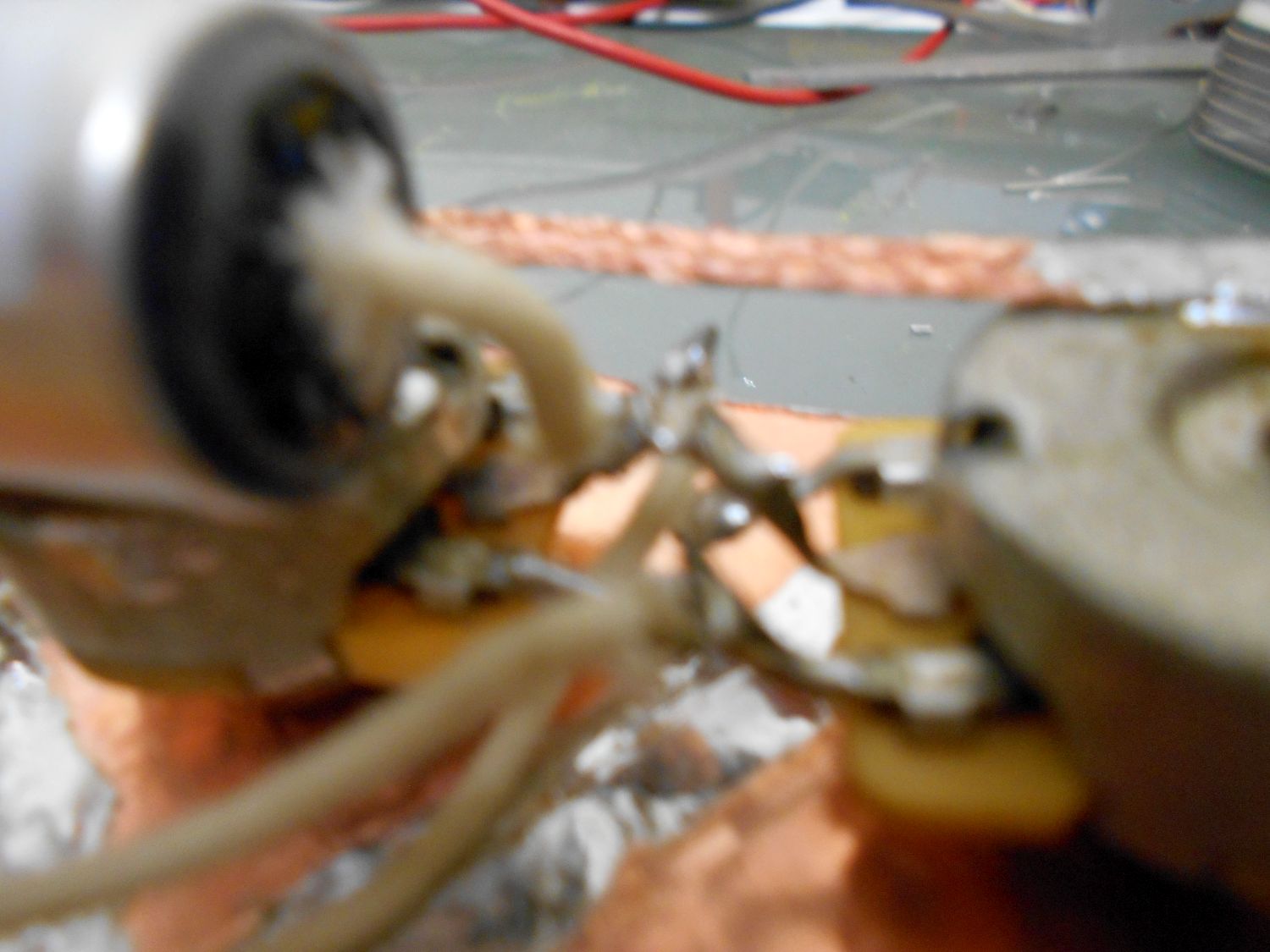

You can also see the Vitamin Q .1uF/630V DC Tone Cap installed on the scratchplate, I had practically no issues with overheating while soldering the cap in place, you may also notice that I put a piece of cloth-wire insulation on both solder-tags of the cap, that's partly to prevent unintended short-circuits, and partly for aesthetics, hopefully everything is working correctly.
Incidentally, I have wired-up the Scratchplate Eric Johnson style so that it follows this setup:

Hey Doc i would cover that earth wire with some heat shrink.

As per tonyw's suggestion, I've put some black heatshrink-tubing on the braided earth wire strung between the pots, here's what it looks like now:
Attachment 10148
The heatshrink-tubing actually does serve a practical purpose, it stops the Tone1 pot from shorting out the Tone Cap against the earthing braid.

I forgot just how massive those Q's are! :p
Nice job on the wireing Doc, if I may throw my 1.25cents worth in, it isnt necessary to earth pot to pot when you have done such a beautiful job with the shielding as it acts as an earth for you. But it cant hurt..

That's alright mate, you're right, I probably didn't need to earth the pots, my philosophy is that it's better to have something and not need it than to not have it and need it a lot, I have had guitars in the past where the earthing foil had worn through where the pot mounts through the scratchplate, and caused a bad hum problem, so if you earth the pots together like I've done, the foil can still wear through but there'll still be a good earth connection, of course not everyone will wire-up a guitar the same way, most people will have their preferred method, and there's nothing wrong with that.

no harm Doc, at least you know with the copper shielding the pots will be earthed. Page 63 mate you think you can reach 100 pages ?
