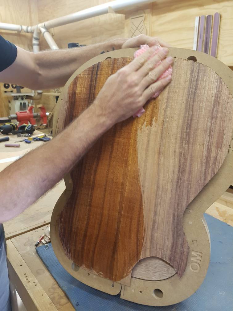

Day 6, The half way point!!
Part 1:
Today was more work on the body. Overnight, the top cured, even though I could have started something on it last night, I wouldn't have finished it. So it was best left till today.
After taking off all of the clamps, I left with this.
https://uploads.tapatalk-cdn.com/201...be76369604.jpg
https://uploads.tapatalk-cdn.com/201...6d2b52374f.jpg
https://uploads.tapatalk-cdn.com/201...232c7fc342.jpg
https://uploads.tapatalk-cdn.com/201...2c609ba22d.jpg
Then grabbing the hand router, I buzzed off the edges to get a pretty close edge. I played around with the binding direction for a teaser of what was to come!
https://uploads.tapatalk-cdn.com/201...0f74bf9680.jpg
Sent from my SM-G930F using Tapatalk
Day 6: Part 2
Here's the trimmed up box
https://uploads.tapatalk-cdn.com/201...e254ba480e.jpg
https://uploads.tapatalk-cdn.com/201...706e4f2276.jpg
https://uploads.tapatalk-cdn.com/201...fb8c46cf09.jpg
https://uploads.tapatalk-cdn.com/201...6b3f6a569e.jpg
The point of the cutaway was pucker inducing!!
https://uploads.tapatalk-cdn.com/201...a779ae039b.jpg
Day 6: Part 3
Over to another bench to route out the binding channel top and bottom.
https://uploads.tapatalk-cdn.com/201...6d9927844e.jpg
Next step is carving out a spot for the end wedge. https://uploads.tapatalk-cdn.com/201...23d25b99fd.jpg
This is purely a decorative piece to cover up the join where the two side pieces meet. This was my second attempt after I mis-sanded the middle piece by less than 0.5mm!
https://uploads.tapatalk-cdn.com/201...9169650b28.jpg
Still a dry run to go over my options for how this section would all meet up. I had in mind to miter all of the corners to have it all flow together seemlessly, but I don't have the time to attempt that!
https://uploads.tapatalk-cdn.com/201...c18f627fdc.jpg
Glued in place.
https://uploads.tapatalk-cdn.com/201...05f53af4e4.jpg
