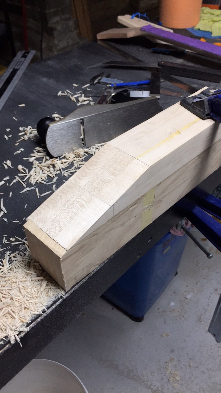

Said blank is now in two pieces and a large pile of shavings as below:
Attachment 15774

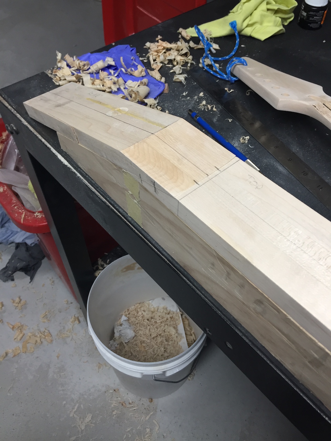

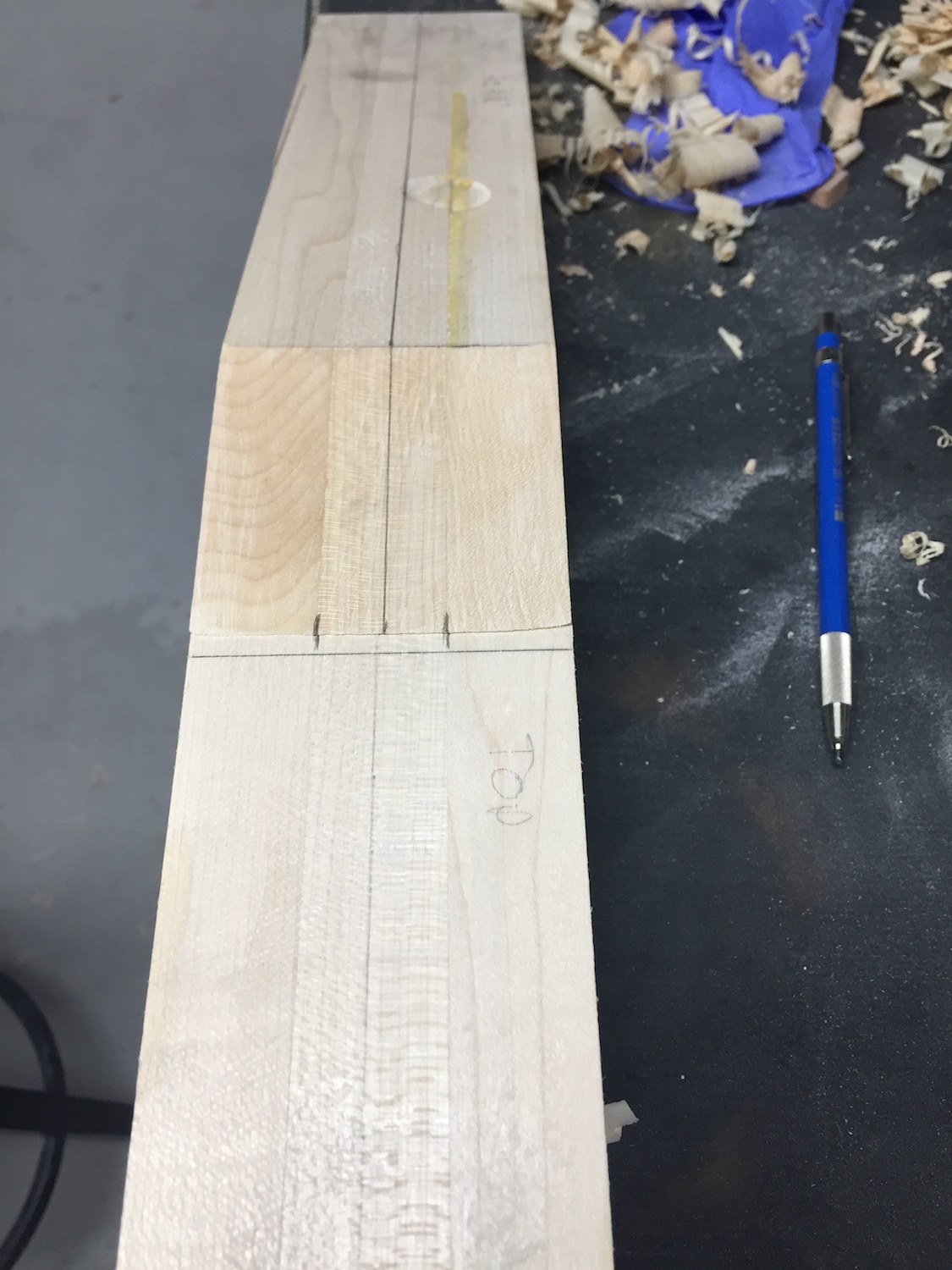

So far things are proceeding according to the rough outline of the overall plan so that these bits end up being glued to look something like this:
Attachment 15775Attachment 15776Attachment 15777
There is a bit of work to do in terms of clamping Cauls and set up before we are ready (read: fool hardy enough) to proceed with sticky stuff.
The keen eyed denizens will notice that in the last shot that the centre lines do not line up. The reason being that the blank was not quote symmetrical about the centre line, once glued I will establish a new centre that maps down the middle of the centre laminate across both head and shaft of the neck. as you can see i have (attempted) to line things up by the edges of that centre laminate.
