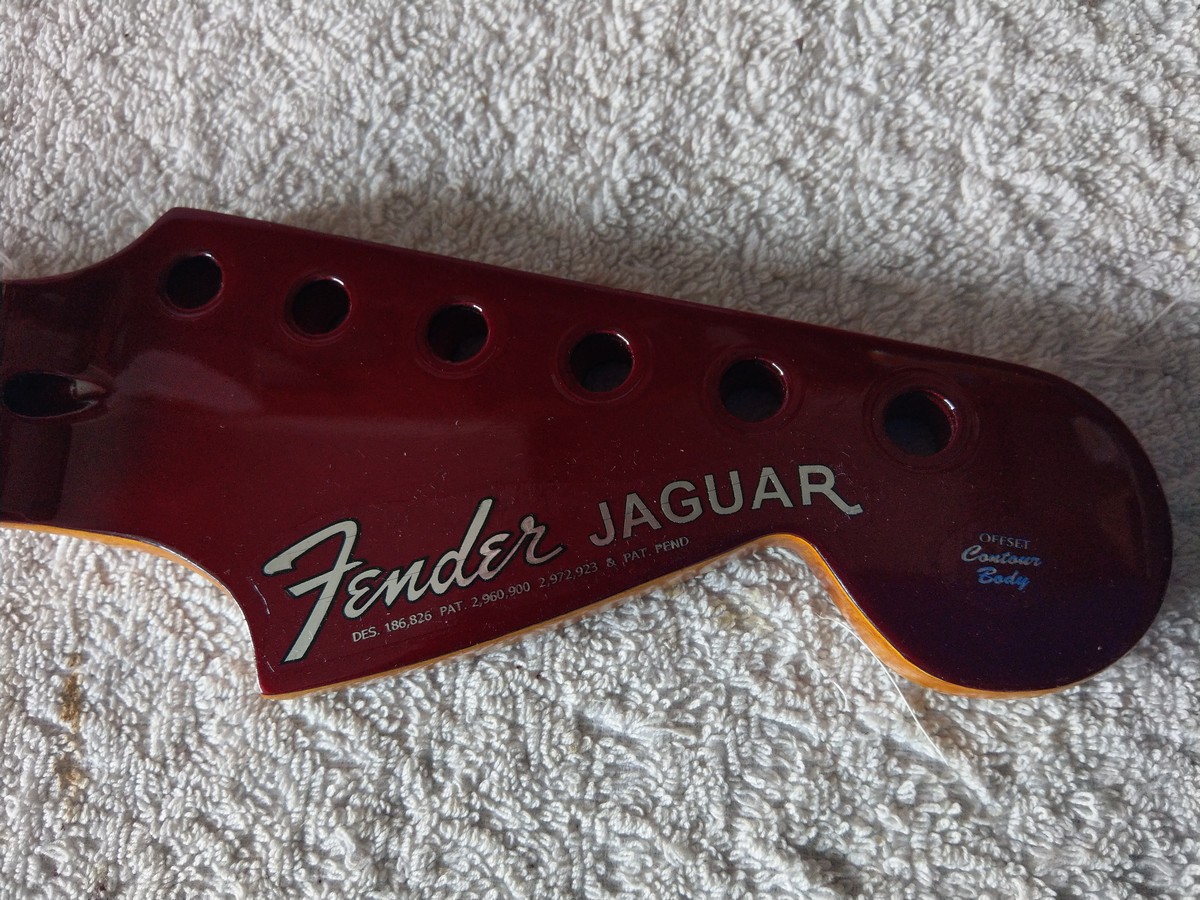

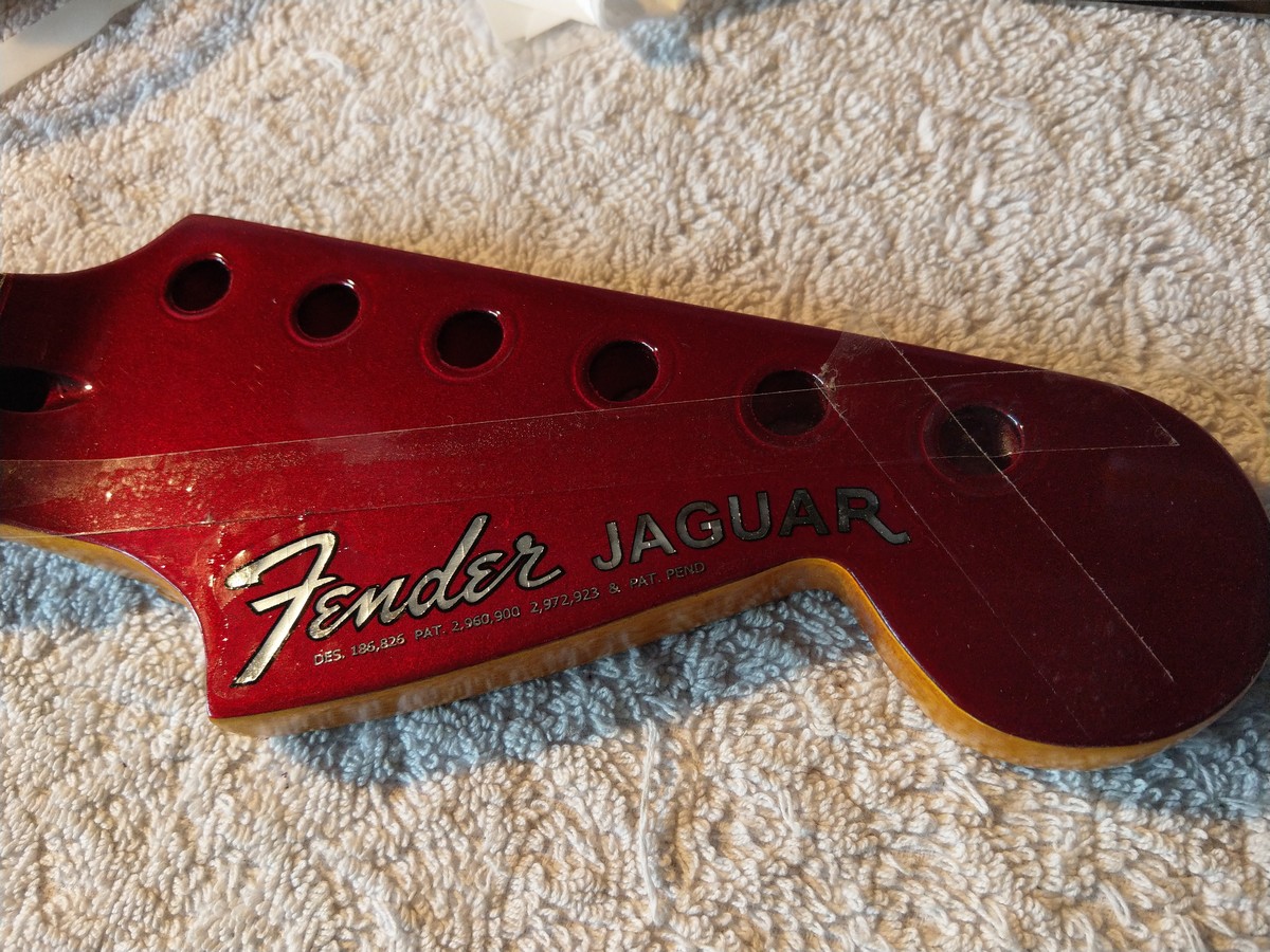

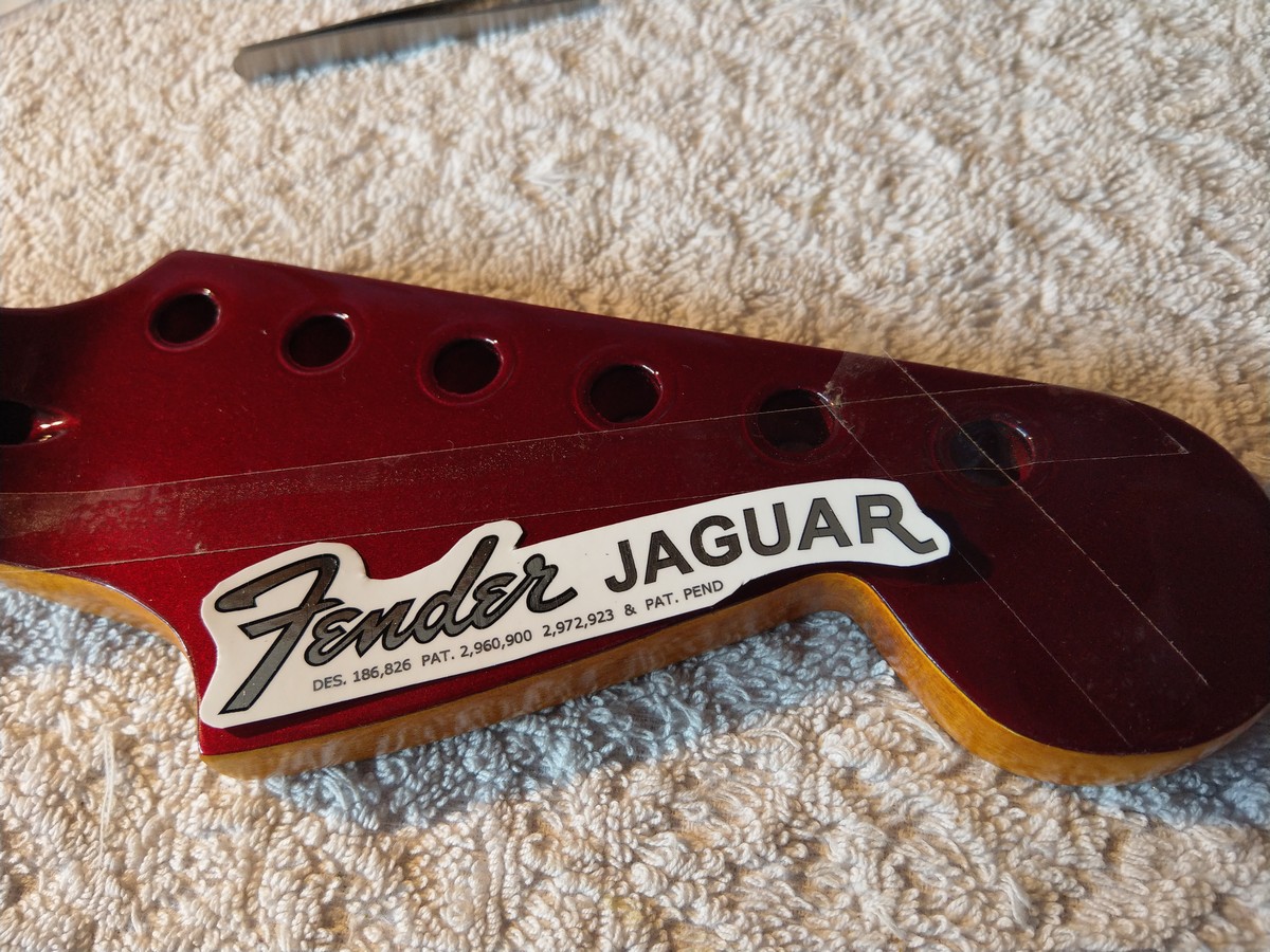

Headstock Decal arrived at last from the States.
Aslo ordered some Humbrol decalfix from Sydney, it arrived to.
Attachment 24451

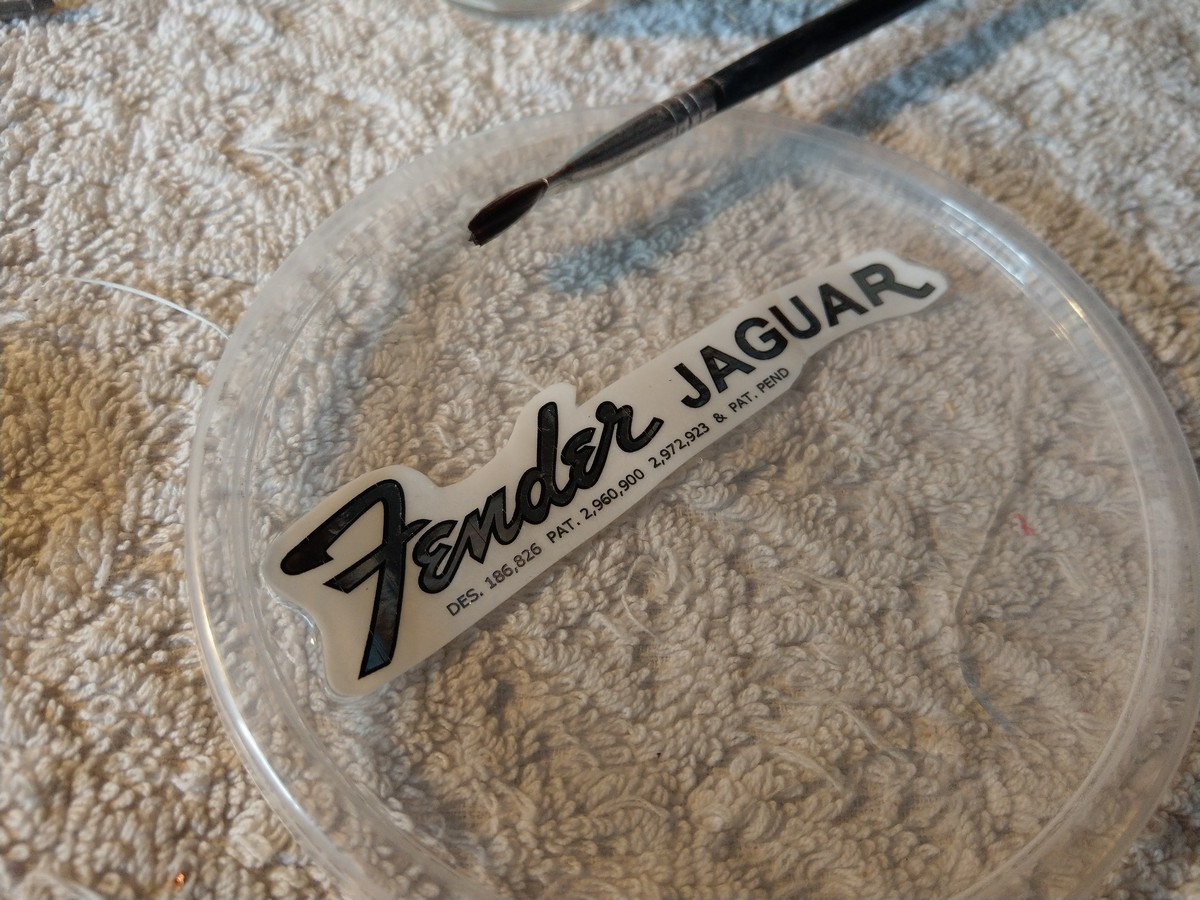

So the process is...... cut out with just a small amount of edging, soak in the humbrol mixture for 3-5 mins.
When loose, thoroughly wet the headstock surface with the Humbrol to help it slide.
Place in position ( i used clear masking tape to help with positioning) and gently slide off with a small soft brush.
After 15 mins gently wipe off excess liquid with a paper towel.
After 20-30 mins put the paper towel over the top and gently press down over all the surface to squeeze out bubbles and excess liquid and Bobs your uncle, ready for clear. The Humbrol helps the decal to meld to the headstock contours, like it was painted on.
Attachment 24452 Attachment 24453 Attachment 24454

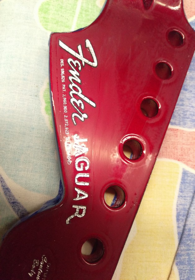

EDIT.. Ditching the official logo, and doing a custom one. My guru advised me..lol
Finished product with emphasis on REPLICA so i dont infringe on copyright. Will also put "M & M Customs" on back.
Attachment 24455 Attachment 24456

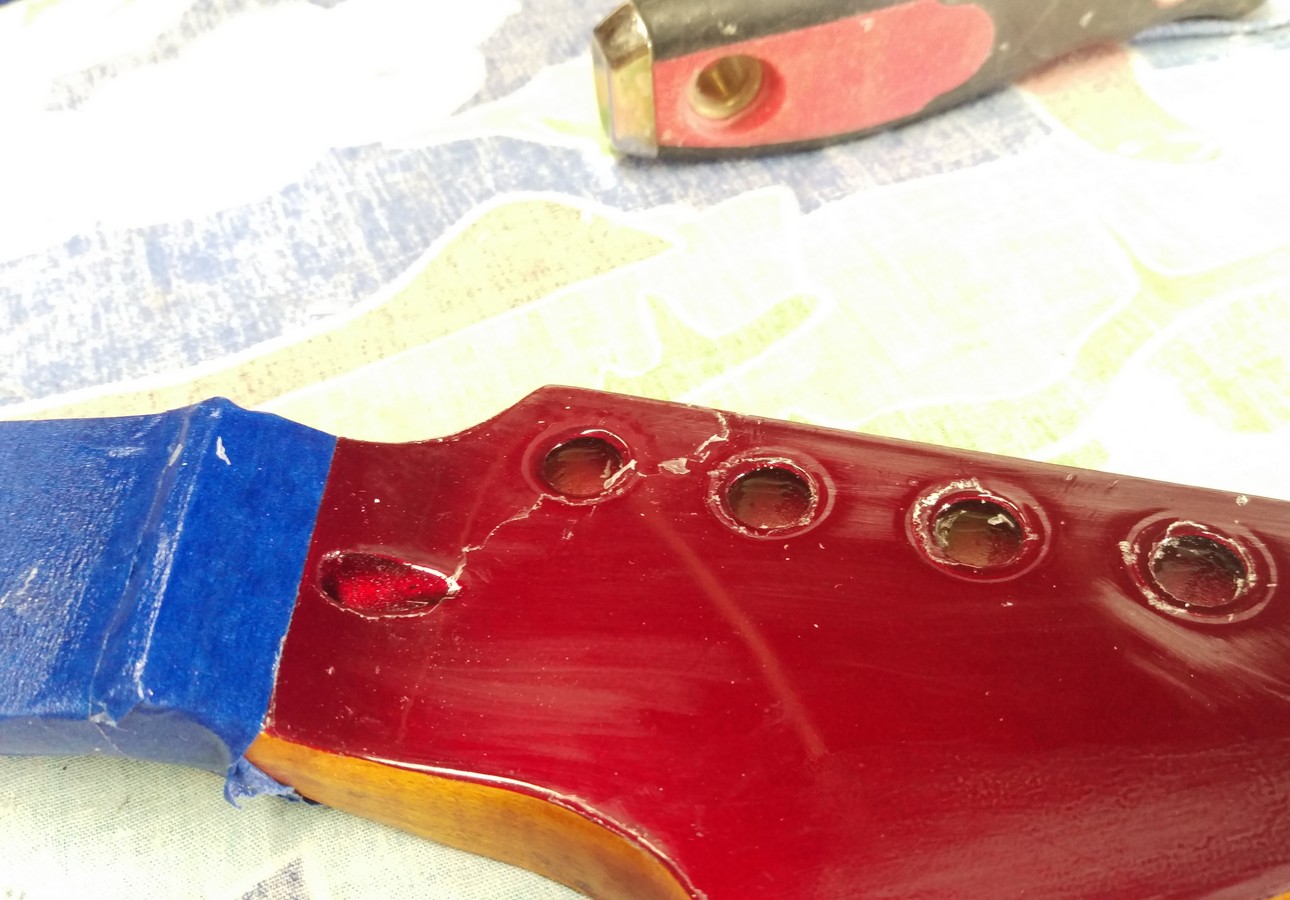

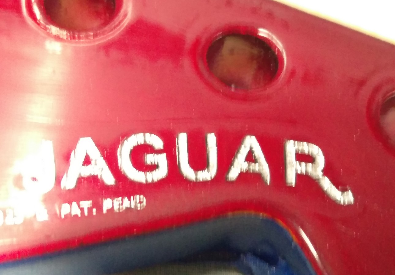

Trouble with the headstock decal. Its very fragile.
After applying, i sprayed it with 3 mist coats of clear then a heavy top coat. Apparently that wasnt enough, 10-15 fine mist coats are recommended so as the solvent wont affect it. Received 3 decals, 1 for practice, 2 is ruined, and one more to go. Fingers crossed.
I peeled it off before it had set really hard but scratched the paintwork in the process. Back to sanding, spray primer, body filler, base coat and red coat, decal the final clear, again...SIGH.
decal has cracked and crazed.

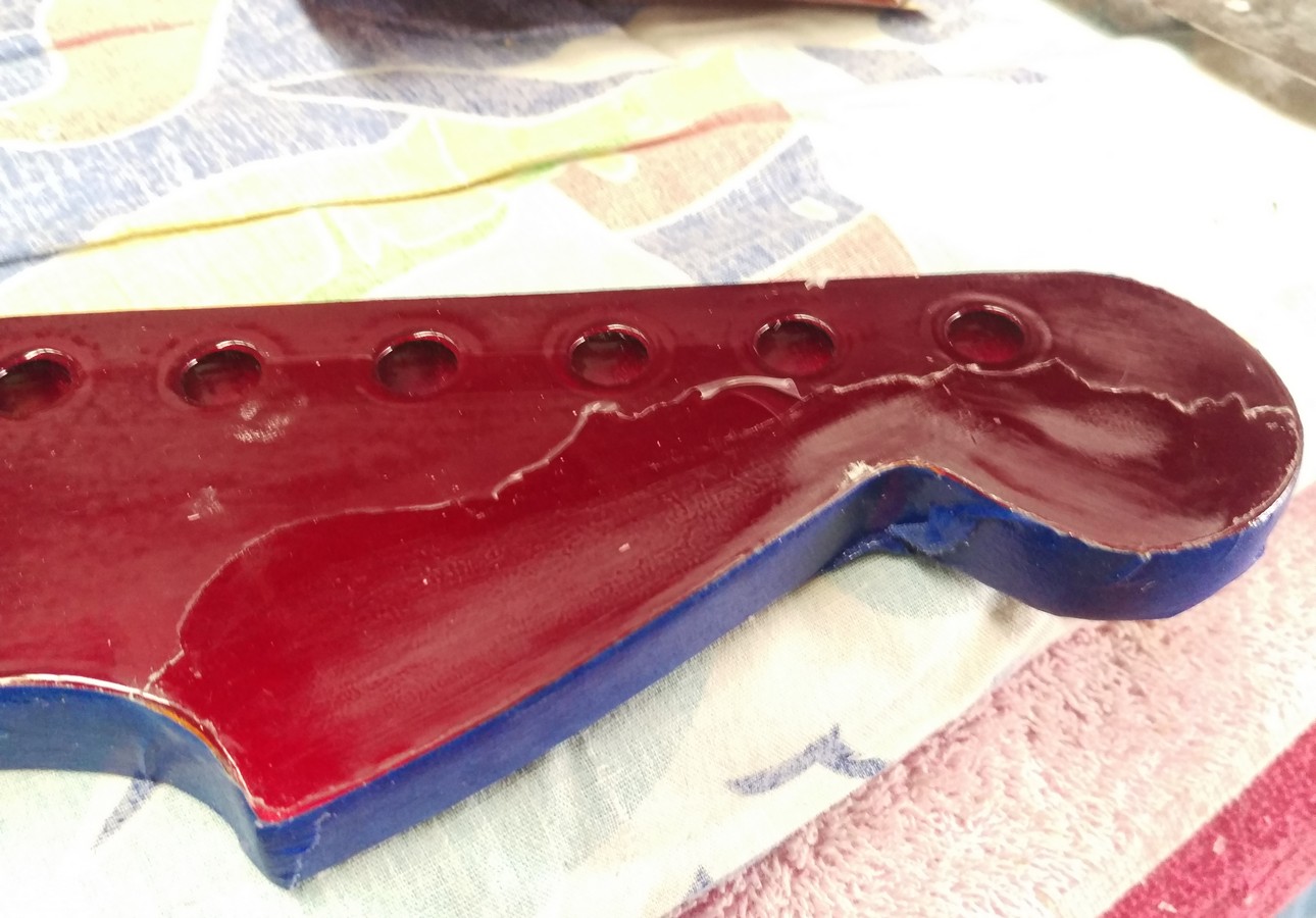

Attachment 24697 Attachment 24698 Attachment 24699
removing the clear
Attachment 24700Attachment 24701

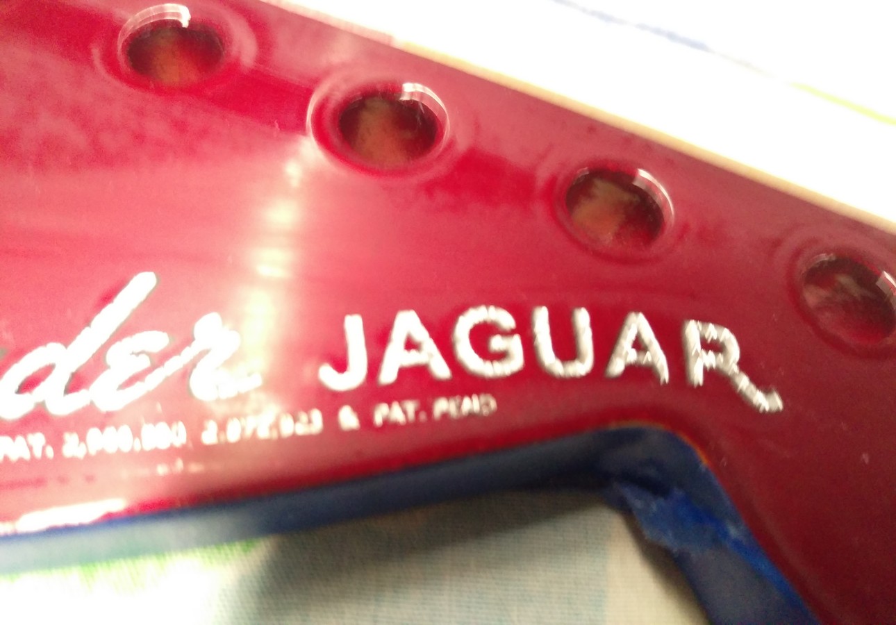

So its 4 days later and im at the last stage.2 coats of clear to seal it then decal time...
Clear is patchy until its dry, at the moment its still very wet.
Attachment 24702 Attachment 24703 Attachment 24704

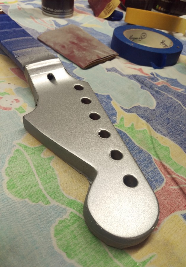

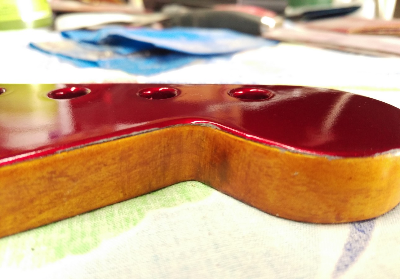

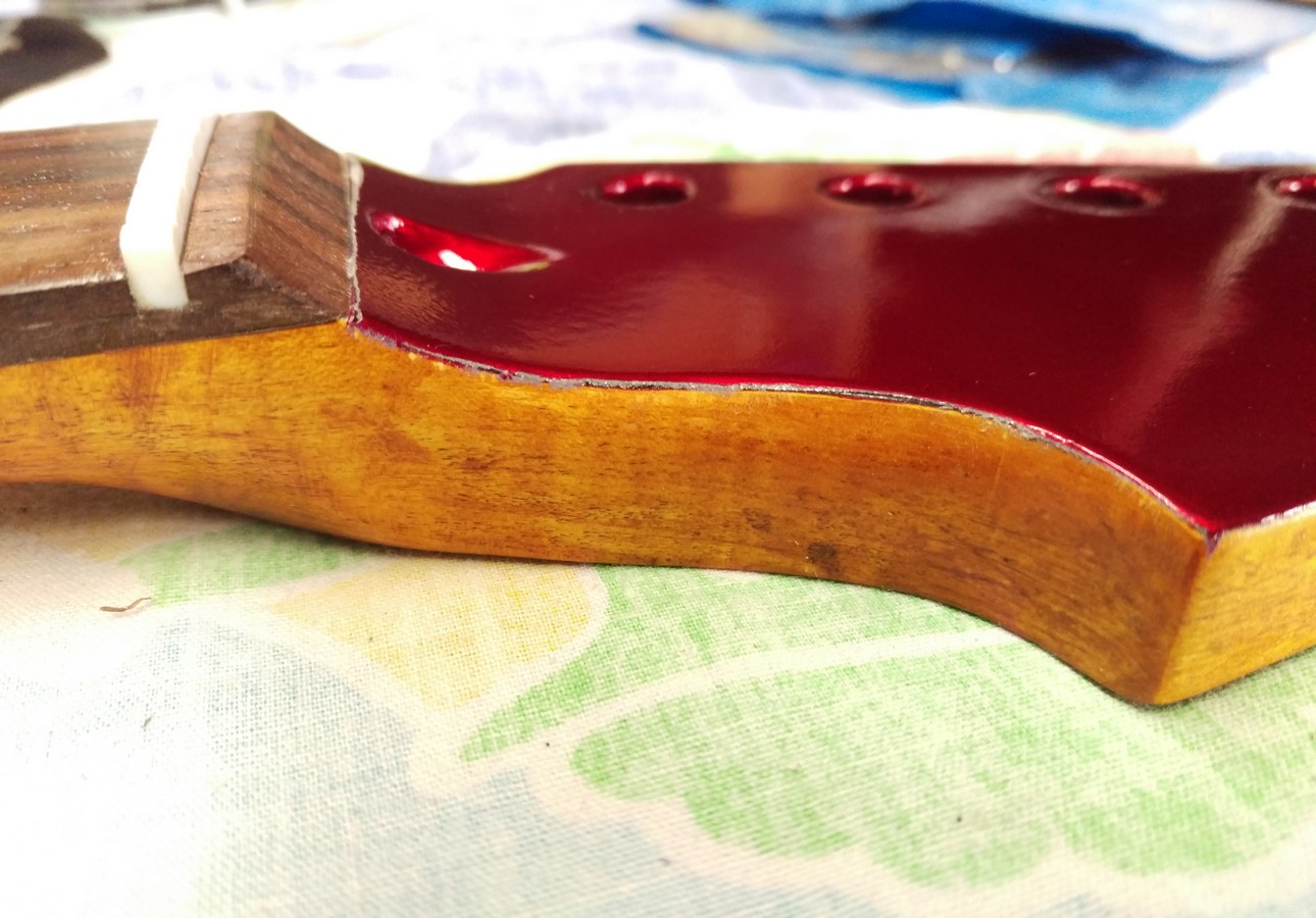

So after removing the tape from the headstock i could see the paint layers showing through. TOO MANY COATS!
Attachment 24786 Attachment 24787 Attachment 24788
The edges were smudged and i could see where the silver basecoat was showing through. You can actualyy see the bottom layer of red, then the grey primer, then the silver basecoat then the clear red overlay. With just a solid colour you would not have these problems.

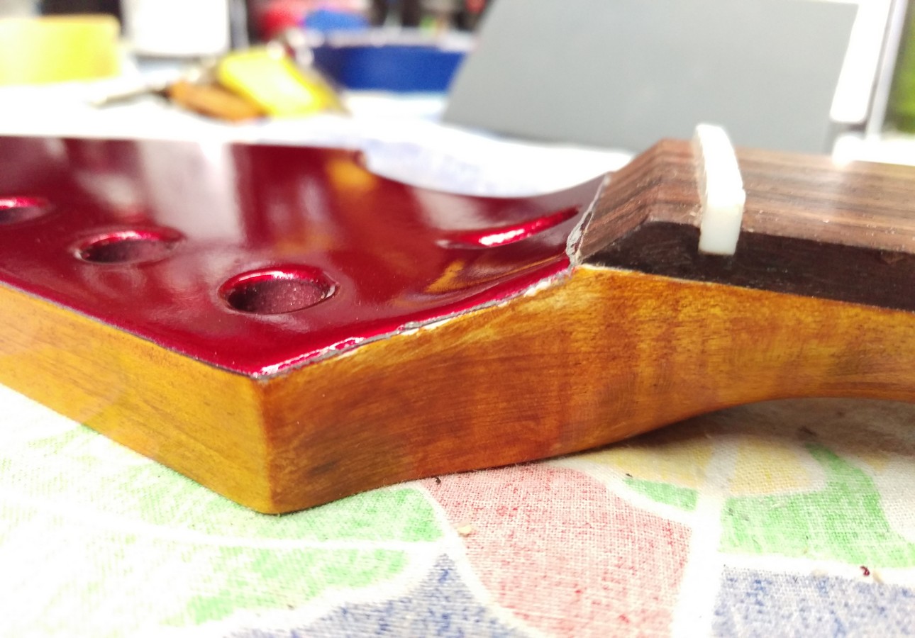

This is the mess too many coats makes of the headstock, fretboard join..
Attachment 24794
YUKK.
so the sad conclusion, remove and start again.
