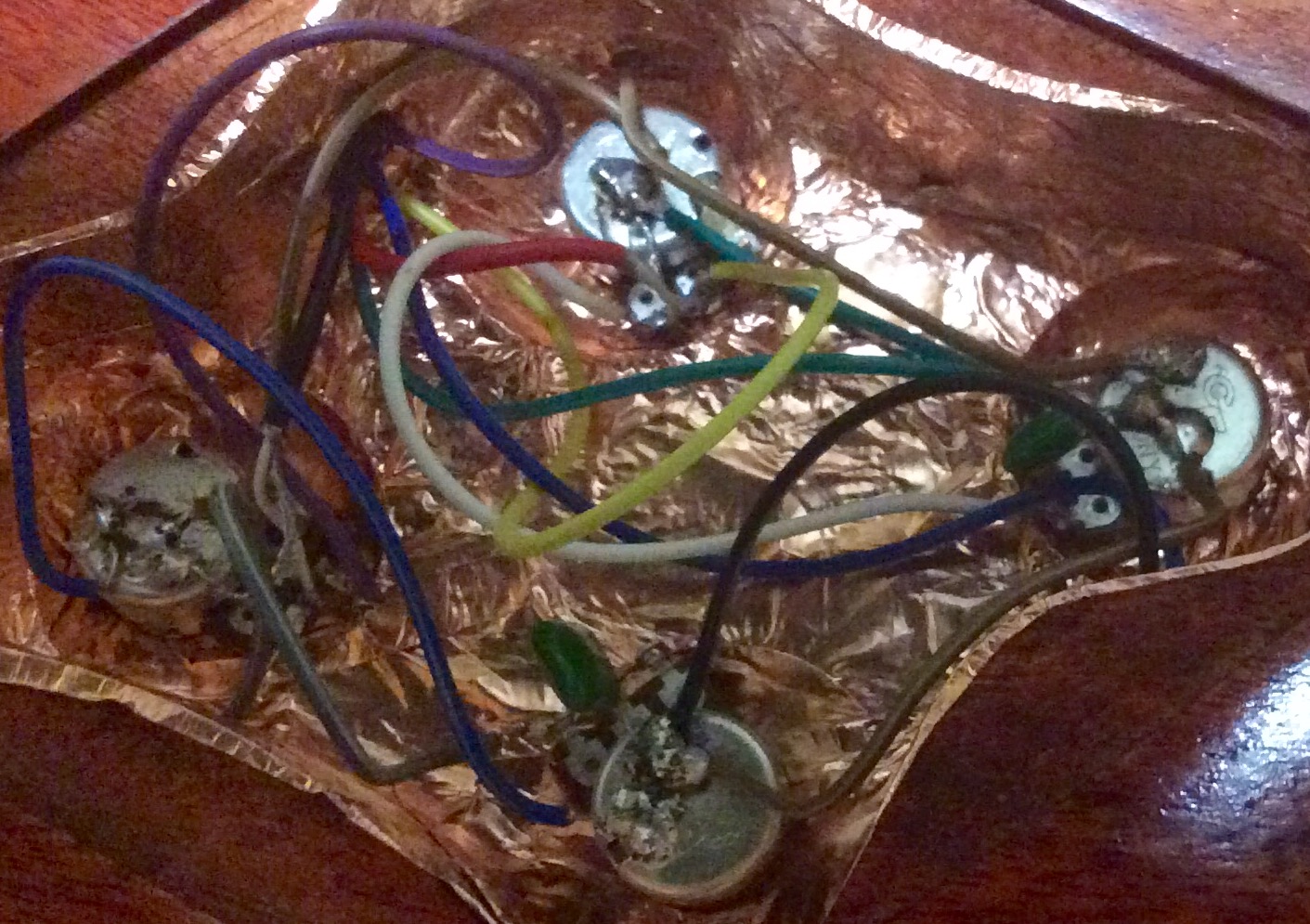

Wokkaboy / Weirdbits, am I hearing it right that pot lugs aren,t supposed to touch the copper shielding ?
Printable View
Attachment 10868
yes Hugh, if any pot lugs touch the copper shielding they will be earthed and short any signal.
put a screwdriver underneath the lugs and carefully bend them away from the copper
You can also put some electrical tape under the lugs to insulate them from the copper shielding.
Which lugs are the pickup white core wires connected to on each volume pot, the middle or the left? It's a little hard to see in the image.
The left Weirdbits

I did have to break some of the copper shielding tape to make sure it was right into the corners around the pots so it wasn't contacting any lugs. I don't know if that's enough to create feedback one noise??
I might try to reseal the copper lining tomorrow and then insulate the lugs with electrical tape as Weirdbits suggested..

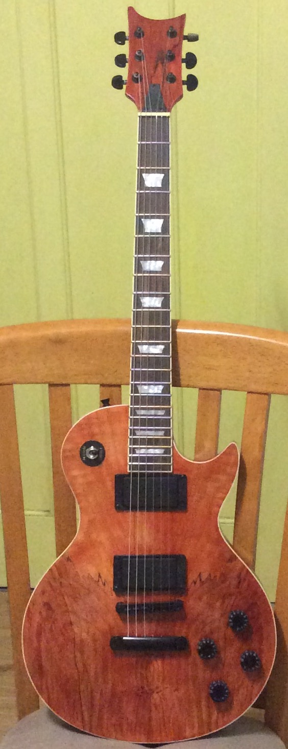

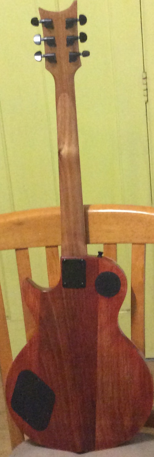

Attachment 10886Attachment 10888
Ok.. So it's not going to win Guitar of the month, it hasn't quite got the finish or depth of colour I thought it would have in the end ...but it's finally altogether in one piece and it PLAYS!
There is still a problem with feedback or interference of some sort and the neck pickup doesn't seem to have much oomf, but it's up and running! Hallelujah!!
Sorry the pics are so bad but I Had trouble getting them small enough to upload.. Will endeavour to get clearer shots up soon.
Still need to set the intonation and adjust the truss rod, yet.
well done Hugh I think it's a great looking build don't be so hard on yourself
few tweaks and it will be a cool axe
I'd enter it into GOTM you have a couple of days
not sure what's causing the feedback issues, try a different location from the amp and point the guitar in another direction. Should have nothing to do with shielding
