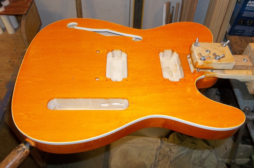

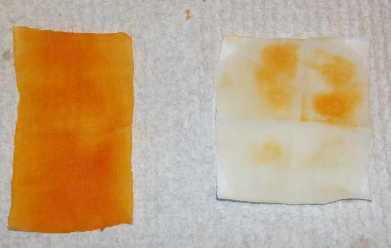

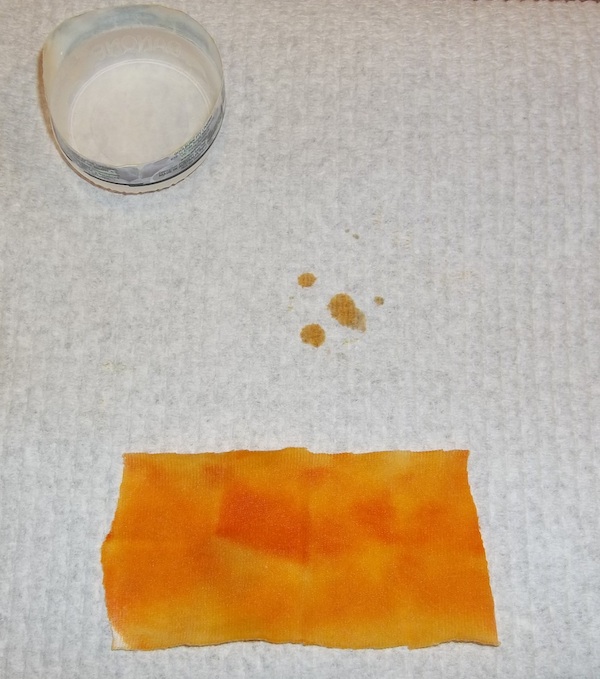

The beta orange was proving to be very volatile even after plenty of drying time. It seemed to re-activate when applying my top coats and quickly stained my cloth.
Attachment 17715

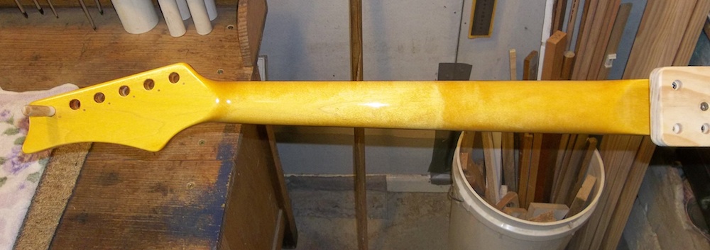

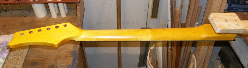

First coat of early Mk.1 neck top coat applied.
Attachment 17716

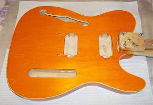

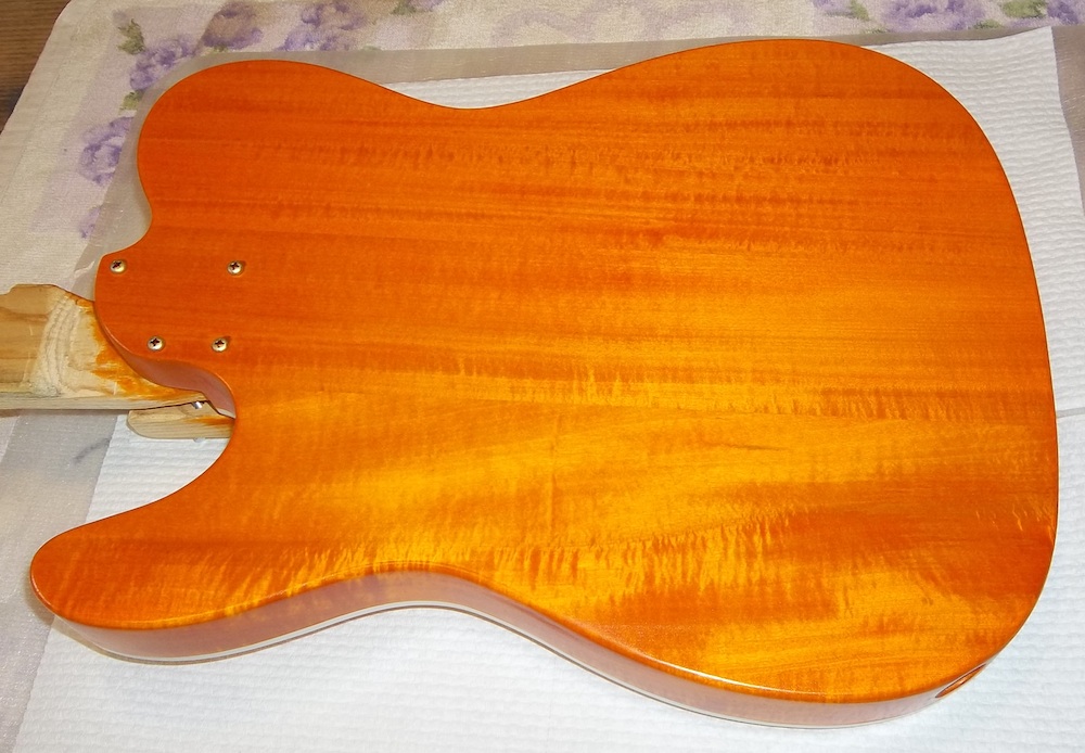

The beta top coats were looking good, but patchy.
Attachment 17717
Attachment 17718
Attachment 17719
Attachment 17720

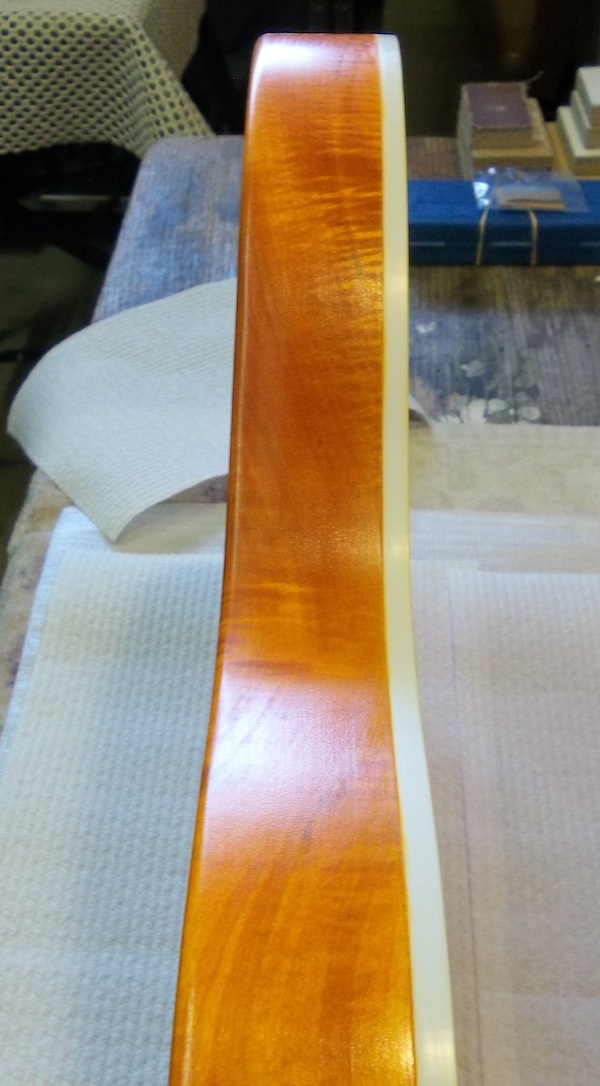

You can see the binding was taking on colour again from applying the clear top coat.
Third top coat dry, looking good and the patchiness is slowly improving.
Attachment 17721
Attachment 17722
Binding scraped, yet again, ready for 4th top coat.
Attachment 17723

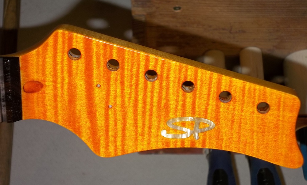

Fourth neck top coat.
Attachment 17724

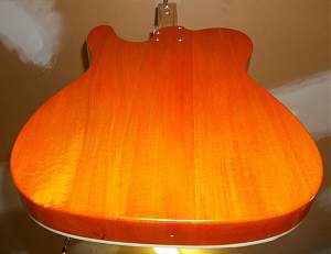

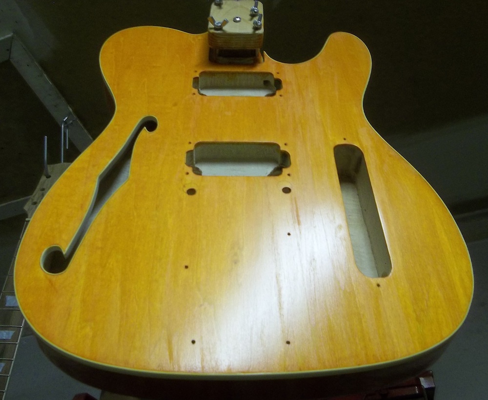

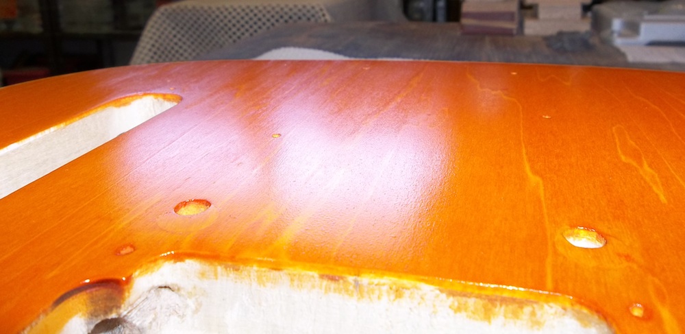

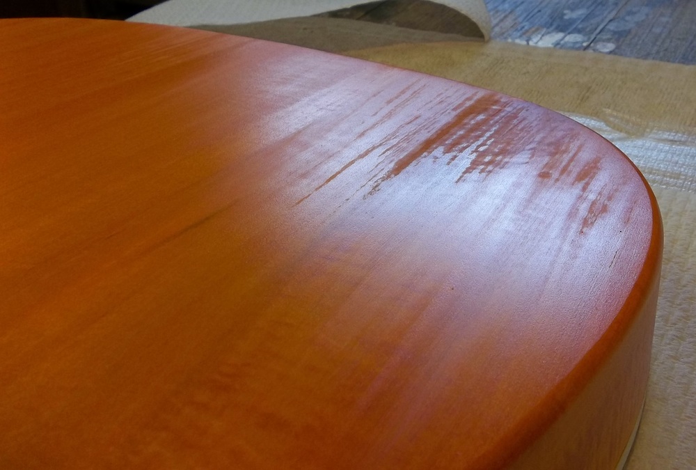

It was going on well and looking pretty good. But, then we had a couple of days of higher humidity and the finish took a turn. Coat #4 went from smooth and nice to coarse, rough and lumpy over a couple of days.
Attachment 17727
Attachment 17728
(second image is without flash to get the contrast to show how rough it was)

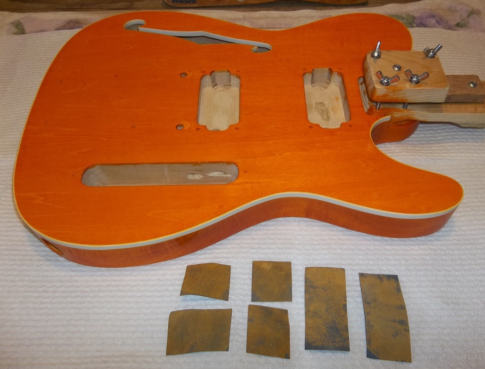

I couldn't risk wet sanding with water to clean up the roughness, not enough protection for the wood. And, with the volatility of the orange I couldn't risk using a solvent to sand, so I had to go with dry 1200 wet'n'dry. I just wanted to smooth out the finish without taking off any more of the top coat (or orange) than necessary… but the paper was still stained very orange. With time and caution it was eventually smooth again.
Attachment 17729
But it meant more orange moving around with the next top coat.
Attachment 17730

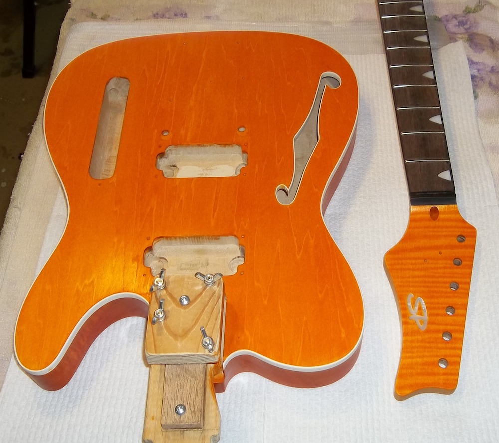

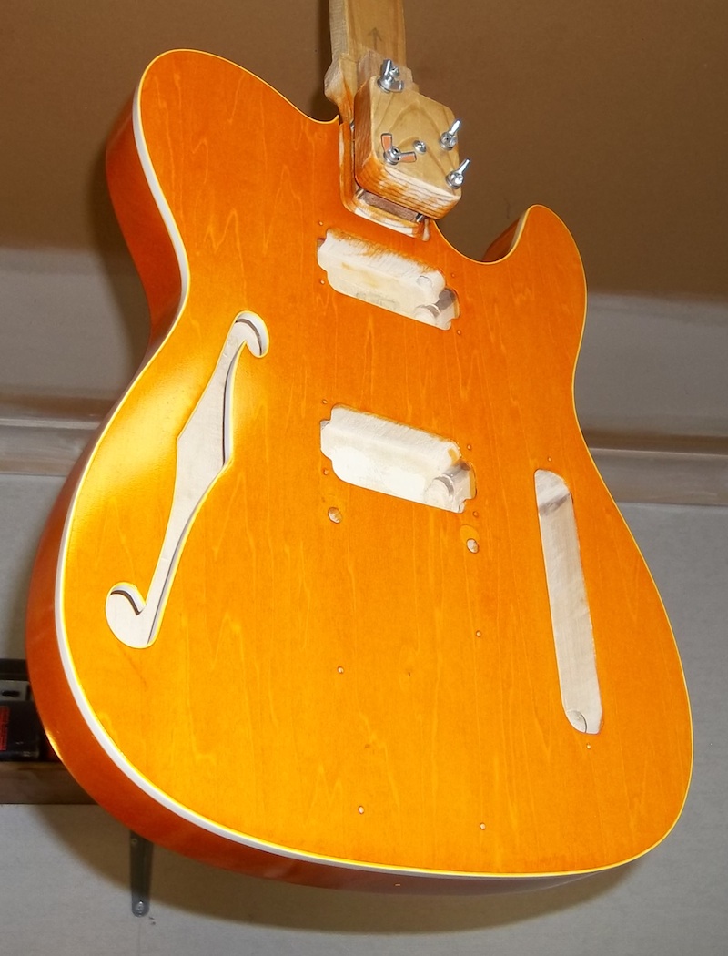

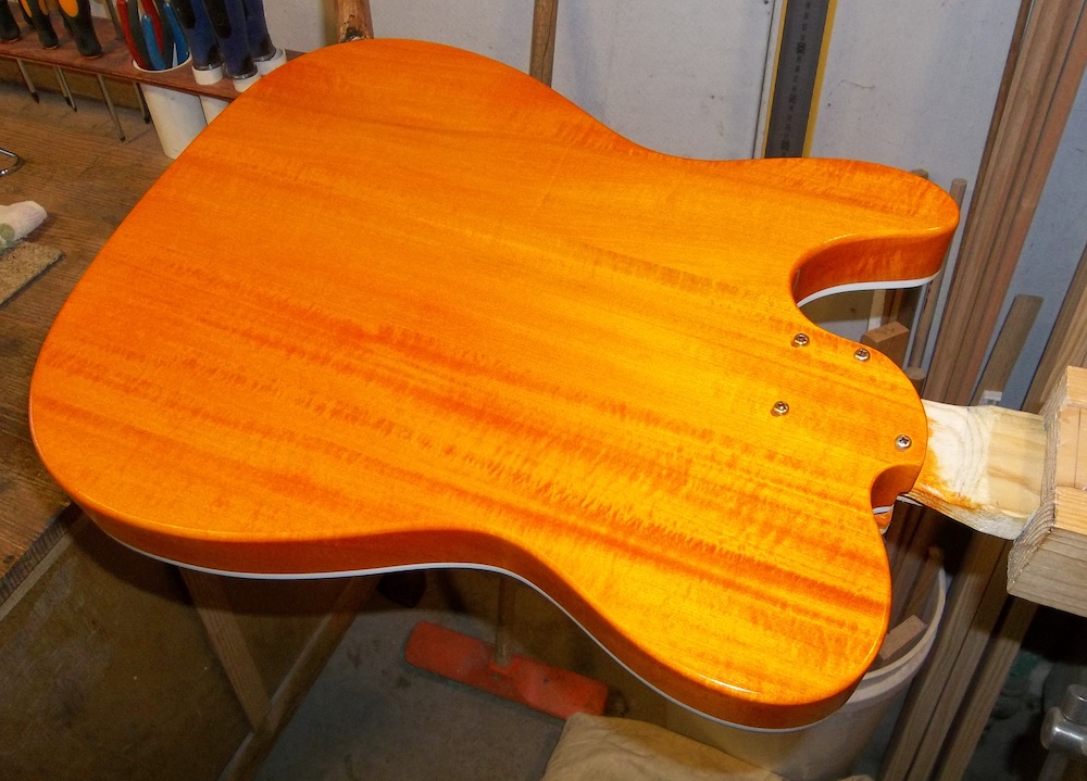

Fifth top coat, or replacement of #4 really. Back to a nice smooth finish.
Attachment 17731
Attachment 17732

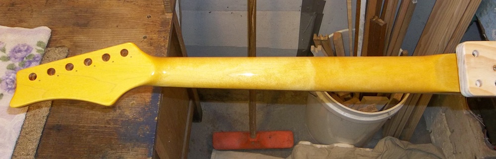

Neck was still doing ok.
Attachment 17733

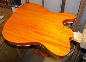

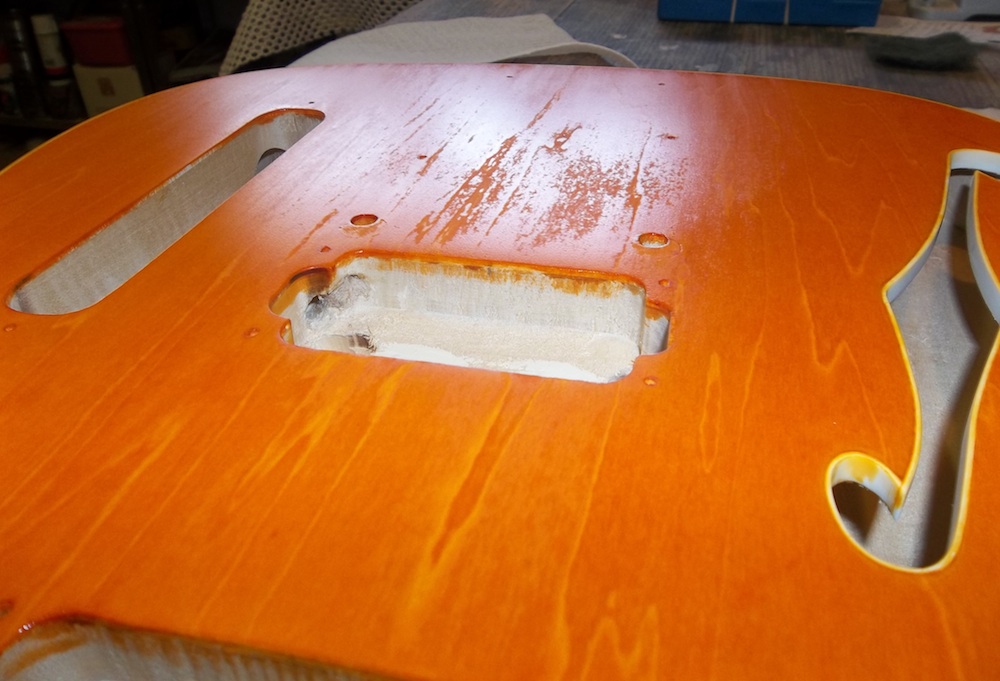

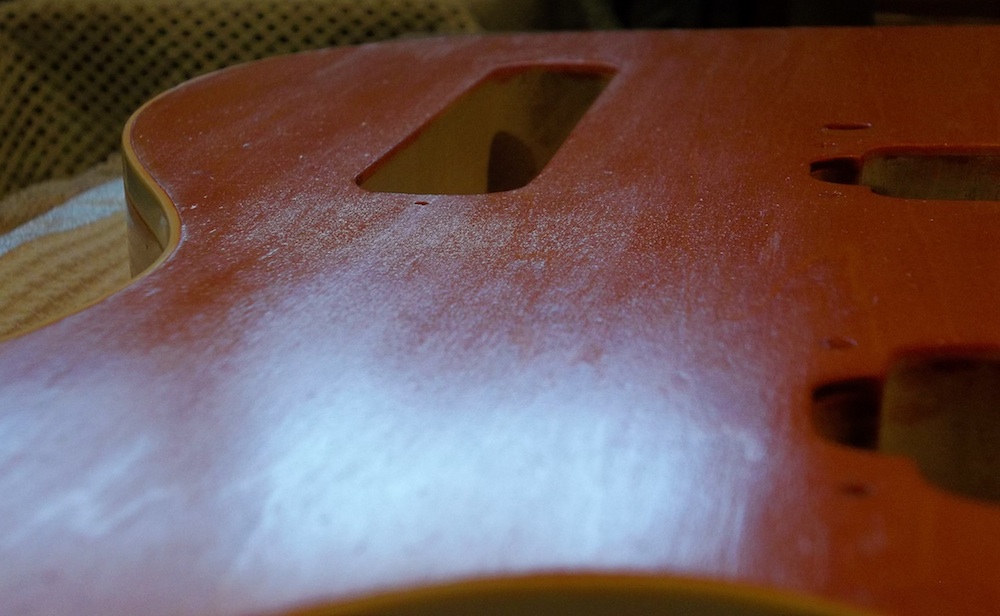

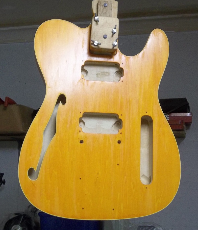

Although the body was mostly smooth again with the 5th top coat, the patchiness was still occurring. Hard to photograph clearly, so I took some shots without the flash. You can just see the patchy/streaky sections scattered across the body, and it was pretty much the same on the headstock face.
Attachment 17734
Attachment 17735

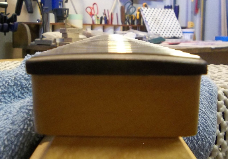

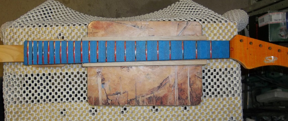

While working on my YB-4 build I had a look at the TL-1TB's neck, and sighting down it something didn't look right. I was worried that it may have warped a bit while it had been hanging, but it looked more like a couple of frets may have just lifted slightly from all the temp and humidity changes over the long years of neglect. It was time it had some attention.
I re-pressed the frets to sort out any raised ones and gave it a light level to get it back where it should be. Black marker is a high spot, red everywhere else.
Attachment 17736

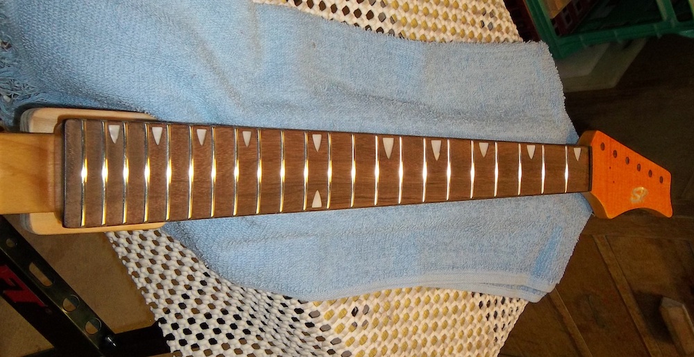

Re-crowned, cleaned-up and polished.
Attachment 17737
Attachment 17738

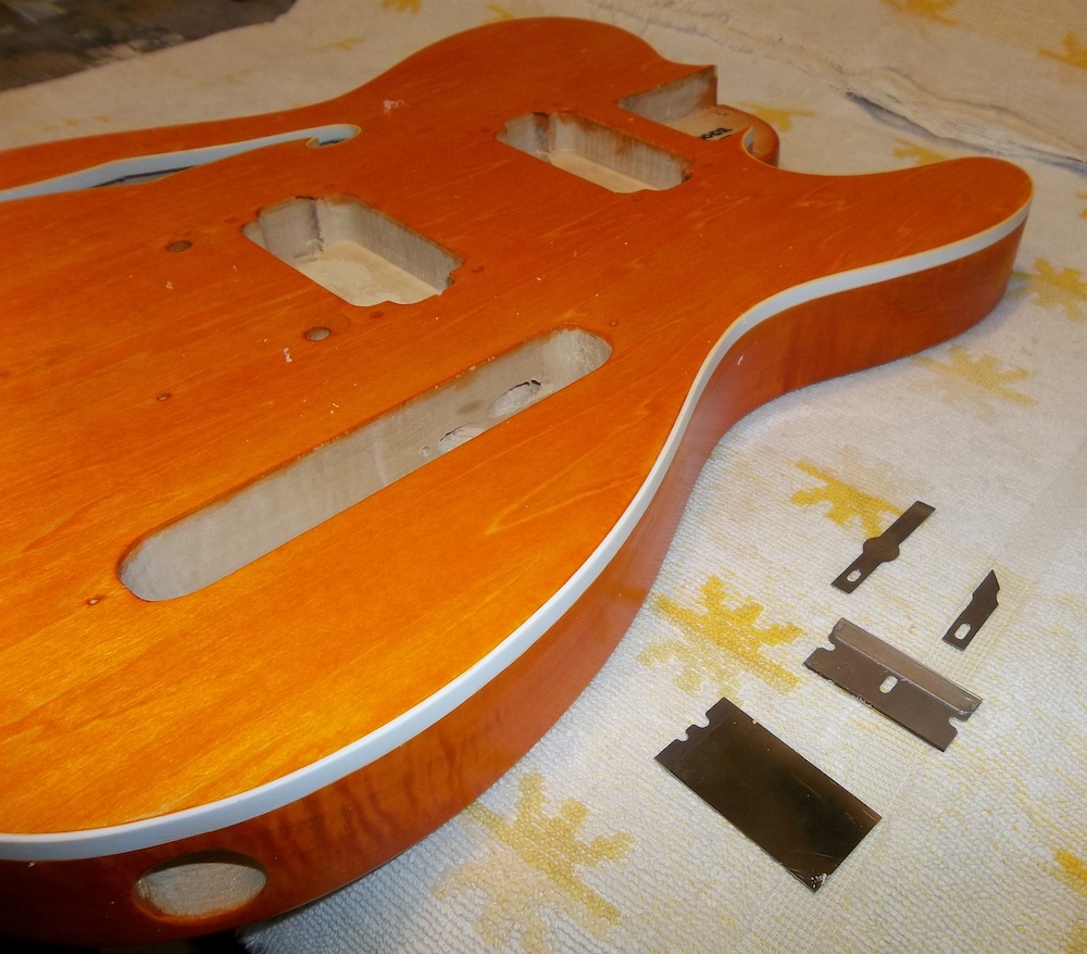

The binding was still stained from the last top coat application two years ago, so to start fresh I scraped the binding yet again (probably for the 7th time, or more, time).
Attachment 17739
