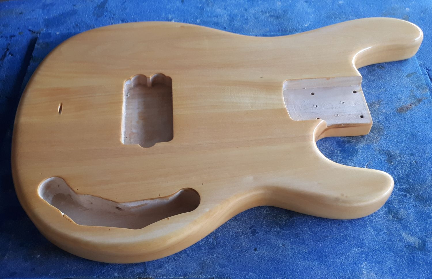

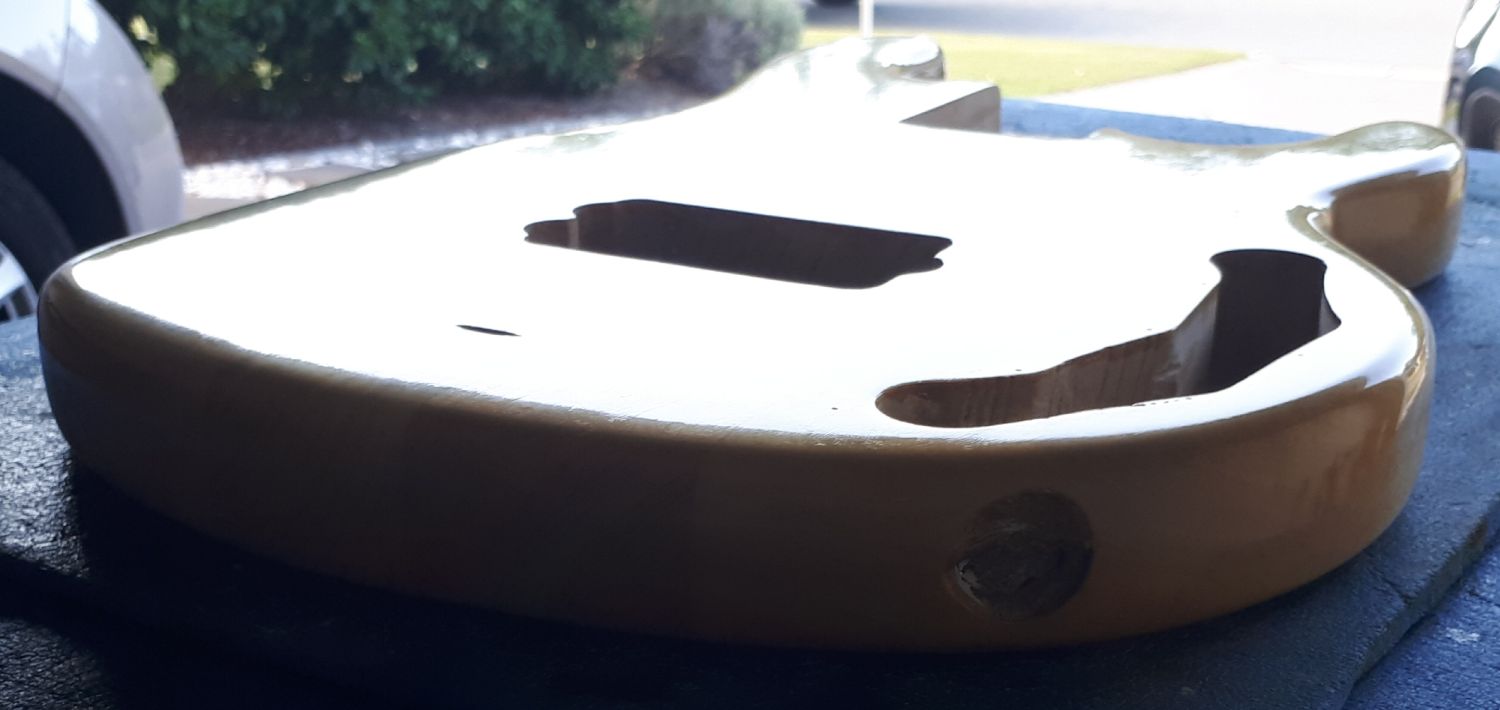

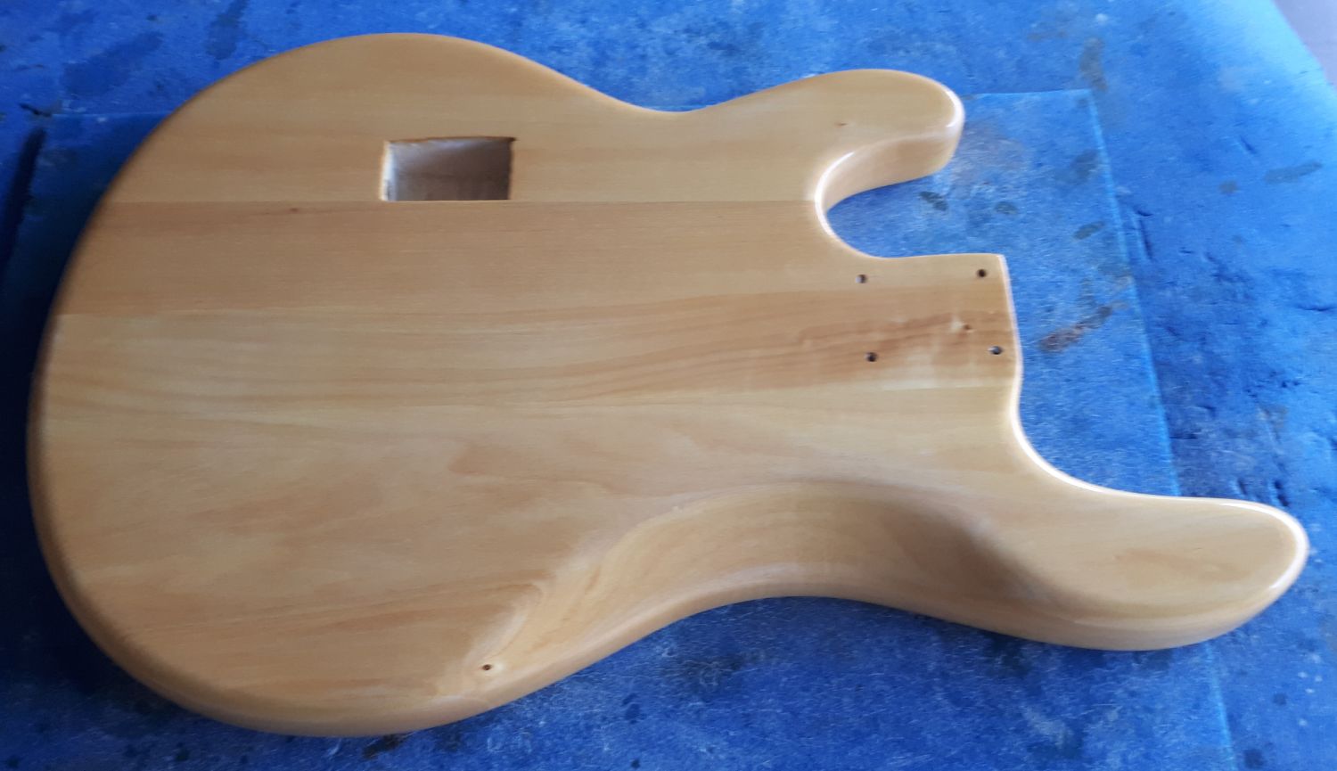

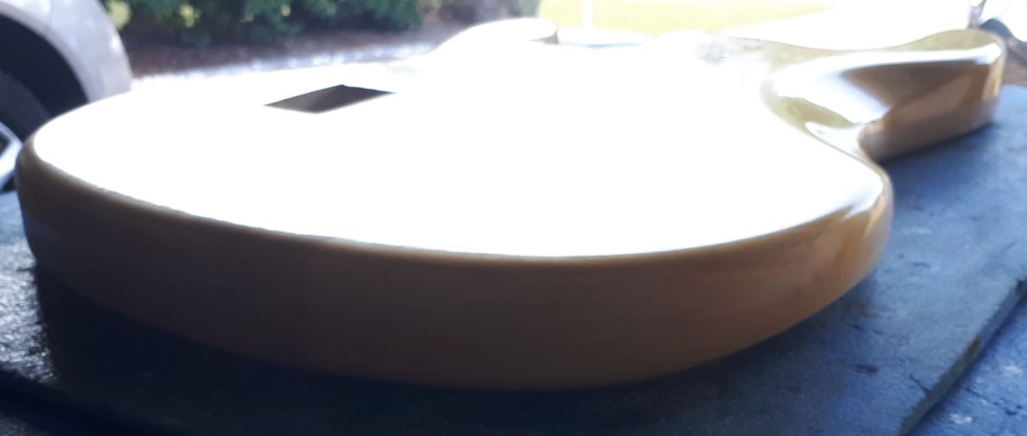

Did 1500 W & D on neck last night and 1200 W & D on body. Another 50:50 ragged coat on both tonight and starting to look almost done. Maybe one more week of 2 coats ragged x 1 wet sand repeating as I work my way up to 2000 grit. Thankfully weather hasn't been too hot or humid and each layer has gone on just fine.
I think the finish may have had enough time to cure????
Didn't realise I hadn't touched this build for best part of 5 months and found a few spare hours to work on it earlier today. Very light 2000 W&D wet sanding followed by light micro mesh pads, Meguiars, Brasso, and Nu Finish as each of those three polishes does something just a little bit different to one another....
Attachment 24731Attachment 24732Attachment 24733Attachment 24734
