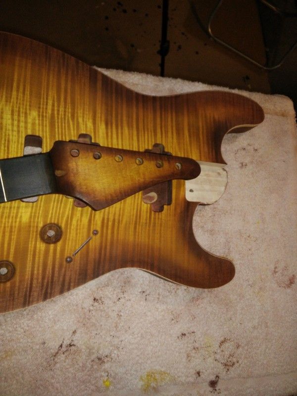

It does extend to the neck just below the first fret. The more I look at it the more I feel like just making it entirely brown behind. Maybe I'll test fit some hardware first.

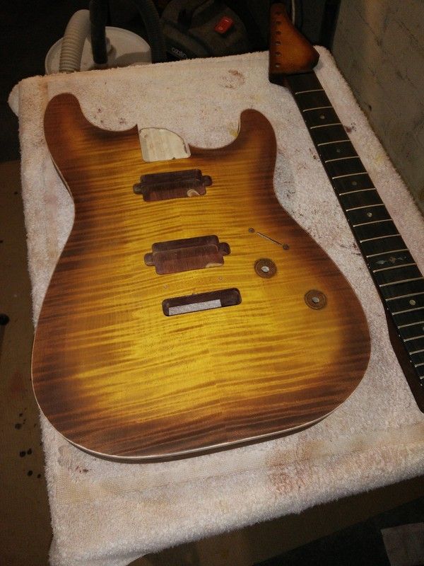

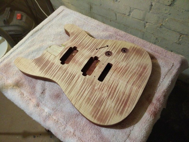

Finally gotten down to dyeing the body. I first sprayed 2 coats of lacquer to seal the faux binding, then grain filled, then sprayed another 2 sealer coats over the faux binding. I'm not sure if the first 2 sealer coats were necessary in hindsight because when sanding off the timbermate grain filler I took off a bit of the sealer. But then again I didn't want the faux binding to be stained by the grain filler so I didn't take any chances. Sealing the faux binding, however, was necessary to prevent any dye from colouring it.
I decided to pop the amazing figure with some brown dye.
http://i23.photobucket.com/albums/b3...psqezctvcr.jpg
Then sanded back till my arms and thumbs were sore.
http://i23.photobucket.com/albums/b3...psuvvzcnaq.jpg

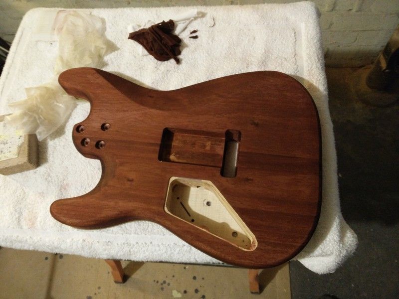

And also dyed the mahogany brown.
http://i23.photobucket.com/albums/b3...pst5scowe9.jpg

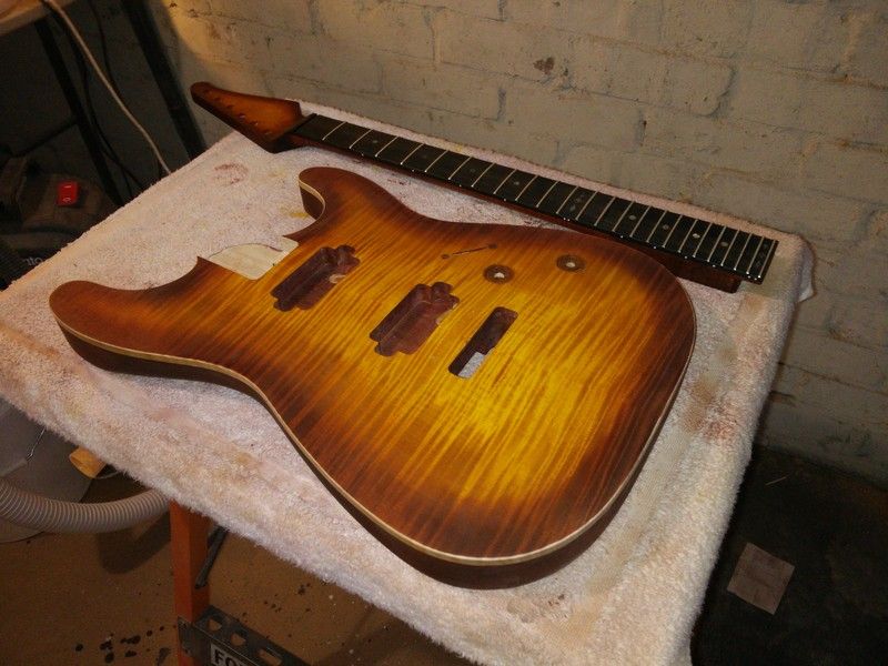

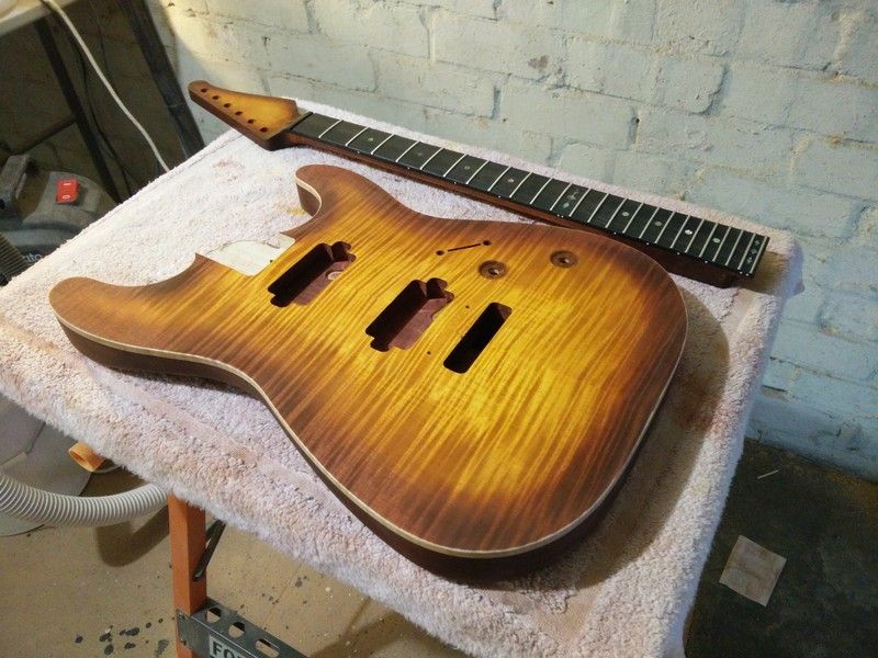

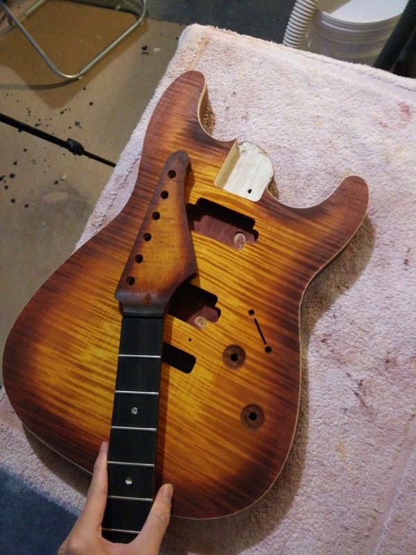

Then I put some yellow over the top and did a brown burst. I filmed the entire process and I'll post the video once it's done. However the top horns didn't receive the dye as well as the others so I couldn't get it very dark. I ended up sanding back the whole thing the next day after drying and tried again.
Picture without flash:
http://i23.photobucket.com/albums/b3...psroqsqxah.jpg

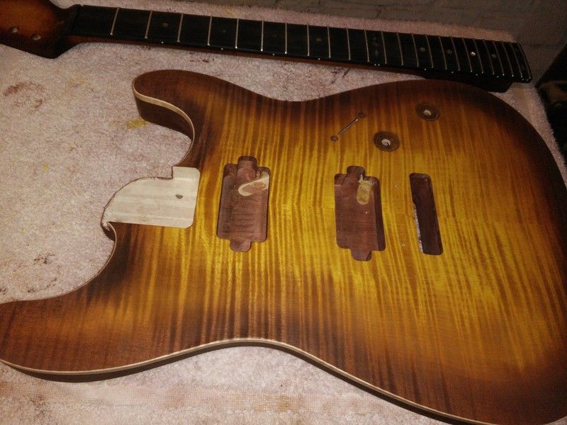

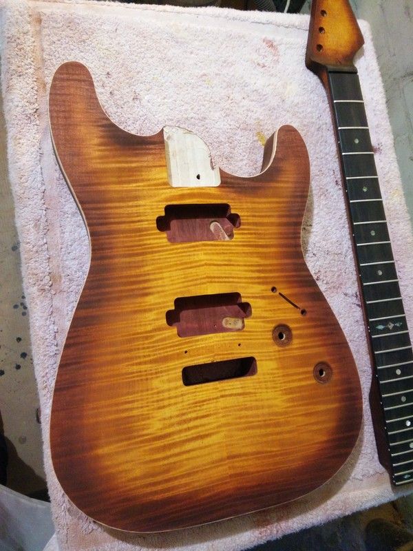

With flash:
http://i23.photobucket.com/albums/b3...pswtjgdx87.jpg
http://i23.photobucket.com/albums/b3...psqymquesi.jpg
http://i23.photobucket.com/albums/b3...pskp9nwlwb.jpg
http://i23.photobucket.com/albums/b3...psxnuwqa6c.jpg

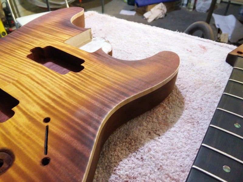

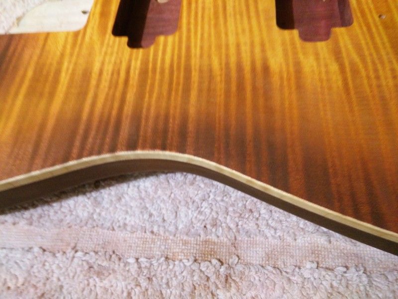

To do the faux binding, I sanded and scraped the edges to get it round over. The sealer coats helped prevent any dye from getting on to it.
http://i23.photobucket.com/albums/b3...psb9bl9qwp.jpg
http://i23.photobucket.com/albums/b3...psr17batd0.jpg
The headstock burst looks a bit darker compared to the body, but I can't get the body to get any darker so i may have to lightly sand the headstock.
http://i23.photobucket.com/albums/b3...psn4e70unb.jpg
http://i23.photobucket.com/albums/b3...pseridtudd.jpg

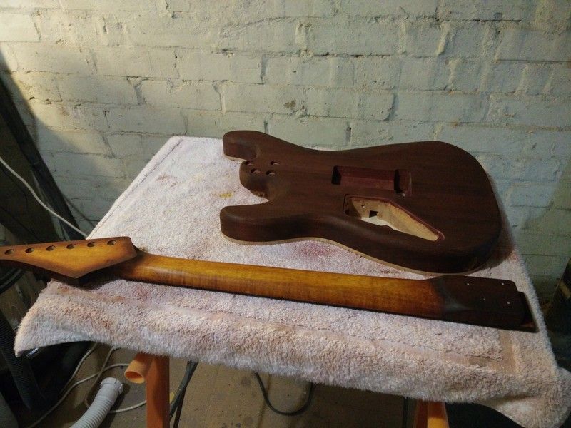

The colour on the back of the body and neck seem to match pretty well so I'll leave them alone.
http://i23.photobucket.com/albums/b3...psngza3iru.jpg
Excelling yourself again Si. Are you sure its just not an illusion of the headstock being darker as it's right next to that ebony fretboard? I look at the burst around the upper bout and the upper cutaway and it looks very close?
Yeah bro, it all depends on the strength and angle of light in the shots i guess. Great work though man, that is going to come up a treat with a high gloss finish on it. Totally jealous here.
