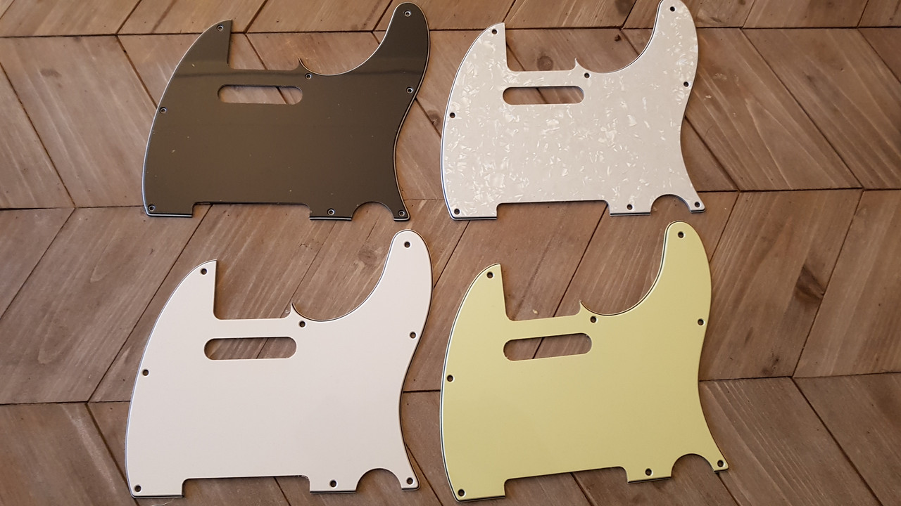

Four 3 ply pick guards from Vanson Guitars (ebay UK). Now with added GST since 1/7/2018 :(
https://s19.postimg.cc/u90ssvvqr/20180716_194853.jpg
Do you have to buy all 4?

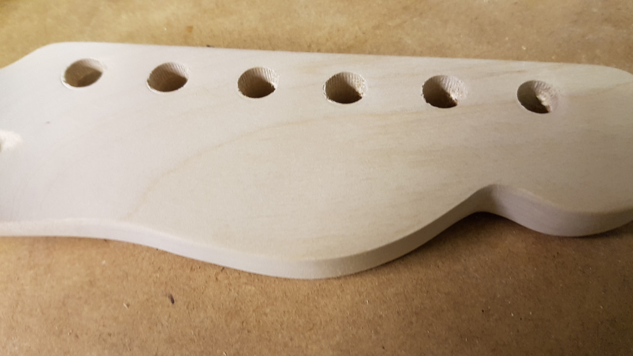

After doing a test run on my practice head stock, I decided to make the lower edge of the real head stock sharper:

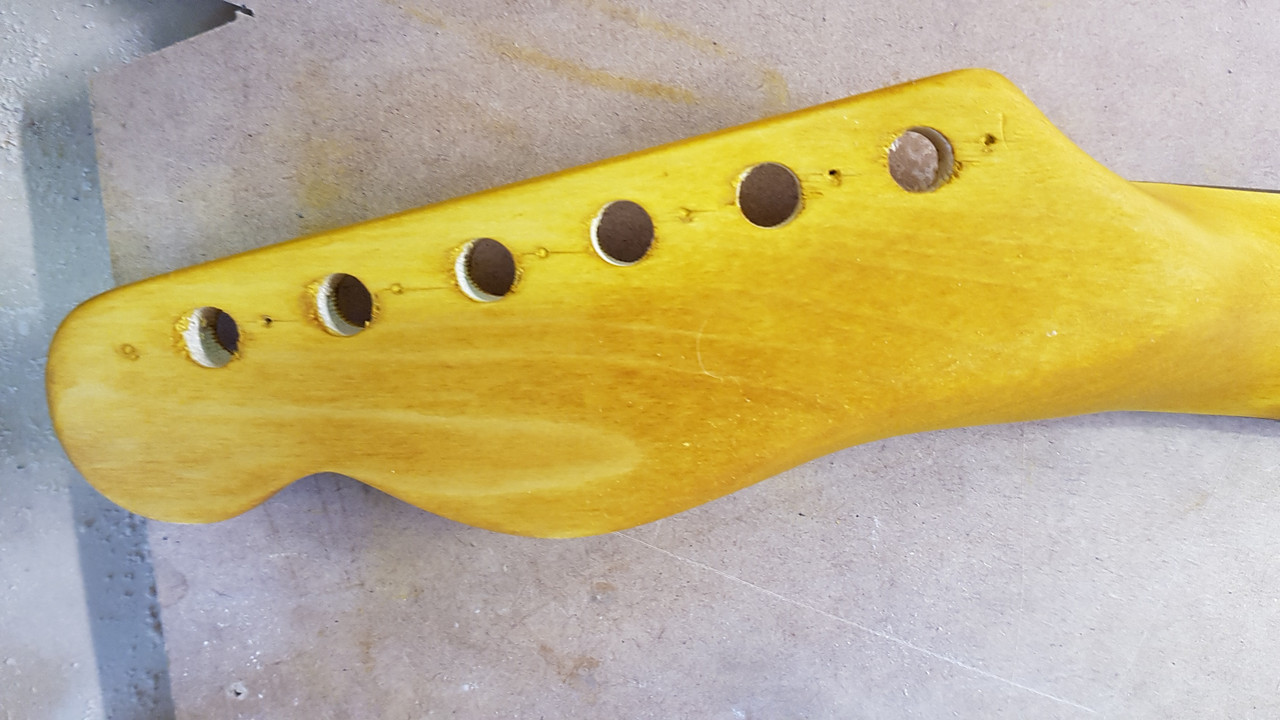

Tomorrow I will be staining the neck. Not exactly sure how much to dilute this stuff though, seems just a little too dark at full strength:https://s19.postimg.cc/4qdicy87n/20180717_194520.jpg
LOLOLOLOL! Carbatec strikes again!

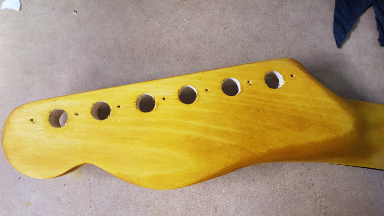

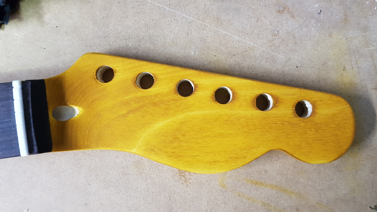

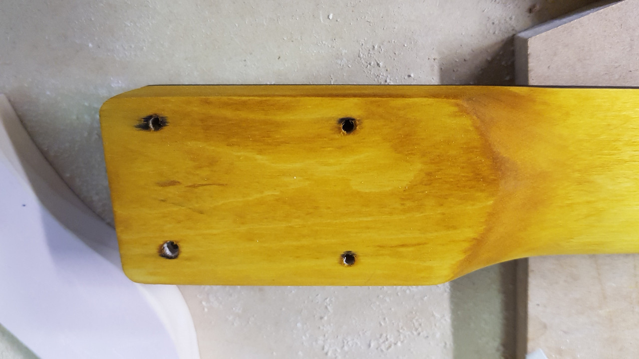

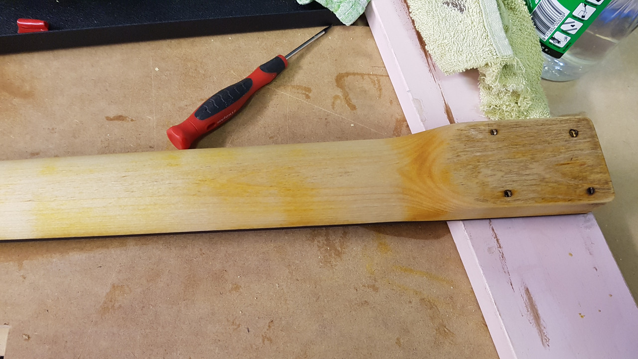

The first attempt at staining the neck, I mixed metho 25ml to 75ml golden teak. The pic doesn't really show how dark it turned out, but I wasn't happy with it.
https://s19.postimg.cc/3mknt12n7/20180718_144747.jpg
https://s19.postimg.cc/8l867ktlf/20180718_144810.jpg

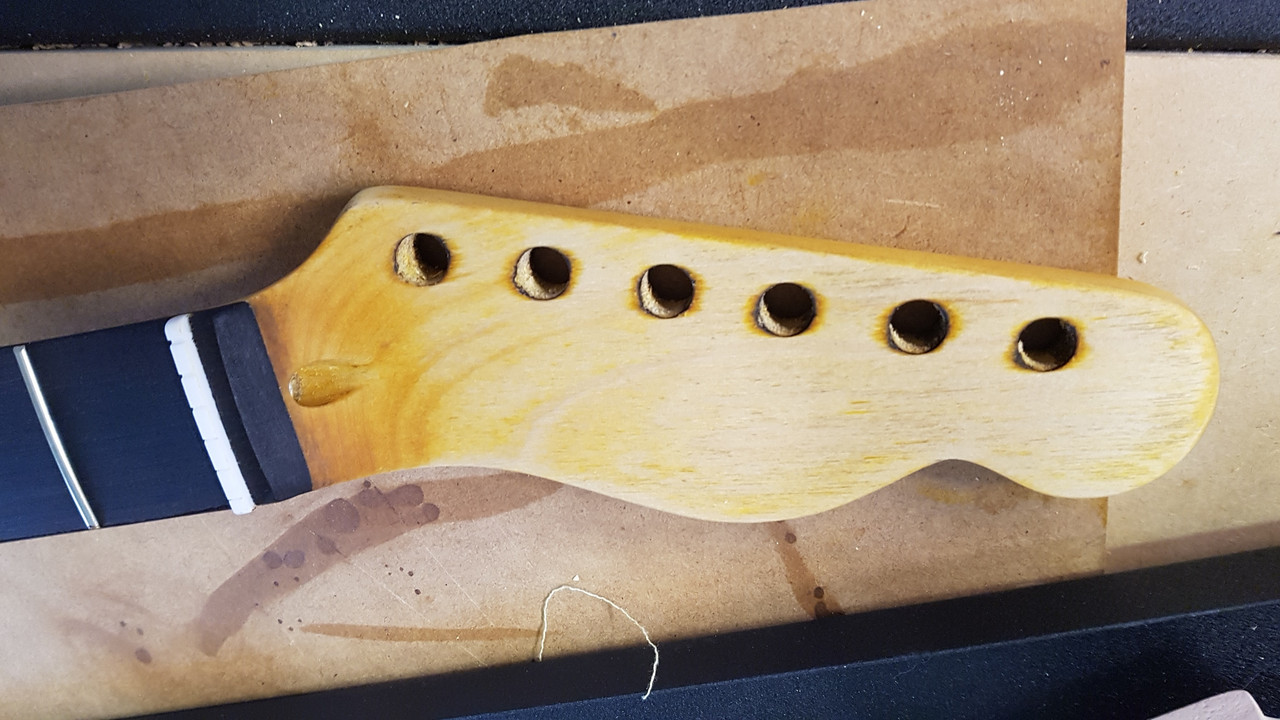

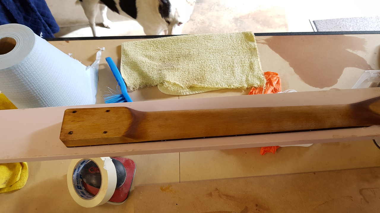

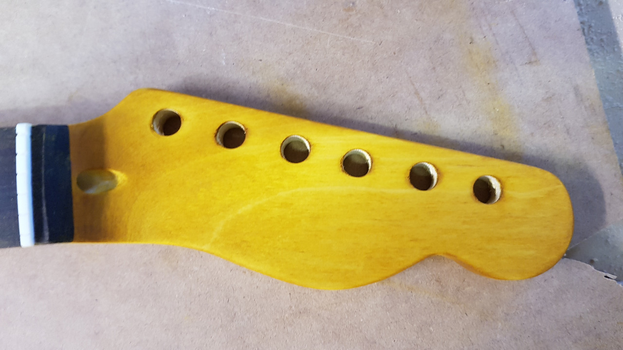

I sanded it back and added an extra 150ml of metho to the mix. This was much more to my liking but still very dark in places.
https://s19.postimg.cc/e9egyhl37/20180718_160907.jpg
https://s19.postimg.cc/c4u3xer6b/20180718_160924.jpg
Is it just a matter of sanding the dark areas? I am totally in the dark with this stuff :confused:
https://s19.postimg.cc/5uyua9mkz/201...851_-_Copy.jpg
I'd guess not, I'd say sanding the dark areas will result in a patchy look. If you are after the aged look, I'd go much more dilute. The timber will yellow a fair bit with a gloss clear on it anyway, it won't look white with a clearcoat on it. Particularly if you use a polyurethane.
I'd sand it right back, shouldn't be too hard as you have the rosewood neck, and then restain with a much weaker solution.

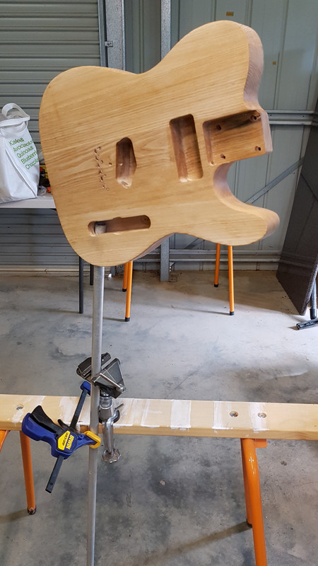

Makeshift guitar holder:
https://s19.postimg.cc/jrv092c37/20180729_121147.jpg

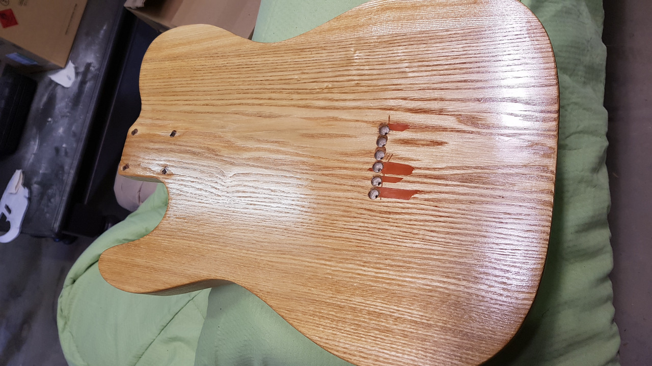

First sanding sealer coat applied:

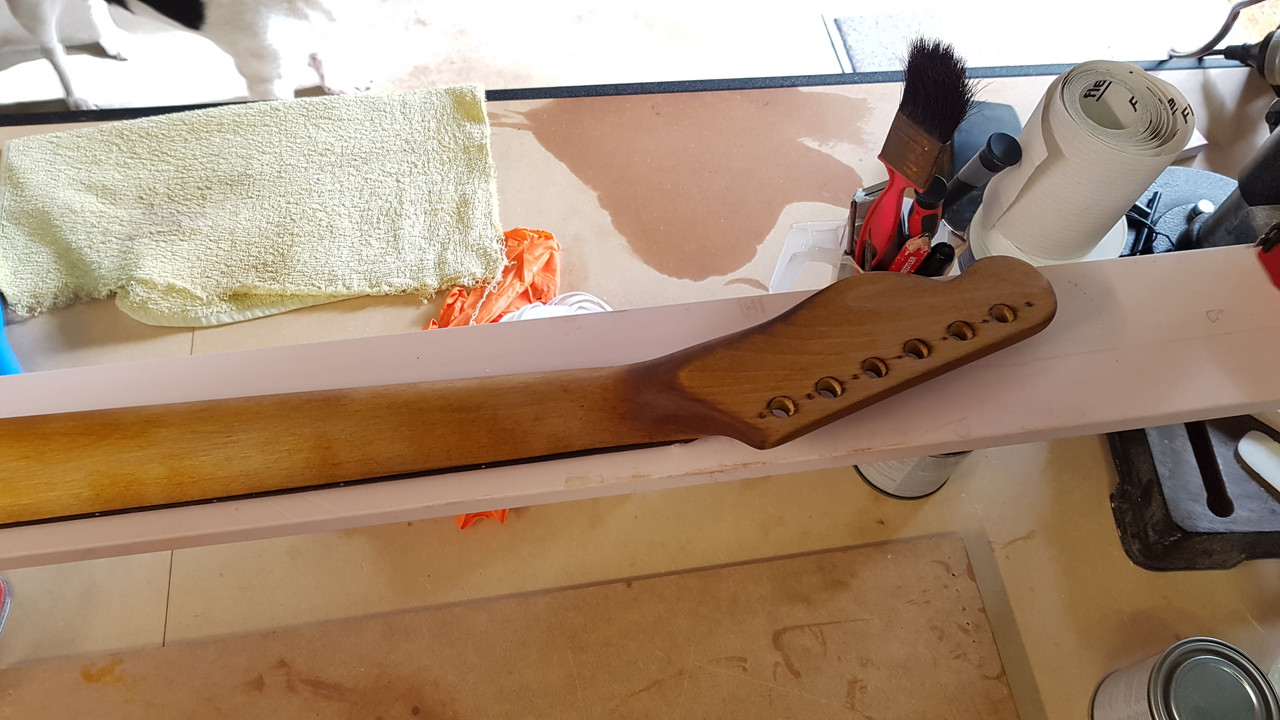

Neck is giving me hell, using a walnut stain/varnish, now:

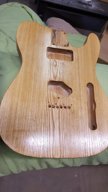

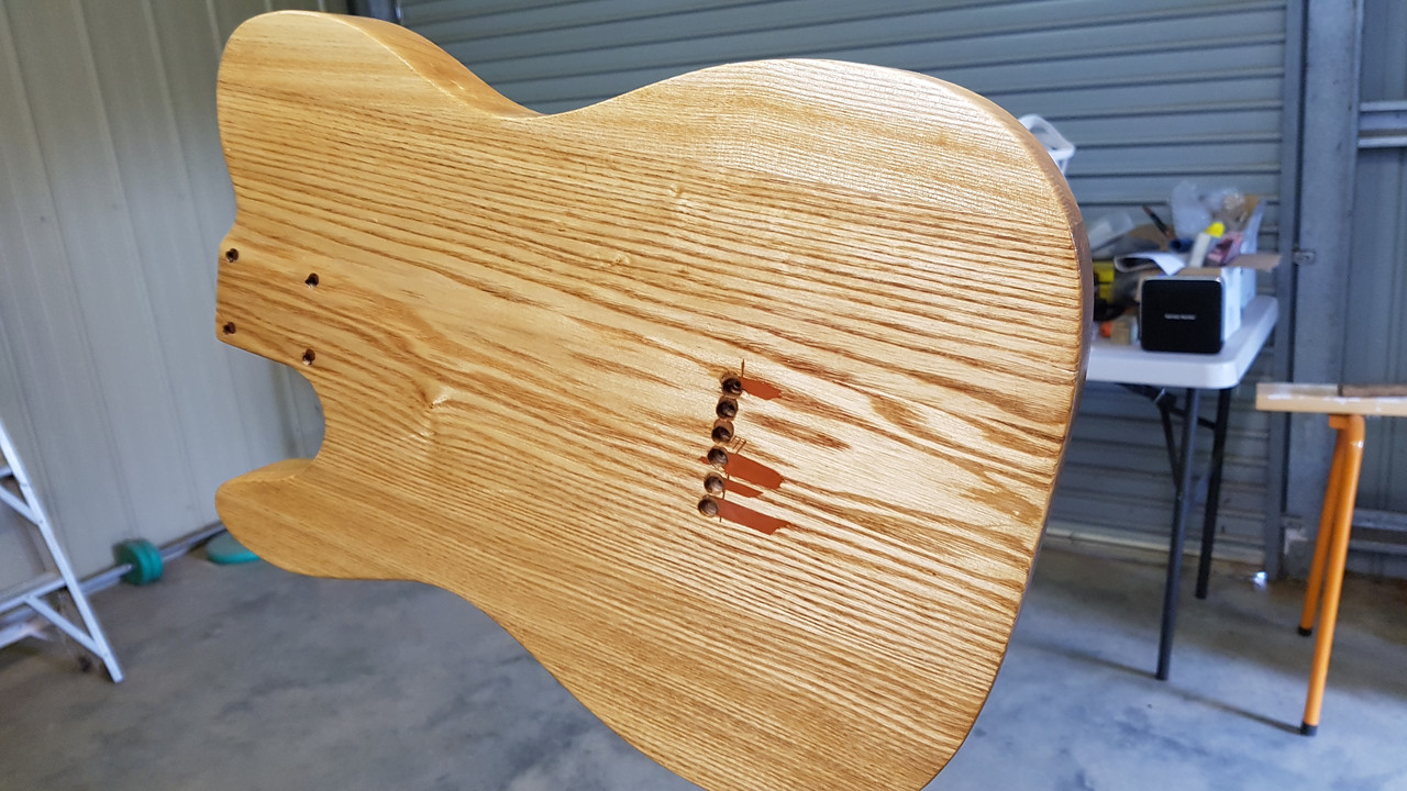

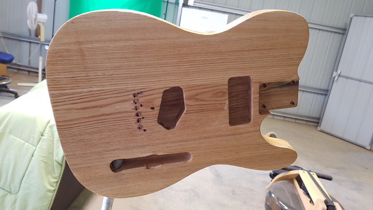

The body got its second coat of sanding sealer. It's a pity I ruined the string through holes as it is looking nice with just the sanding sealer applied:

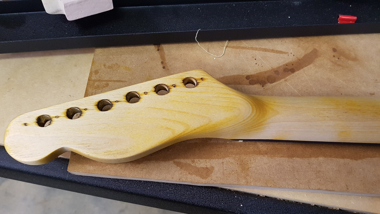

The neck, however, is a different story. The walnut stain varnish was a disaster, and sanding it off proved difficult due to it not drying completely. I have resigned myself to live with a linseed oil finish and patchy bits:
