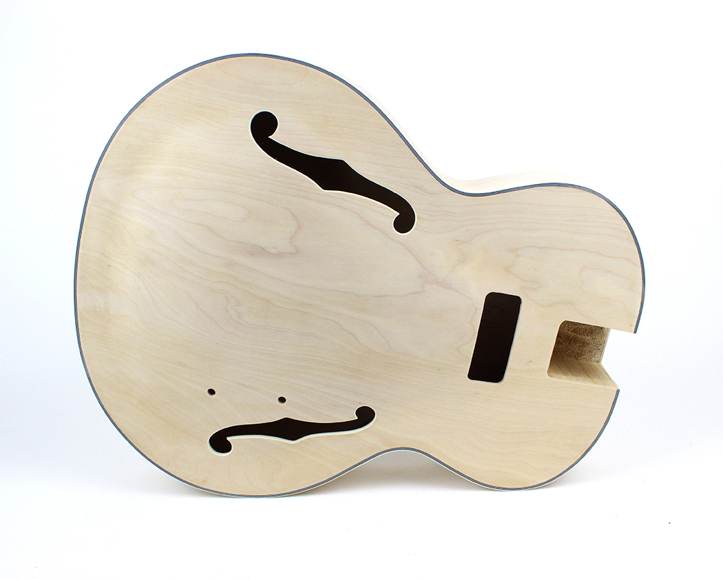

Not knowing anything about these, I just assumed from looking at the un-assembled kit photo that the wings went under the face of the guitar. It comes with a hole routed to the rectangular shape of the pick up implying that the pick up would sit in there. If it just got screwed onto the top of the guitar, why route a hole?

No, they sit on the top of the guitar. The pickup baseplate also has metal wings and the cover has shallow indents in the wings that fit over the metal.

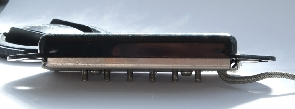

Attachment 26615
The hole in the body is to accommodate the main body of the pickup. Dog-ear P90 pickups are not height adjustable and screw directly into the wood of the guitar. The pickups are built to the approximate height required by altering the depth of the legs on the wings, and providing a matching height pickup cover. You can get shims to raise the whole pickup up, or adjust the pole piece height accordingly, but generally most dog-ear P90s are left as factory standard.
The above photo is of a bridge position P90, so the pickup sits a lot higher above the body than the neck one (at least it does on Gibson-style guitars with a significant neck angle). As there is generally less distance between the body and strings at the neck position, neck pickups have shallower covers so more of the pickup extends below the cover and into the body cavity (as the basic pickup height doesn't change).

Andy123, the routed hole is smaller than the black cover which sits on top of the body, and larger than the metal section which obviously pokes through the hole.

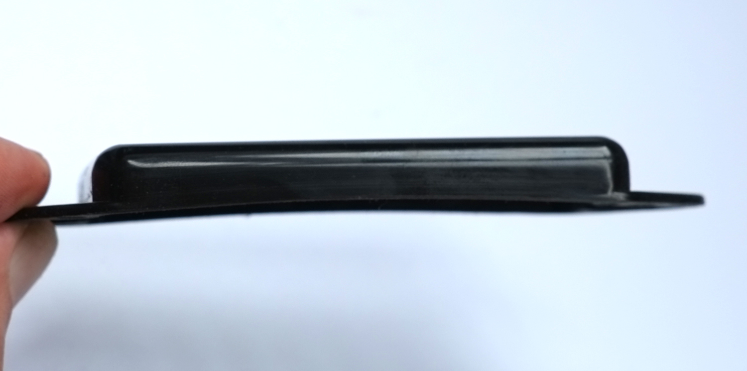

Here's the cover of a bridge pickup that I sanded using that method. It now sits nicely on the top of the guitar with no gaps. Carry on sanding until the curve reaches start of the ears, but no further.

It looks more like a couple of mm on DarkMark's guitar, about the same as I had with my bridge cover. The ears are never going to naturally lie flat on a curved surface, so will have to be pulled down a bit by the fixing screws. I have a slight gap at the ends of the ears if I just sit the cover on the guitar, but can press them down flat easily enough.
