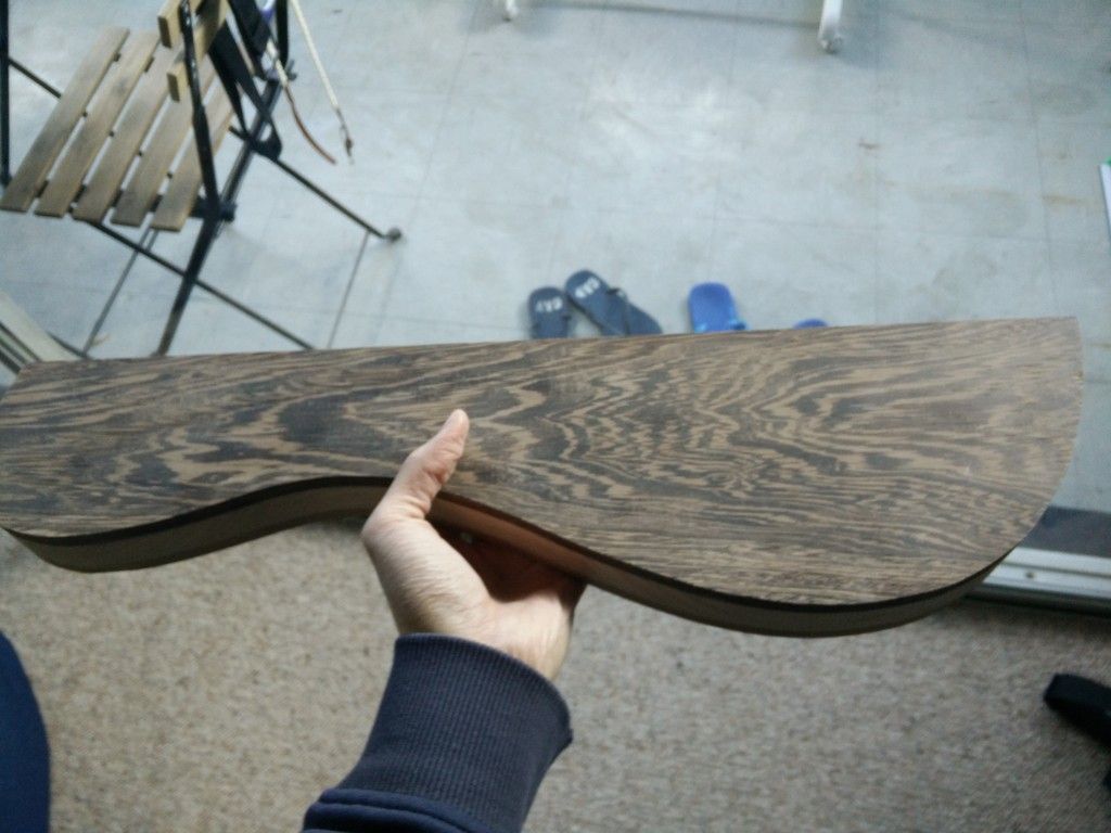

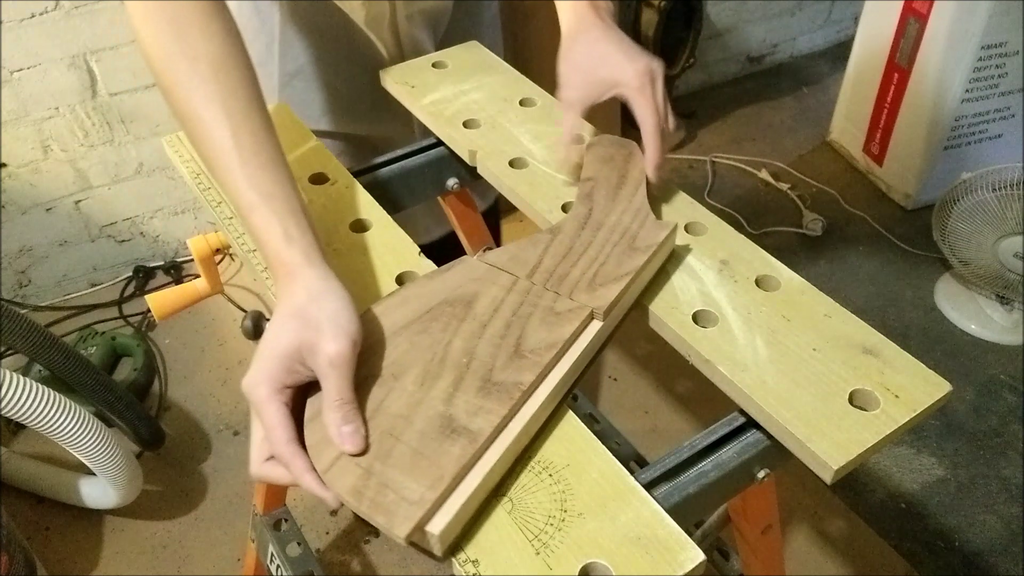

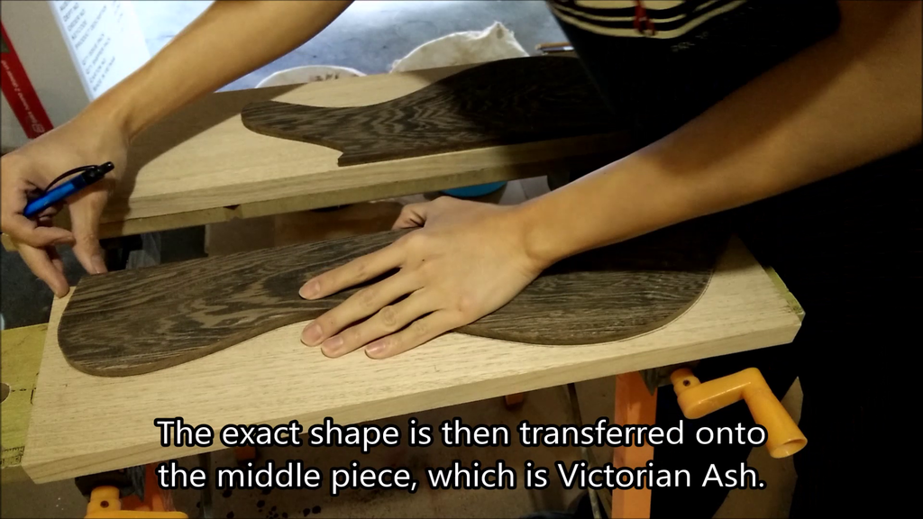

Once I was happy with the wenge top, I transferred the outline onto the second piece, the Victorian ash.
http://i23.photobucket.com/albums/b3...ps110qqakz.png

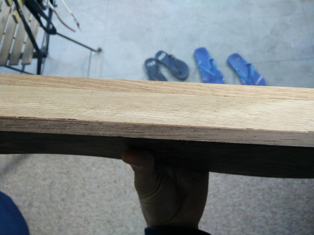

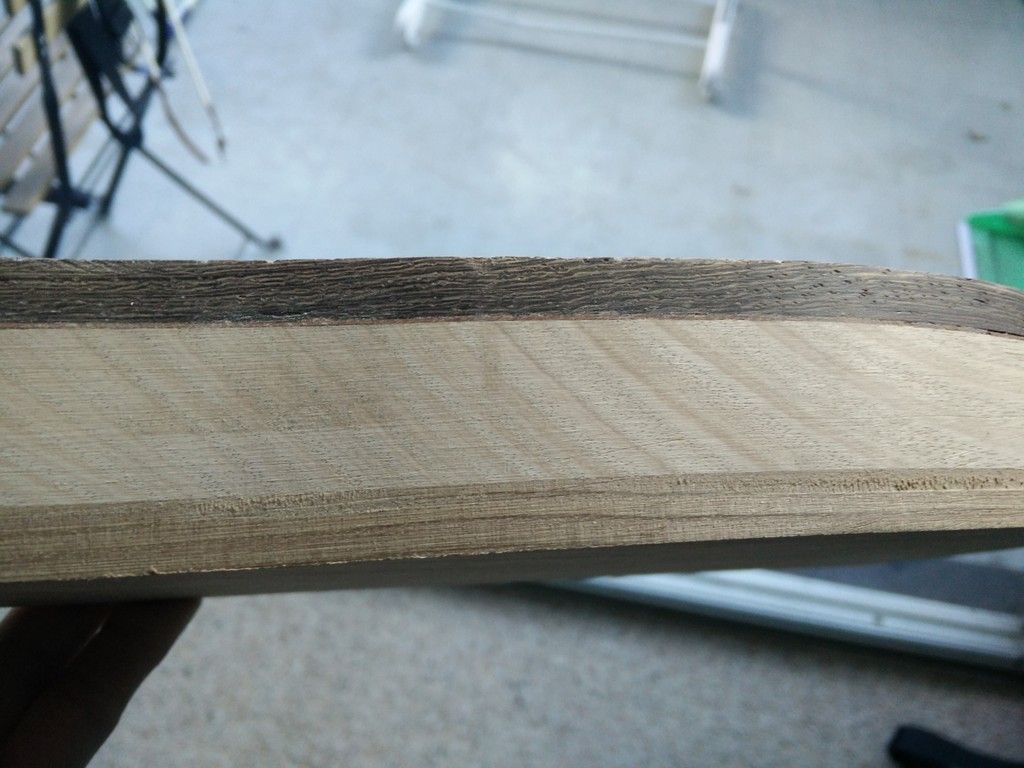

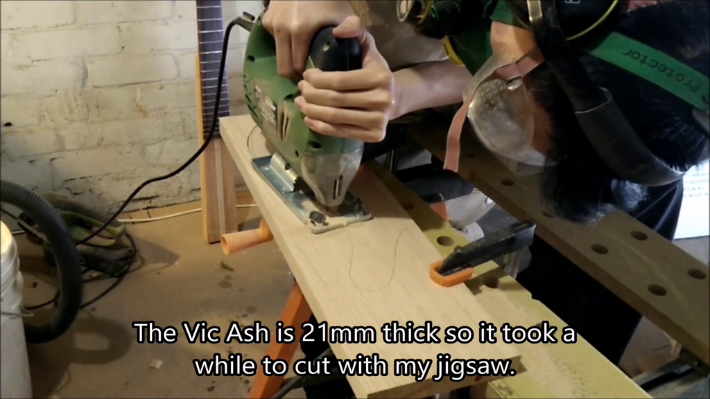

Then cut it out. The Vic ash is thicker at 21mm so my jigsaw was struggling towards the end. Man I wished I had a bandsaw!
http://i23.photobucket.com/albums/b3...ps2xeadjxm.png

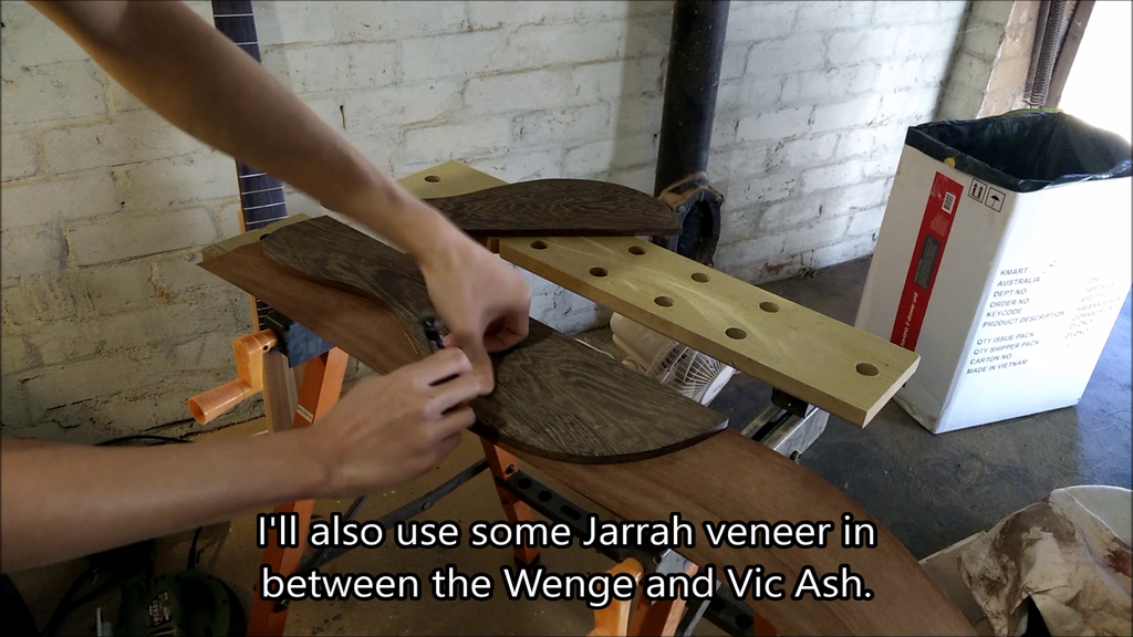

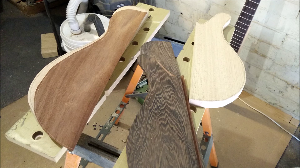

I also decided to use a Jarrah veneer in between the wenge and the Vic ash. This provides a nice contrast which should hopefully show up once I start carving the top.
http://i23.photobucket.com/albums/b3...pswhhzxi4s.png
Here's a pic of the first 3 layers.
http://i23.photobucket.com/albums/b3...psq8k5fkhi.png
