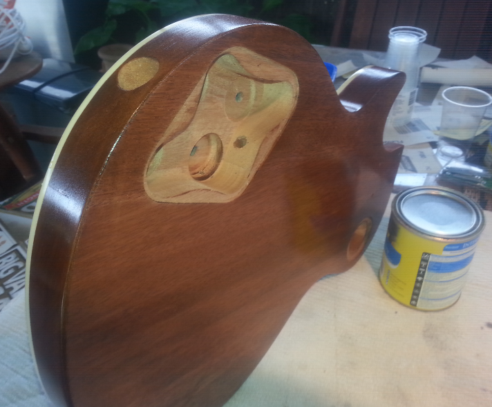

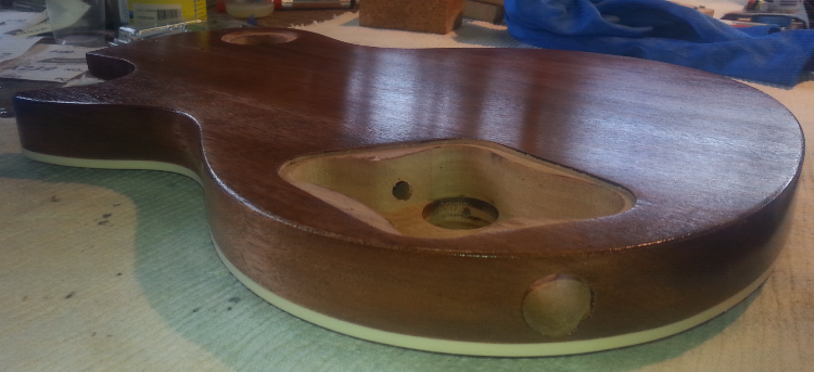

Ok so here's an update. These pictures are with 9 coats of Tru-oil with no sanding at all.
Attachment 12282
Attachment 12283
Attachment 12284
looking good Alkay, how many more naughty oil coats you planning ? Should have enough coats to let it cure and wet sand it I'd say

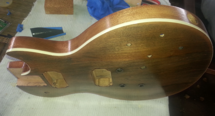

Here's a picture before I tried the wet and dry 1200.
Attachment 12285
....and now for the mistake. I thought I followed everyone's advice and also checked some videos too for tips.
I wet and dry sanded a small section of the side of the body from the neck to near the pickup selecter cavity area.
Wet and dry was soaked overnight in water and dishwashing detergent.
The section I sanded has left streaks in the finish. I used cork sanding block and made 4 smooth even passes in the same direction.
This was looking like a beautiful finish before I attacked it. I appreciate any help.
Alkay.

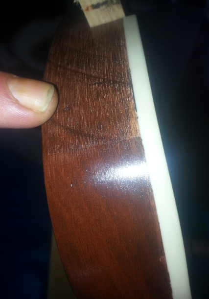

I hope you can see the damage in the picture.
Attachment 12286
Hi Alkay bit hard to see in the bottom photo. What grit paper did you use to wet sand ? EDIT just read you used 1200 grit
how long since the last coat of tru oil when you wet sanded ?
my guess is the tru oil maybe hadn't fully cured

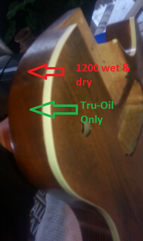

Heres a better picture so you can see the damage of the 1200 wet and dry sanding.
9th coat of Tru-oil went on 25/06/16. It has been drying in the lounge room near the fire place which is on mostly 24/7.
How long should have I waited?
Attachment 12287
