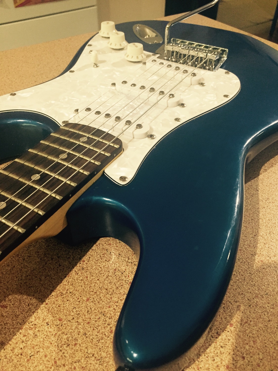

I love this guitar to the moon and back.
Attachment 12657
But I promised myself when the ernie balls can't be tuned anymore....its time for some upgrades!!!

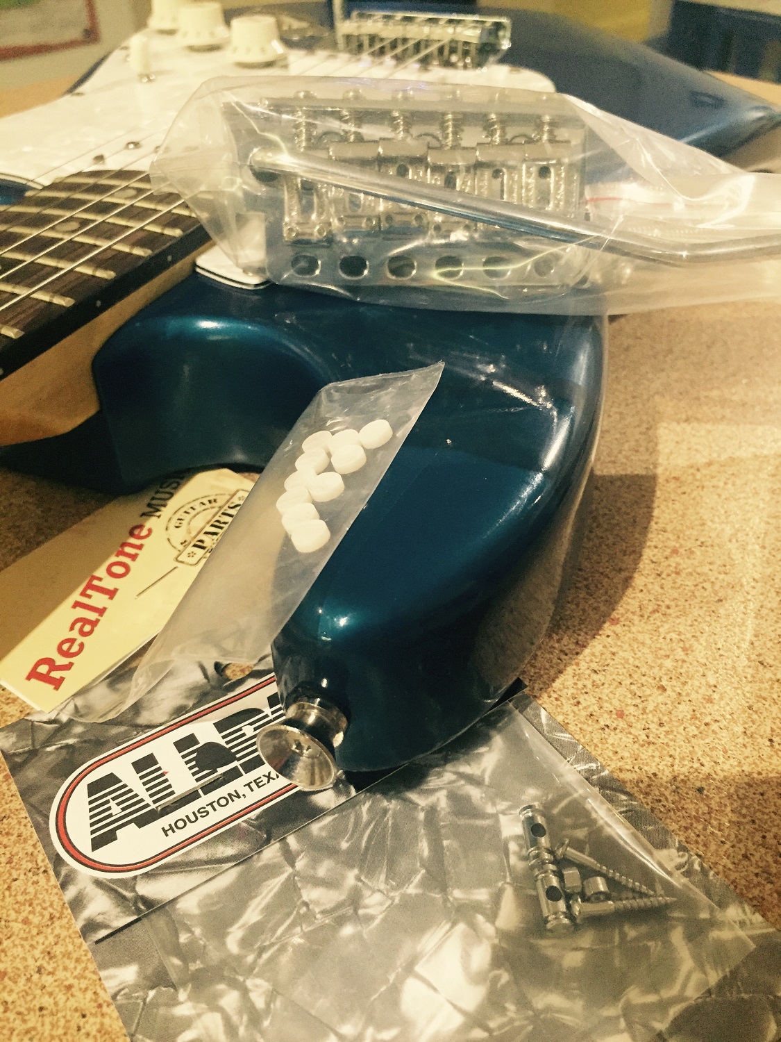

Attachment 12658
nice one Andy, so are they MOP fret dot markers the 10 white pills ?
Bridge looks good is that a Gotoh or Wilkinson maybe ?
Roller string retainers should help the tuning
Pretty good Wokks. So the rough plans are:-
1. Strip the nitro from the neck and replace it with Dingotone Neck finish final coat. (while its stripped i may think about plugging the existing tuning holes and re-drilling them straight);
2. Patch up the chips in the body paint (I am going to consider refinishing over the Nitro with Tru oil - any thoughts appreciated);
3. re-place the PBG tremolo with my NEW Wilkinson 5 + 1 Tremolo and re-align that bridge placement (its not quite centered with the neck and has always bugged me);
4. re-place the plastic fret inlay dots with MOP inlays;
5. replace the PBG string trees with Gotoh Barrel Style string guides;
6. Do something electronicy. Don't know yet. have to do some research. I have to probably consult with wierdy. currently both tone knobs seem to roll off the tone in switch positions from the neck to the middle + bridge - I've got to fix that. I wanted to give some thought to rolling off the tone on the bridge pup as well.
Thats about it, unless I think of anything else while I have her apart!
