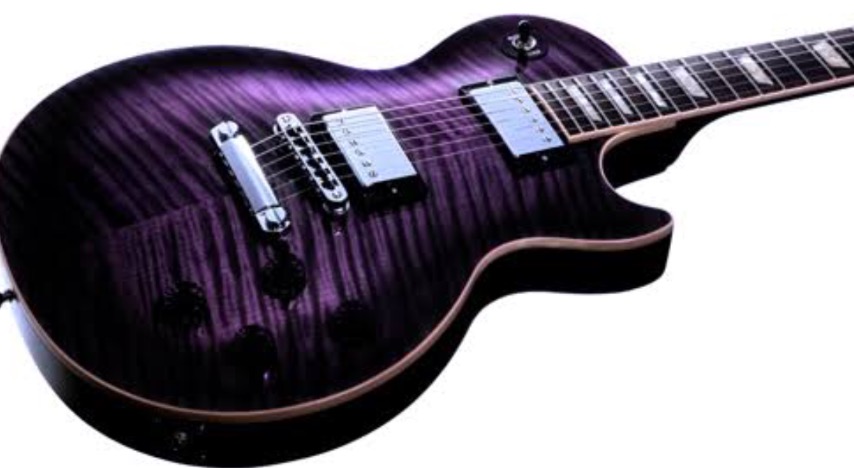

So I know I am yet to finish this build, but I am set on this next!!
LP - maple top in this finish! *froth material* purple to black fade
I am thinking possibly black hardware though!
Attachment 8794
Candle or some soap for waxing the screws, i do it to every screw.
Hi Shazz, a bit sad to hear about your wiring troubles and the guys have already given you plenty of good advice.
For the Purple LP stick with chrome as Black hardware may make things look too dark overall. A bit of contrast can make a world of difference that is why black on light or bright colours looks so good.

purple guitars are cool, check my build thread on my sisters guitar... unfinished...
