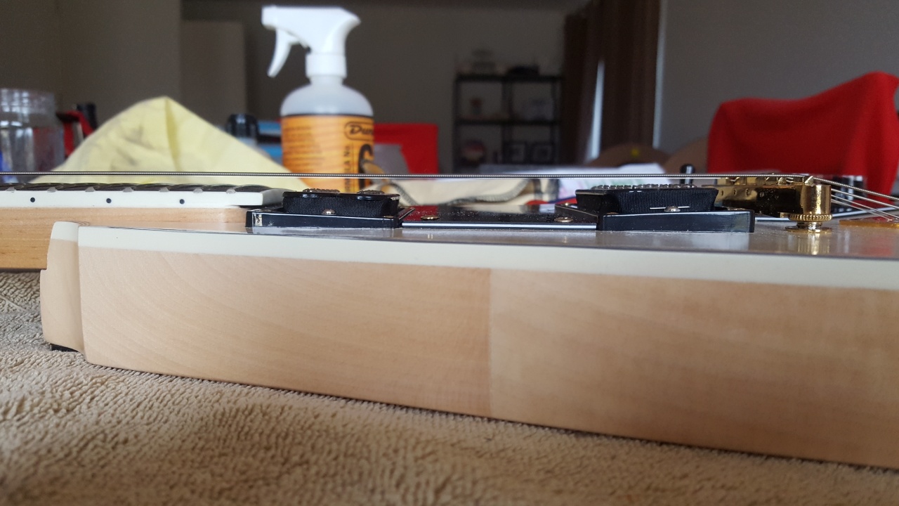

That looks much better.
How high are the strings off the end of the fret board? From that shot it looks somewhere between 3mm to5mm?
If so maybe you have some frets sitting a bit high from somewhere near 12th to 22nd and easiest way to check is with a stanley knife blade, starting at end of fret board you place the blade across the last three frets to see if it is rocking anywhere. If it is, mark that fret with a black marking pen (sharpie or similar) and keep moving on doing this all the way up to the nut.
Where there are frets sitting a bit high sometimes a light tap will help seat them a bit better and sometimes they may need to be sanded level. I think there may be a tutorial on the forum on how to deal with this.
If you are happy with the action at that height and no fret buzzing you could simply leave as is but if you want a lower and faster action the extra time taken is well worth it.
