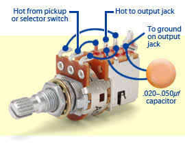

Question for all the wiring gurus... how does one make a push/pull pot both volume and tone? I found a wiring diagram but just want to make sure it's right! Attachment 20176
That will work if you want it down for volume, up for tone. However, when in tone mode the volume will be full and in volume mode the tone fully off, so it doesn't 'hold' its settings. Also, that example is wired more for independent volumes like on a bass.
It all depends on how you want to use it and in what context with the rest of the SG's circuit.
Thanks for the Vid Shazz, I finally got around to watching it!. love that new kit feeling
Not with a push/pull, no, it works as one or the other and can't 'hold' setting once switched.
If you want volume and tone and to have the settings 'stay' in a single control your only practical option is a concentric pot. That would allow you to control both volume and tone but requires a stacked knob that typically has limited styles, so that option will depend on the style of knobs you want to use with the build.
Like I said it depends on how you want to incorporate it into the rest of your circuit as to what the best options would be.
