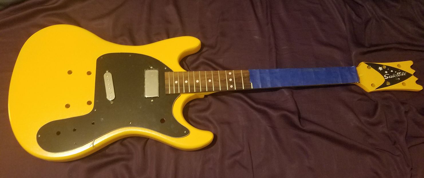

1 Attachment(s)
Did a quick mockup so I could make sure everything was still fitting together (I've taped off the neck pocket for a lot of the coats, but I wanted at least one coat to get in there just for preservation).
Attachment 18476
Heh, after catching myself plotting out a different design on same kit, I guess I now see how some of you are doing multiple kits at once.
