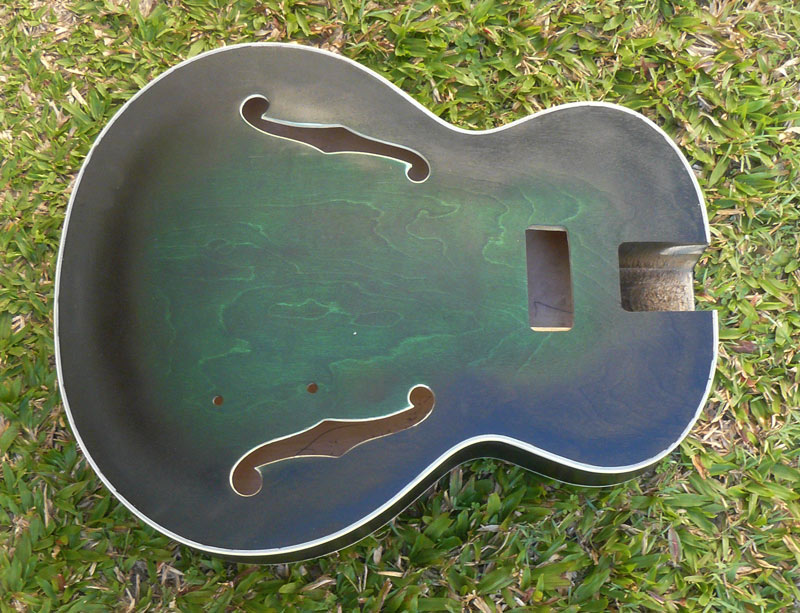

Yep, I also firmly believe that it was one of the bigger contributors to the stain fail on the first effort. I have since spent some time building holding jigs to alleviate the same issues.
EDIT: the other major contributing factors being
A. I'm an impatient cuss
B. I have the soft touch, agile dexterity and artistic flair of a true rugby front rower
