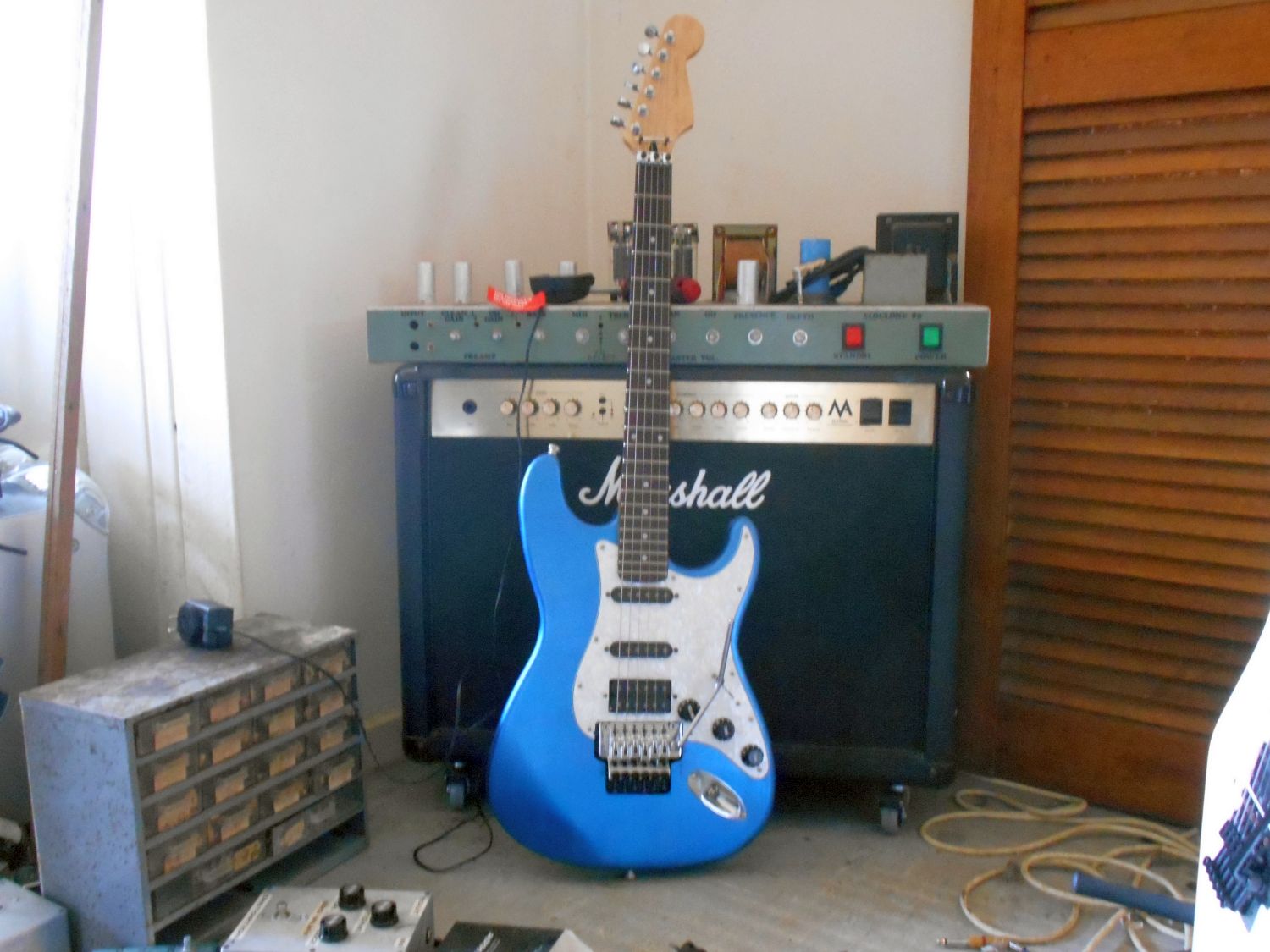

Next fortnight, I'm going to be looking at ordering a set of new pickups, pots, etc from Realtone Music for my HotRod Strat, I was thinking of ordering a couple of Kent Armstrong Dual-Blades to replace the neck and middle Single-Coils, and a Tonerider Rocksong to replace the Bridge Humbucker, do you think these pickups will work fine together in my HotRod Strat?, the Dual Blades are Humbuckers (i.e. noise-cancelling) in a Single-Coil sized package, the pots currently being used in the HotRod Strat are a set of 24mm 250kA (log) CTS pots, I'm going to be replacing the 24mm CTS 250k Log volume pot with a 500k Log mini CTS pot, and the two 24mm CTS 250k tone pots with two 250k log mini CTS pots, reason being is that the body-routing clearances under the scratchplate are pretty tight, I had to shave off some of the body wood in a couple of places, just to be able to get the scratchplate installed.
I want to install noise-cancelling pickups in the neck and middle positions so that I don't get any hum when those pickups are selected, also, I want those pickups to be a bit more beefy compared to standard Single-Coils so that they balance well with the full-sized bridge-humbucker, I'm not too worried about losing some of the Strat tone cause my Marshall is a bit bright in the Overdrive Channel anyway.
Here's a pic of my HotRod Strat, all up and running in a playable condition, it is leaning against the front of my Marshall amp, on top of my amp is my SLO50 amp chassis that I'm working on building:
Attachment 14998
Het Doc, that came up looking good and has a Floyd style trem too.
Cannot comment on PUP compatibility other than blades do have a beefier sound than stock single coils and have one in the middle of my son's H-S-H hot rodded strat and it actually sounds better than the bridge humbucker.
You could go Kent Armstrong all the way and fit an M-Bucker Cool Blades in the bridge position. This is still a very powerful pickup, but having two x four-wire leads (it's basically two dual-blades on a common base) you would have the ability to select just one of the dual-blades if you wanted to match the sound and output of the middle and neck pickups, and then select both of them for a louder output. You'd need to add some mini switches or some switched pots to do it, but it can be done.
