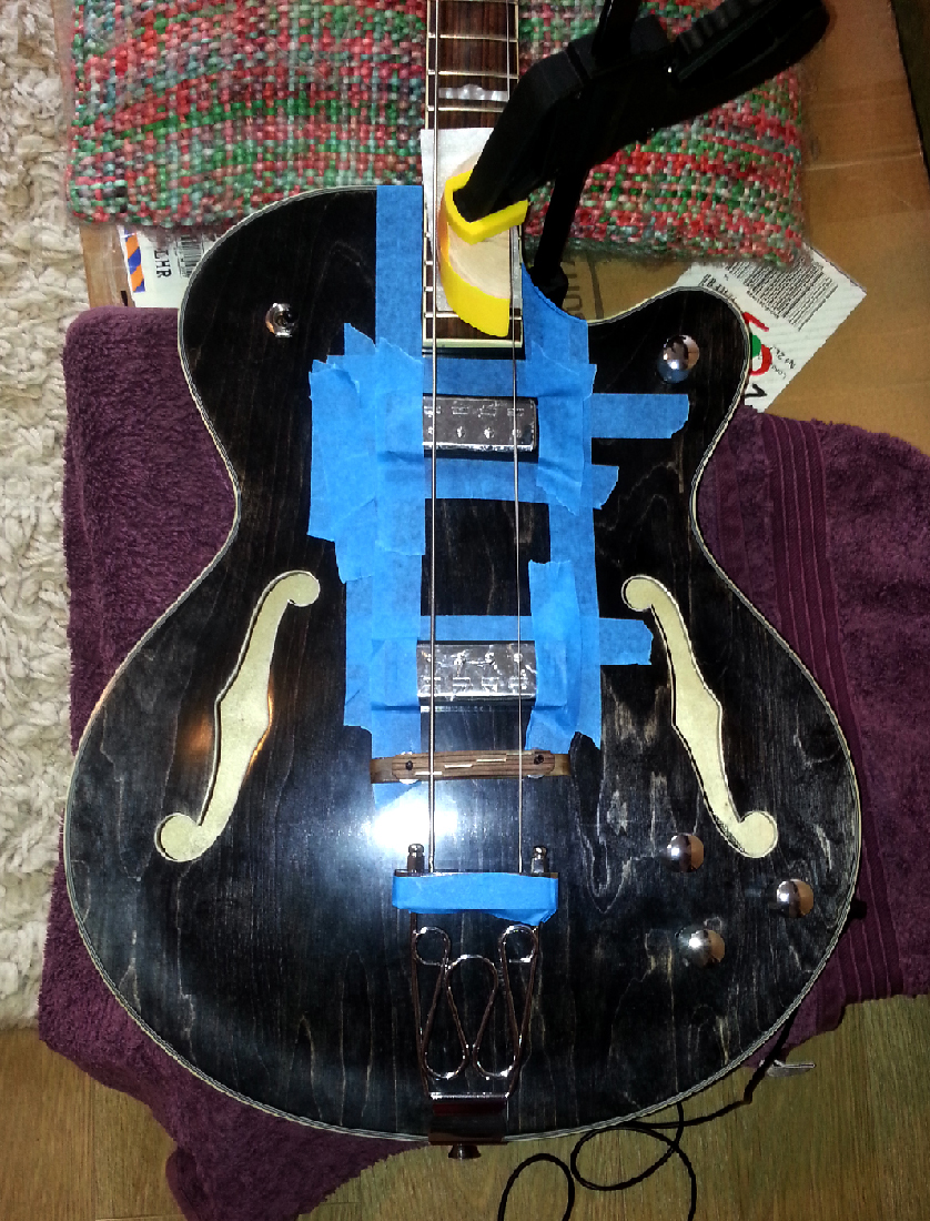

With a trapeze style tail you usually drill a small hole through for the ground wire so it can make contact under the tail plate. As long as the tail plate covers where the wire comes through you won't see it, and a loop of bare wire under the plate will ensure good contact etc. Just make sure the hole is not too close to the strap pin. Don't use braided wire for the tail ground, a piece of the kit supplied insulated wire is better in this case.
