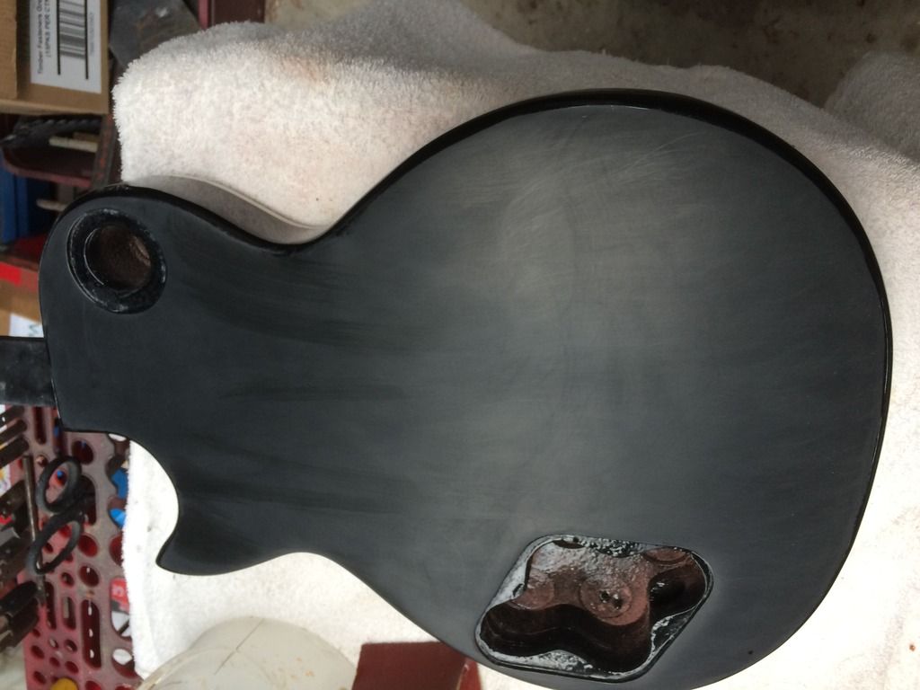

resanded the back, came out ok, repolished, glossy, far from right, but it will come up ok. i'm concerned though it will still be "soft".
after turning it over, very minute signs of the towel affecting the top. this is a clean towel, with no chemical exposure. it's the paint cure i'm sure
sanded back to 2000

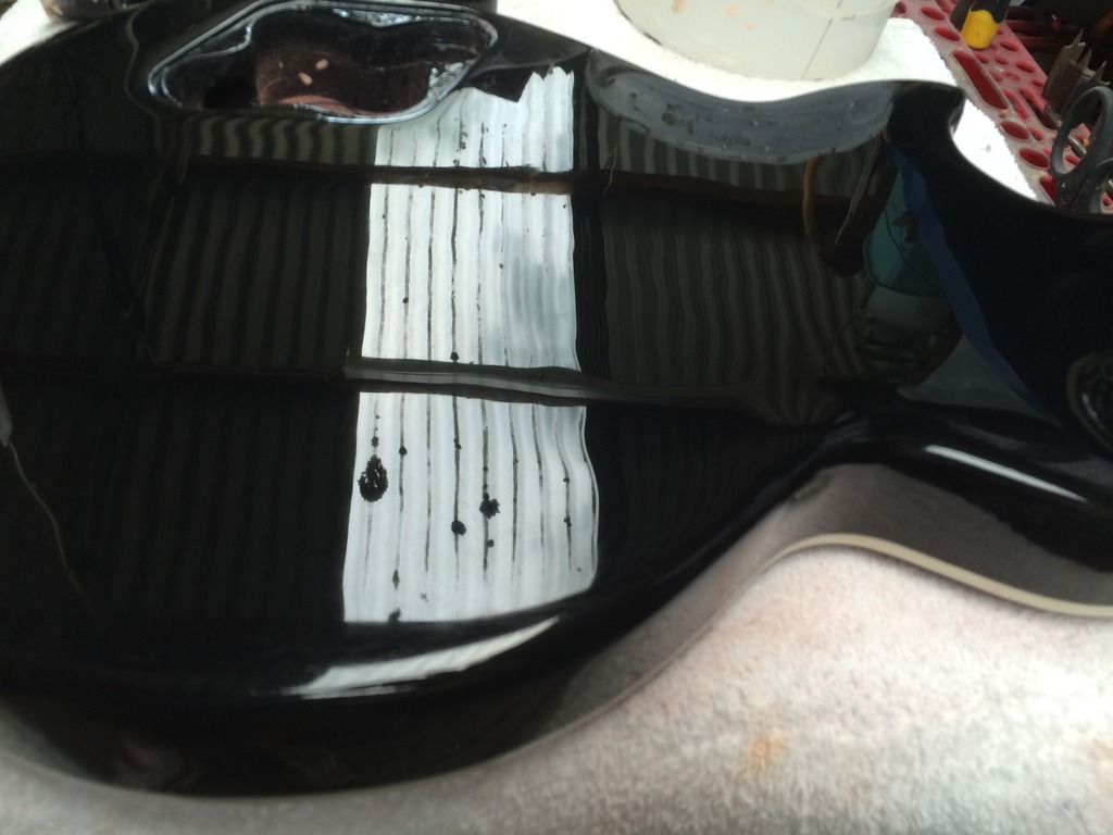

polished
http://i271.photobucket.com/albums/j...l%20LP/074.jpg

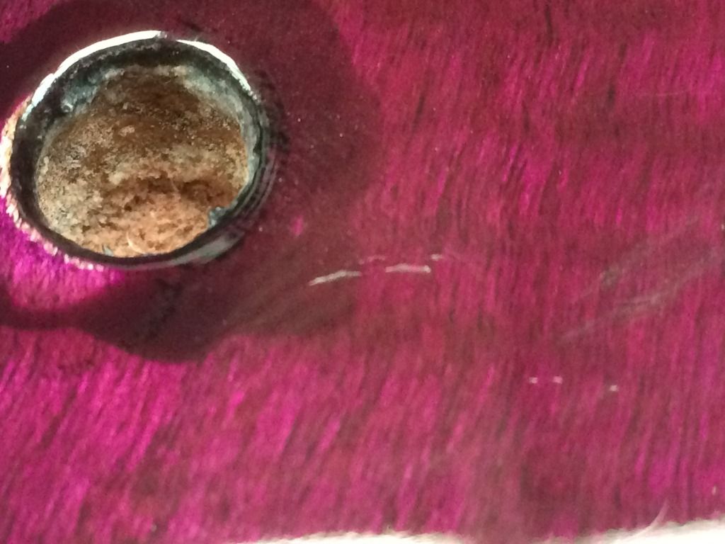

fingernail test... still soft (2 small marks to right of hole)
http://i271.photobucket.com/albums/j...l%20LP/073.jpg
Stan to be honest the paint must be quite thick and not left long enough between coats. This is not a reaction with anything else as acrylic does not react like that. Cut the clear back to as thin as you dare and leave it for two weeks without polishing it. After a couple of weeks start with the fine cut and then polish.
I agree with Jrod's diagnosis.
From what you have said you did it right except perhaps went in a tad heavy handed... I am guilty of that one too :p
Patience, Grasshopper, Patience is the key :)
