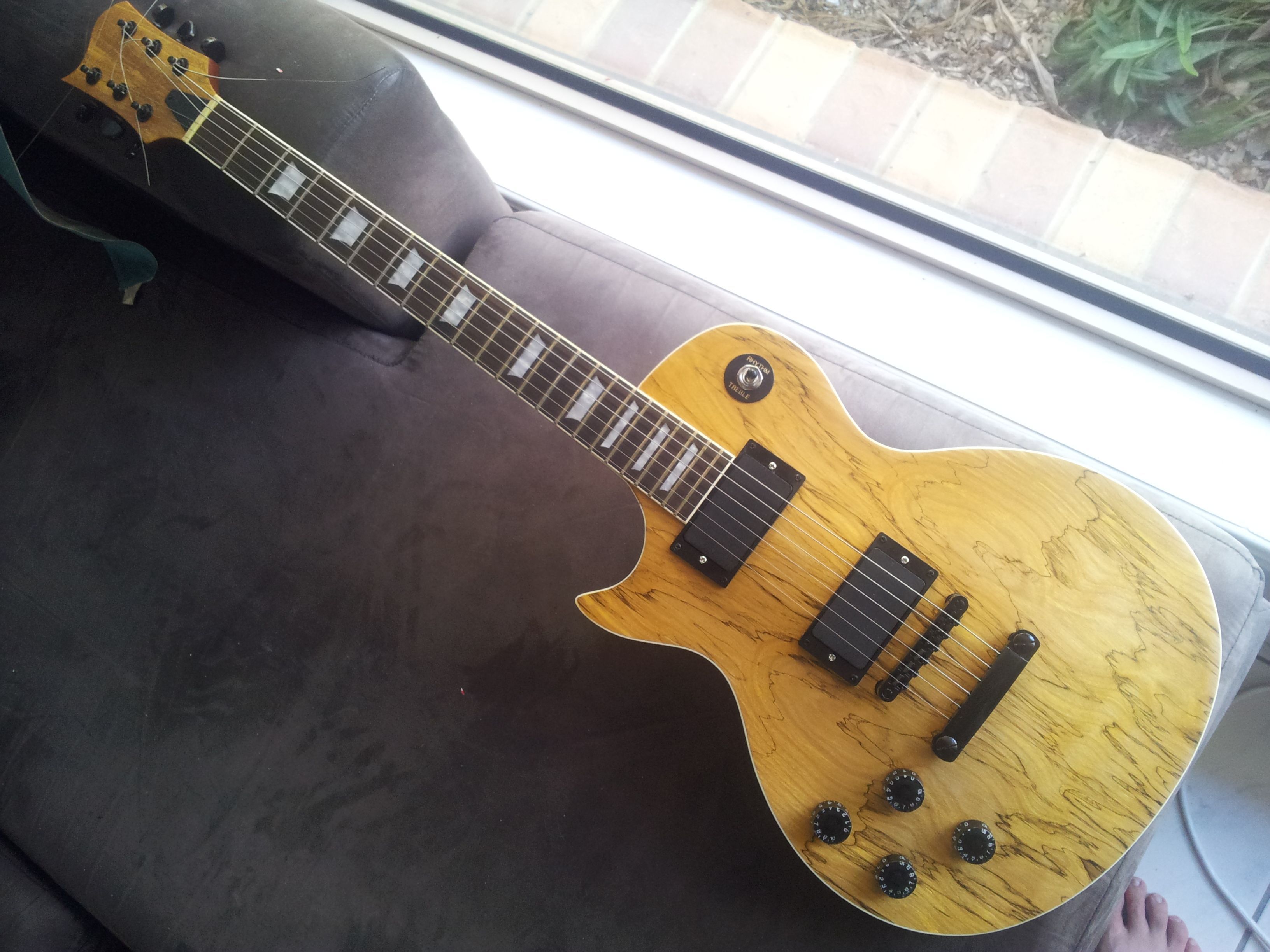

Anyway, here she is... Almost there. She looks the business and makes a noise, but she needs a proper setup before I get too excited. The action is pretty low and the nut needs a bit of filing. I'm going to take it to a guitar tech mate of mine for the relevant surgery.
http://www.pitbullguitars.com/wp-con...304_161023.jpg
Man,that looks hot Tim. I've never been much of a fan of LPs but that is cool! Even if it is the wrong way round. Excellent build mate.
Looks good. Might have too look at a G-type later in the year.
nice Tim, I am a lefty too, so keep it locked up...
