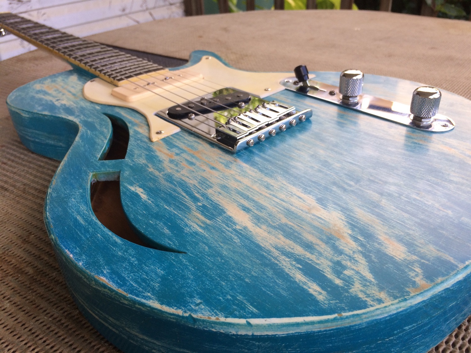

Finally finished, well sort of.
Lyn #20 continued to fight all the way to the finish but all in all I’m pretty happy how she turned out.
She was never going to be a pretty guitar but as I’m not a big fan of reliced guitars I was hoping for the appearance of a guitar made out of old distressed timber. Not sure I pulled it off, but meh, I had to give it a try.
My total lack of for-planning meant that the neck sits a bit too low in the body. I thought I had fixed that by hand planing a mm off the front of the guitar and gluing a piece of veneer in the neck pocket, but alas it looks like I should have planed some more or used 2 pieces of veneer.
Once assembled I eagerly plugged her in to the amp and the neck pickup does not work. So obviously I immediately assumed that I had screwed up the wiring and went on a journey of discovery into the black art of electrickery. For the life of me I still cannot figure out how those CRL 3-way switches work. But I had narrowed it down to the switch or the pickup. Ended up being a dud pickup. Seeing as it was a Tonerider I was quite surprised as I have used dozens of them in the past without a prob.
Luckily I had a standard kit P90 on hand and will be using that until I get the Tonerider sorted. I am expecting a bit of a boost in output once I get the TR installed.
And lastly while doing the setup I found that I cannot get the Allen key into the truss rod nut, so I can’t adjust it. Luckily the neck was perfectly straight when I did the fret level so I only need a smidge more relief for it to be perfect. I will have to see how it goes in a week or two with string tension.
Well enough of the complaints…...pickies

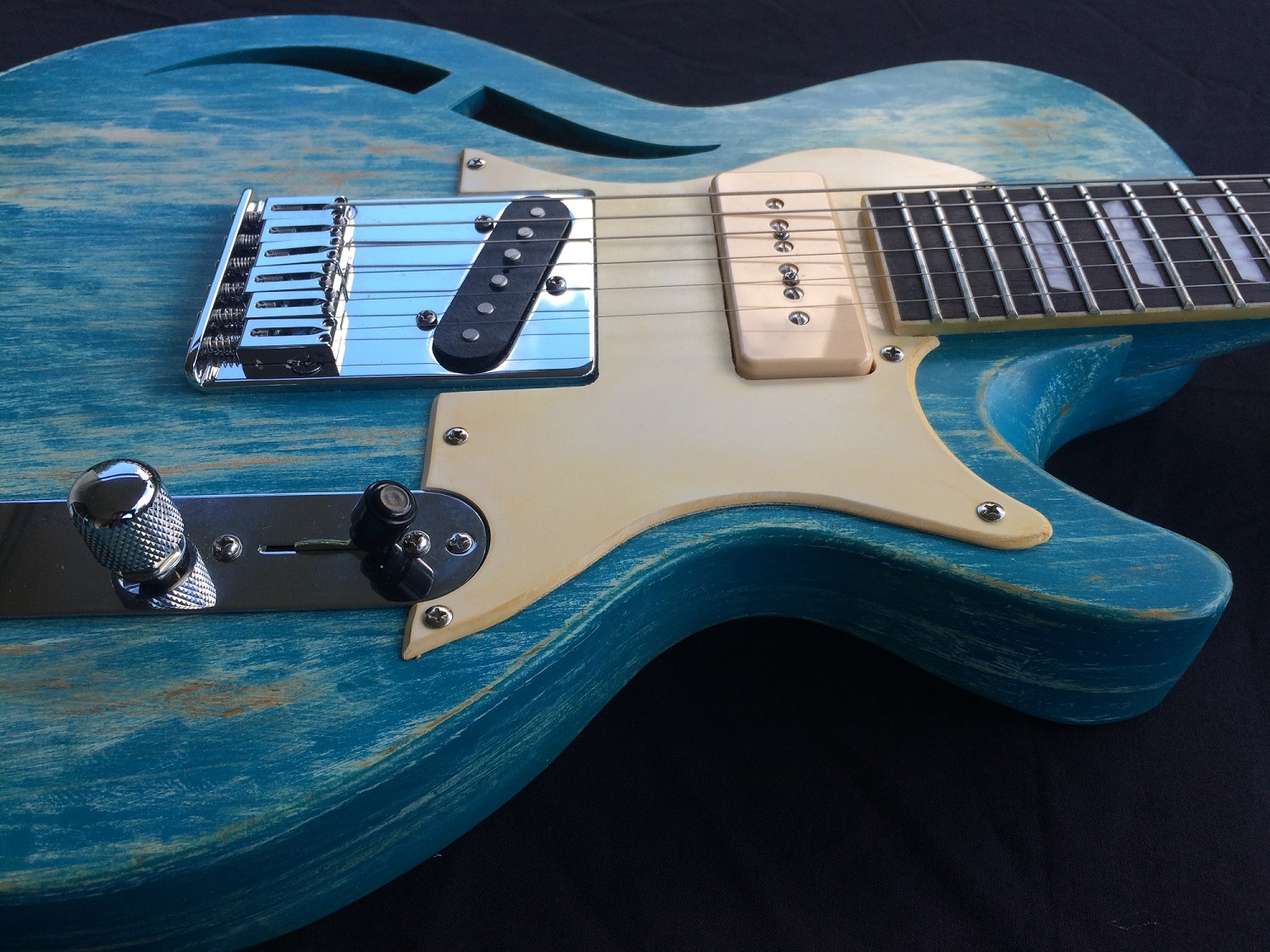

Attachment 40683
I cut down a white Tele scratch plate from one of my PBG kits. Stark white didn’t look right so I aged it with some Feast Watson Proof Tint. It ended up a bit uneven which looks just about right.

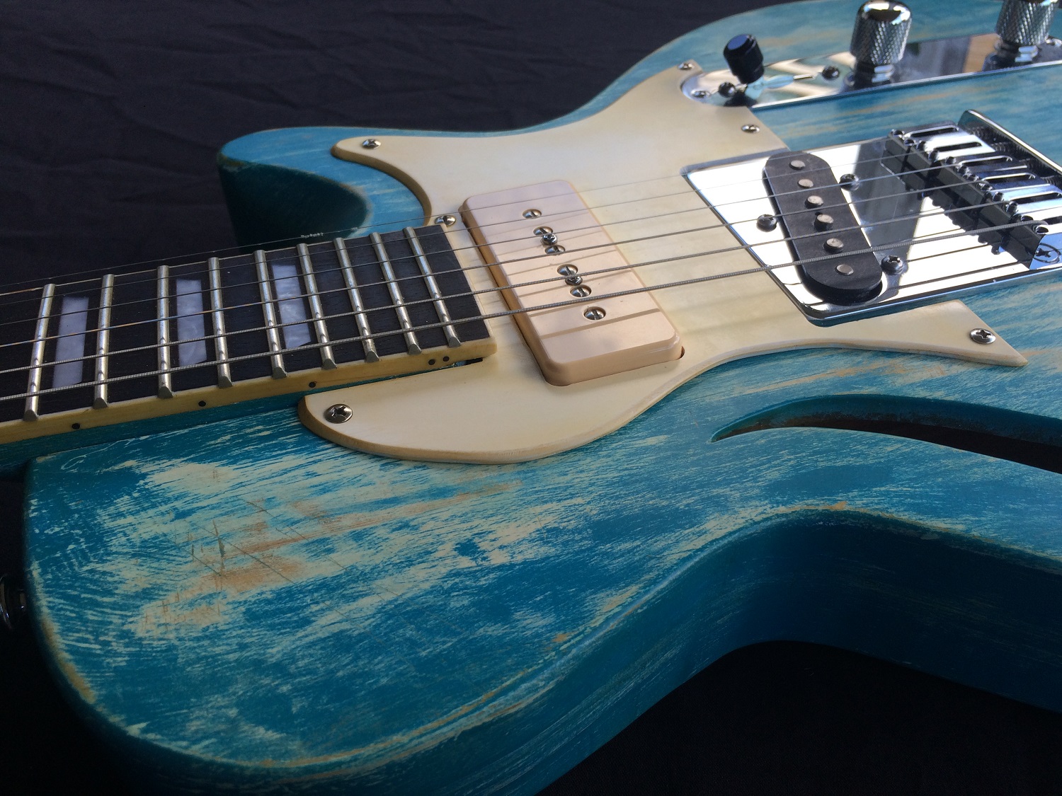

Attachment 40684
A bit more detail. Scratch plate is still a bit rough, but as I have to remove it to replace the P90 I’ll tidy it up then.

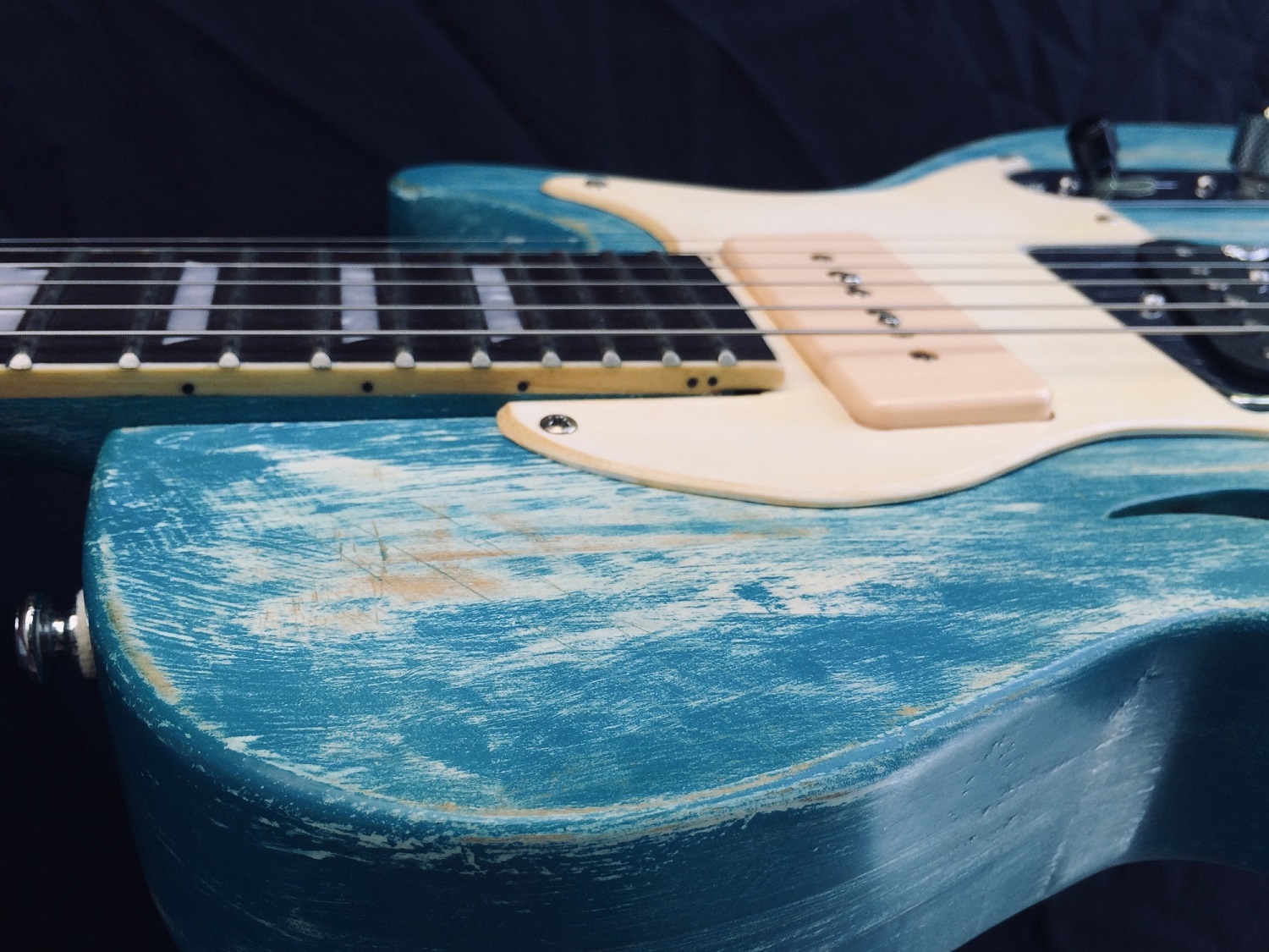

Attachment 40685
I also “aged” the white binding on the neck.

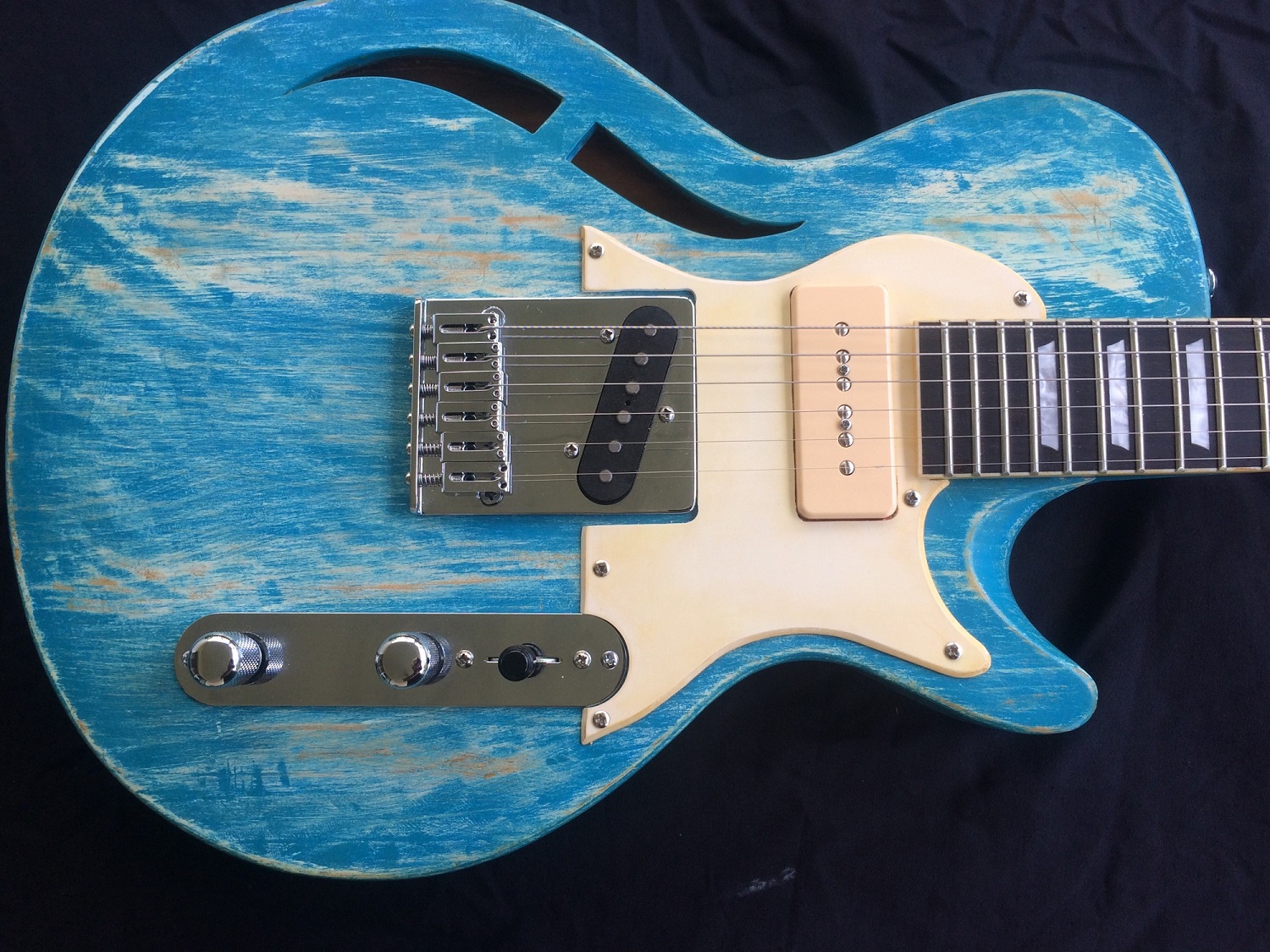

Attachment 40686
Attachment 40687
Just a couple more....
