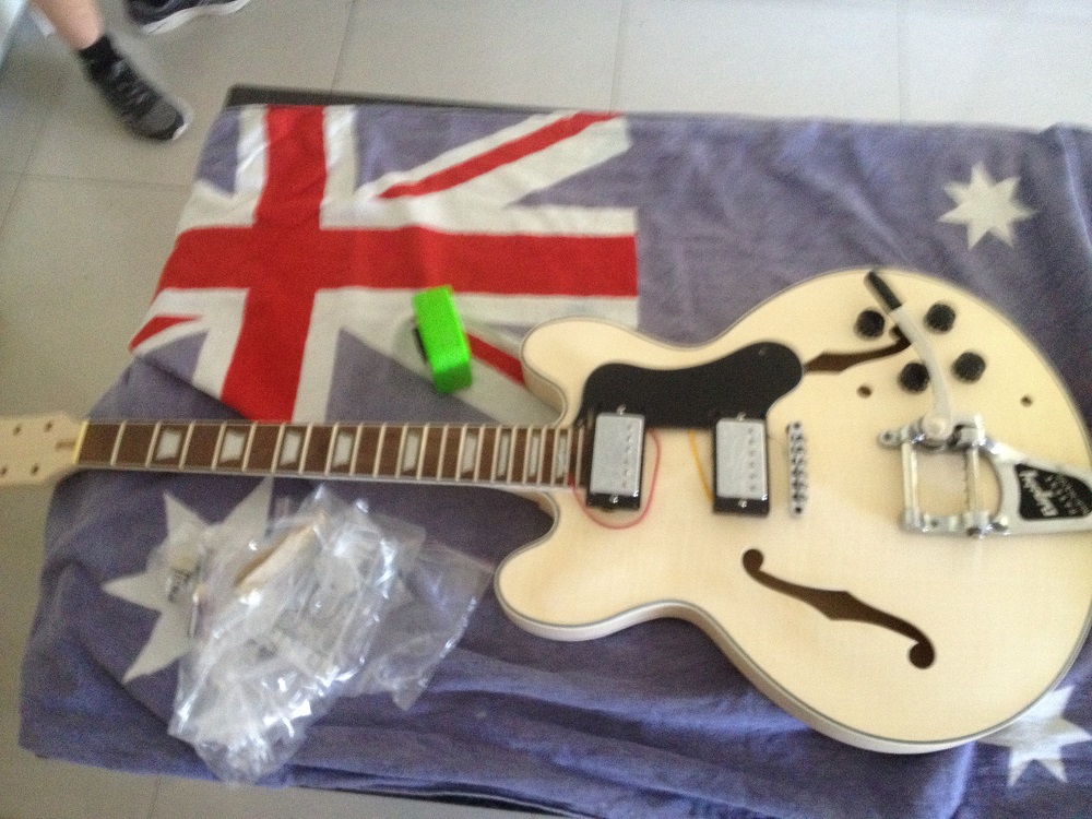

Just got my ES kit- super excited to begin the build soon. Bought a Bigsby which I think will look cool. Also putting an SD 59 in the neck and Dave Leddin is making me a PAF style humbucker for the bridge. Gonna go for an Olive Drab paint job to make it look like Brad Cooper's in the new Star is Born.
There is just one thing that I want to clarify before I set the neck- when I push the neck all the way into the neck pocket the humbuckers won't fit in. Am I meant to pull it slightly out to allow for them to fit into the holes?
I added a photo of how it looks in the mock build. If anyone has any advice I'm all ears.

The neck doesn't go all the way in. Move it back just enough so that you can fit the neck pickup ring on the guitar with none of the pickup rout showing at the front. You only need the neck to be about 1mm from flush with the rout to do this.

Hi Luke, good luck with your build. I'm 2 weeks in. Had a similar problem (only 3 corners would fit in at once) and had to file the corners of the neck pickup cavity out by a few mm. Might be worth checking

Attachment 32961 Hopefully this pic comes through
