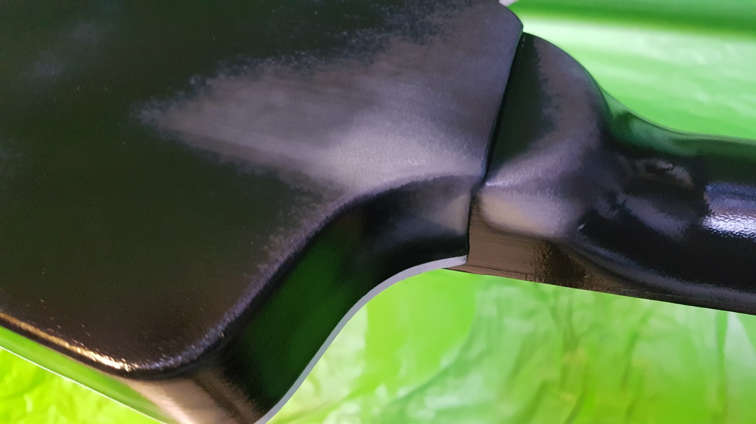

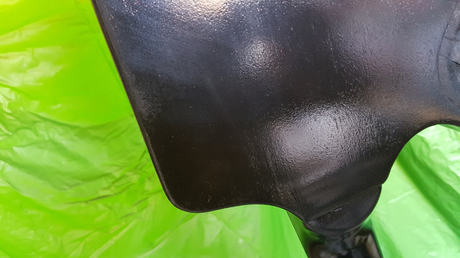

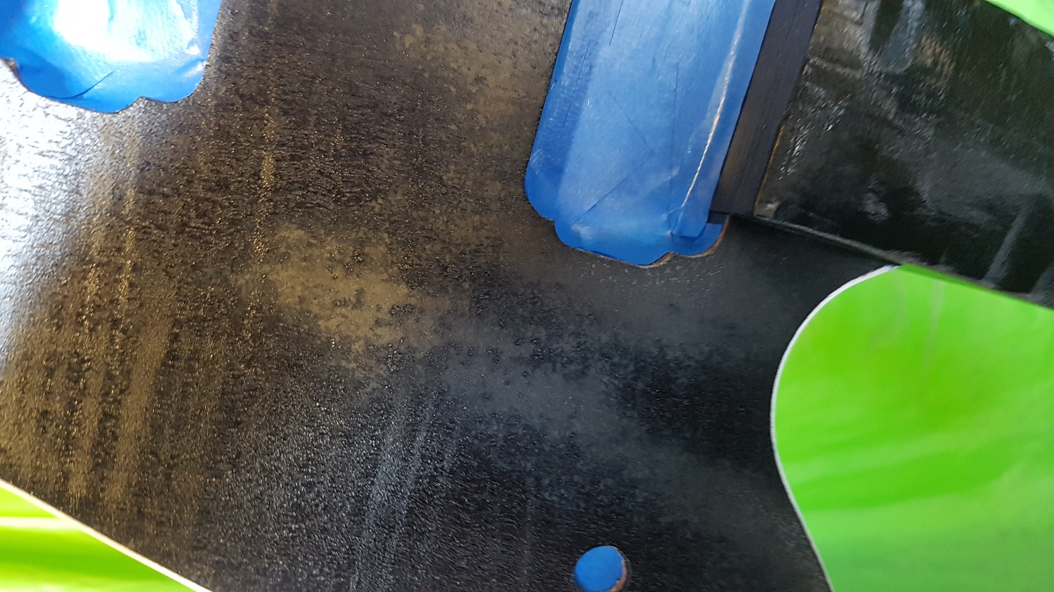

3 Attachment(s)
I've had a look this afternoon. After a wipe most of the clouding/white patches have gone, though some are still evident.
Attachment 32178Attachment 32179Attachment 32180
Photos A & C were taken a couple of hours after spraying. Photo B was taken today (24 hrs after spraying) after giving the guitar a wipe.
The paint, stain (the maple veneer top was stained) and clear coat are all compatible according to the luthier supplier I bought them from.
It's looking a lot better today.
Thanks for your help.
