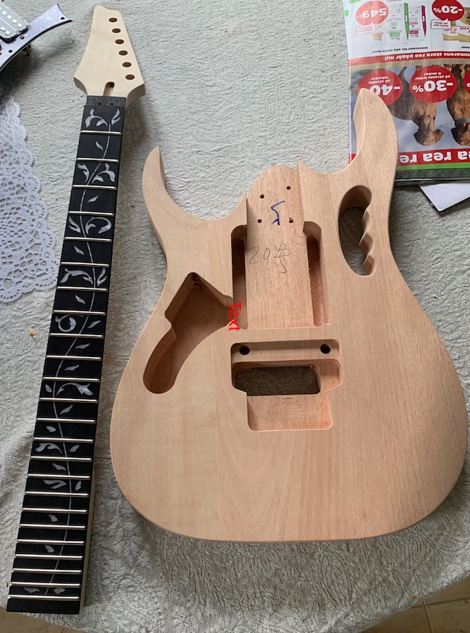

Time to start on my SV-1 LH project
It took a good while before delivery as it was some custom changes done.
Missed some parts while unpacking but they were shipped asap from Pit Bull, fantastic service i must say.
Anyway, mock build done, and painting will be next step as i still await a new pick guard.
Would be happy with some input in how to set neck correct as there is no stop in the neck pocket.
Attachment 31783

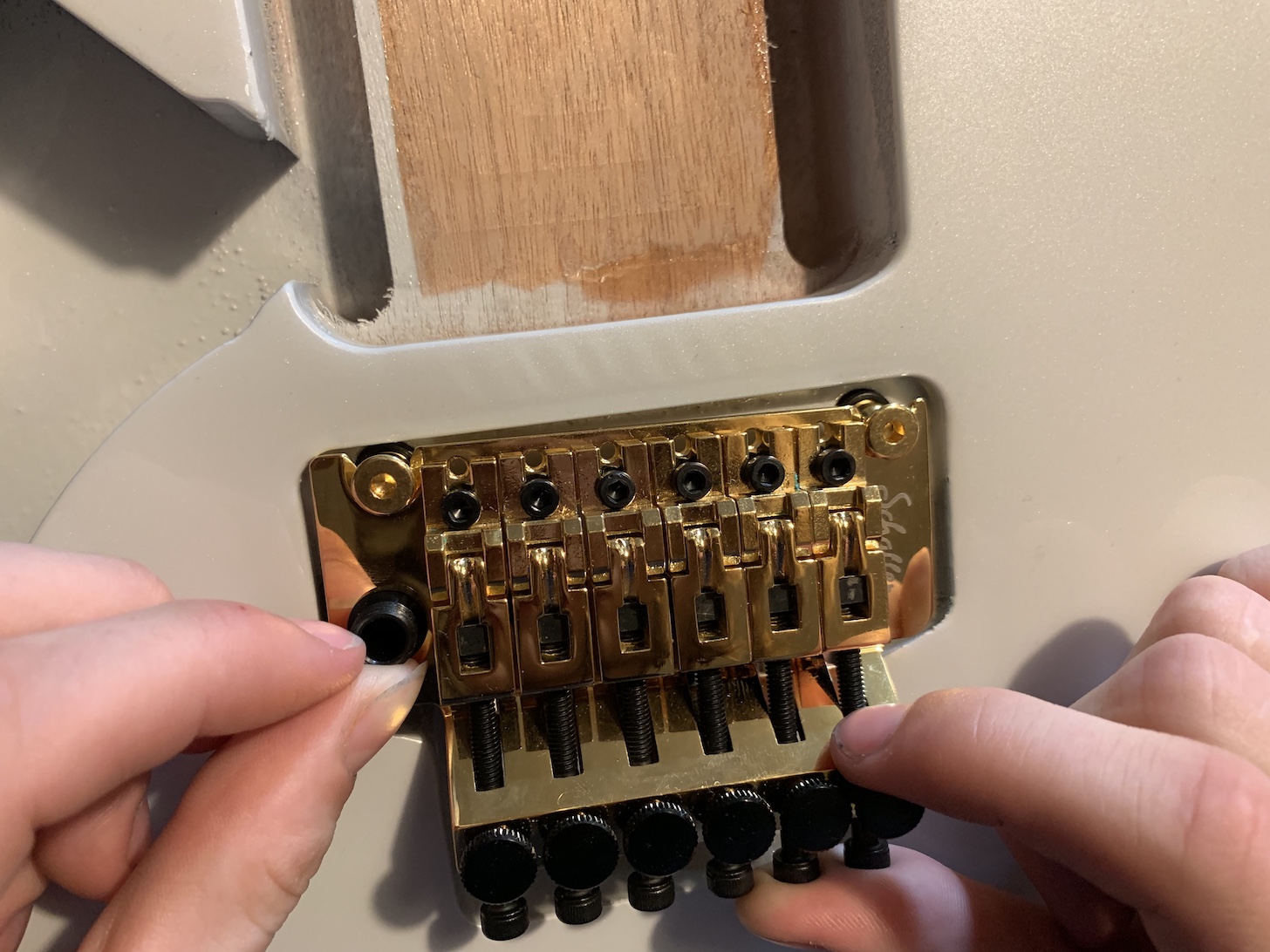

This is kind of bad, missaligned holes for the brige make it look... Hrm not so good. Annoying i would say.
Any ideas if something can be done to make it look better?
Attachment 31958
Attachment 31959

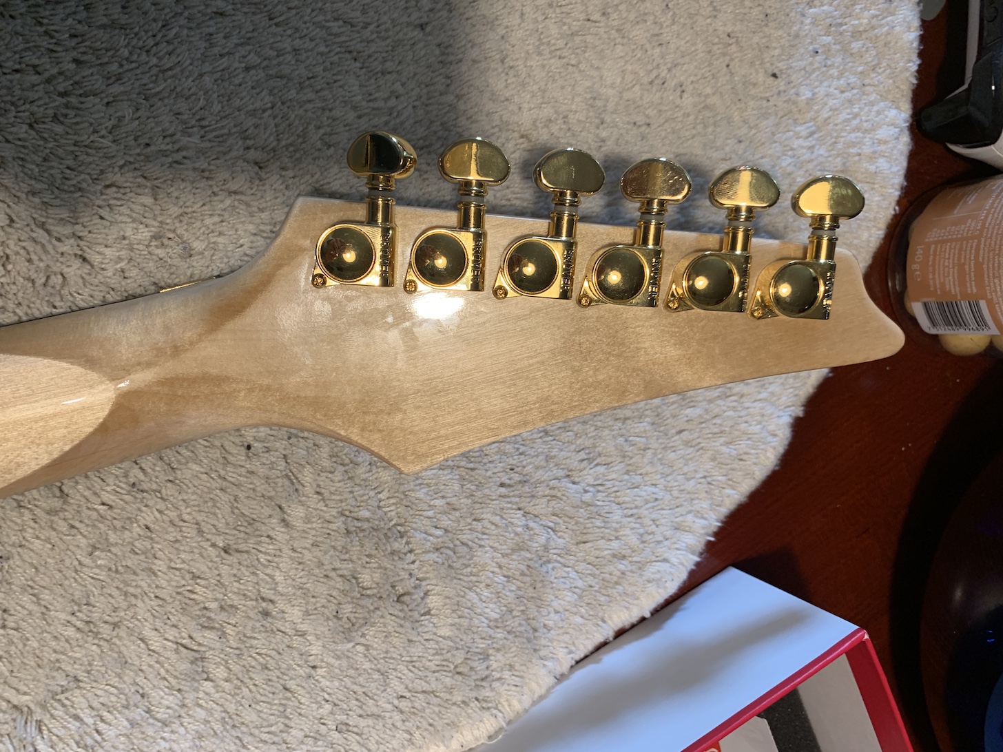

Head come togeter nice.

Not a lot you can do with that now the finish is on.
The fix would have been to plug these and mark out for re-drill based on a standard length, see the attached link to the stew Mac calculator, it will give you the required distance from nut for these stud positions.
https://www.stewmac.com/FretCalculator
Enter the values for 647.7mm scale length and 24 Frets and you can check how far out it is.
Have you reshaped the neck profile? It looks fantastic, really excellent work mate, well done!!
