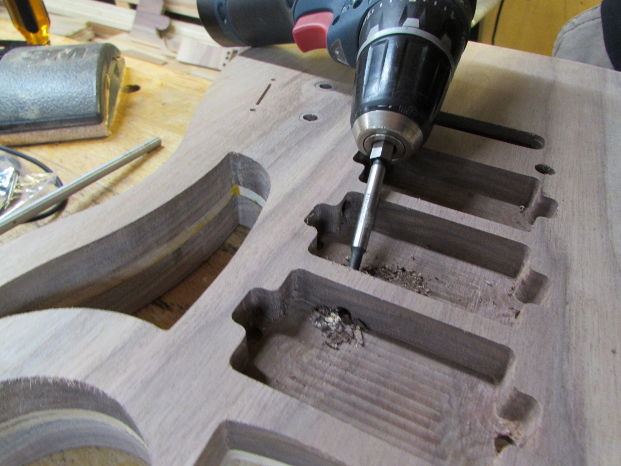

Ok so you’ll need a hole that connects all pickup wires to the one area, a path basically. Like this.
Attachment 31391
And then you’ll need a hole that goes from the bridge insert hole to the bridge humbucker cavity. Like this.
Attachment 31392
Then, you’ll need to to drill a hole that goes from bridge humbucker cavity to your control cavity, like the second hole in the image above.
This can all be achieved using standard size drill bits, just as long as you position the drill at the appropriate angle. The holes don’t need to be massive, just enough for the wires to feed through.
