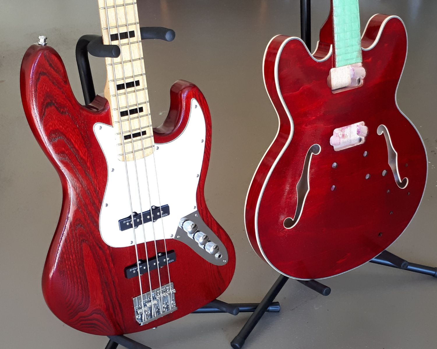

I am going for a pretty dark red and want the grain of the flame maple veneer to stand out. It's the TL-12F body. Some examples:
