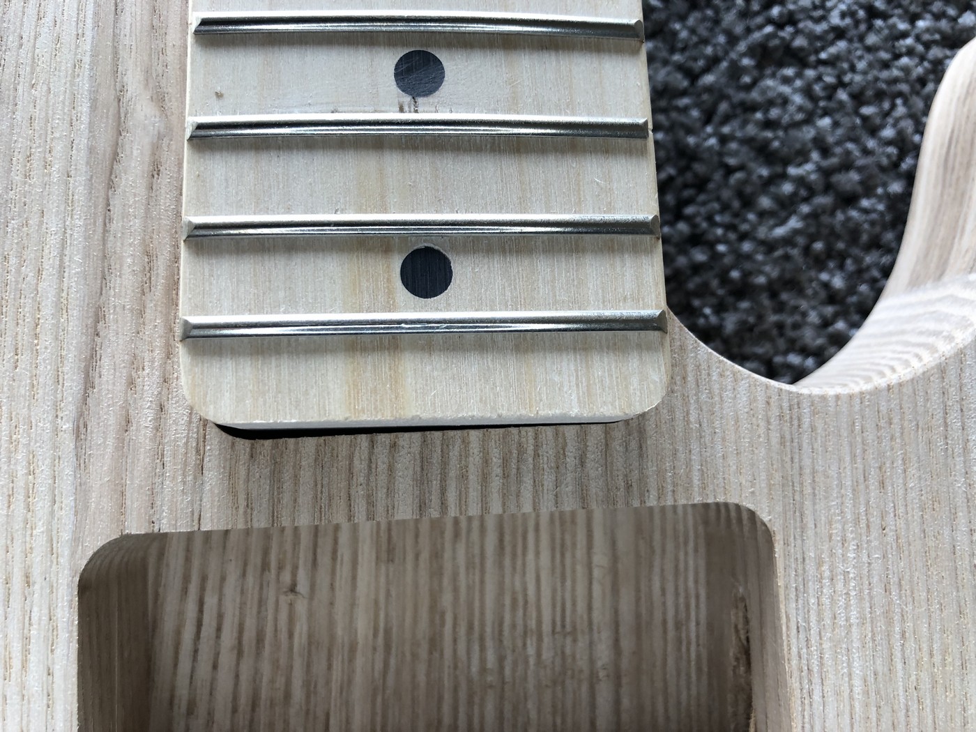

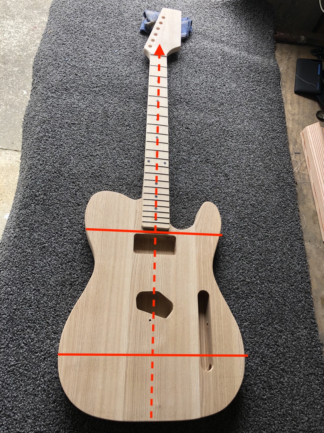

The way the neck sits in the pocket will determine the centreline that the bridge will need to refer to, so it is important that the centreline of the pickup routs matches the centreline of the neck by within a mm or so. Whilst you can move the bridge about a bit, you can't move it side to side that much as the bridge plate only just covers the bridge pickup rout at the sides; you don't want a hold showing.
However it's the sides of the neck pocket and the sides of the neck heel that will really determine how well the neck points down the centreline of the body, not the heel shape. It's just nice to have as much of the end of the heel in contact with the body as possible for string vibration transfer.
I modified the end of a neck of mine to fit the pocket better by just using chalk on the end of the neck pocket, pushing the neck up into the pocket, then seeing where the chalk marks were, as these show the 'high' points. Sand those high points down a bit and repeat the process until you've got chalk marks all over the end of the neck.
Obviously do this before you a) drill any neck mounting screw holes or b) mark the bridge position, as a) will mean that you can't really move the neck so that it sits tight in the pocket and b) the bridge position will now be slightly too far towards the neck than ideal, as the neck will be sitting that bit further into the body after the sanding.
