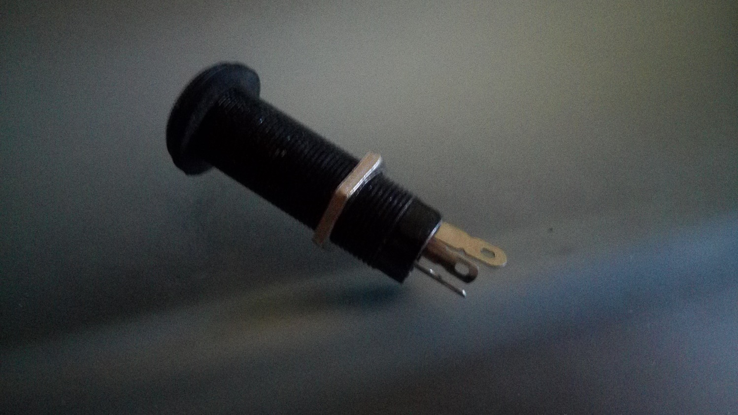

Finally, I have an output jack for stereo but I'm wiring for mono so which terminal don't I use?
** can we see a pic? I did this in one of my guitars, but the jack might be different

Here is the jack.Attachment 29361

Hmm, the jack is a bit of a tricky one. The large outer tang should be the earth. You may have to do some testing with it plugged into an amp to determine which of the inner ones is correct.

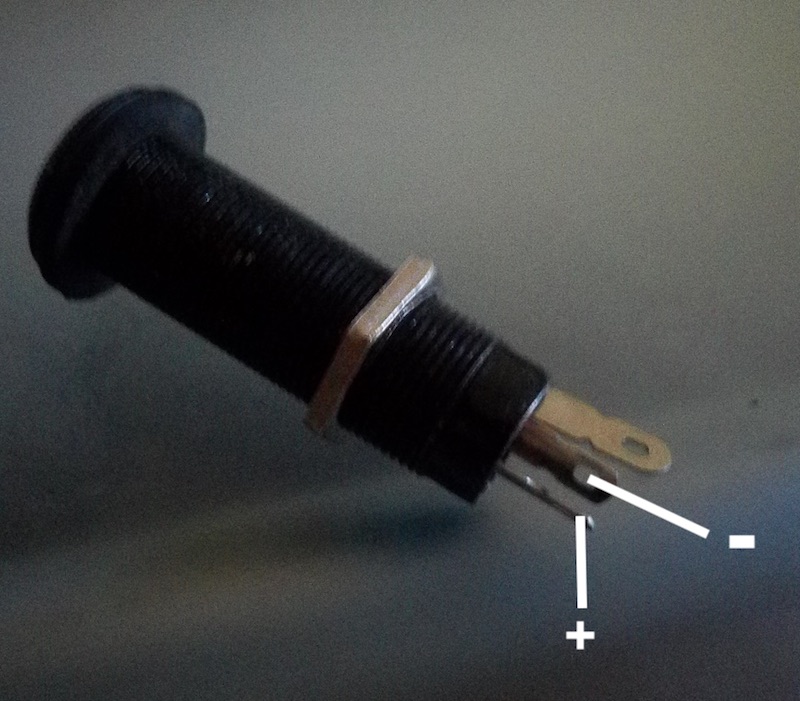

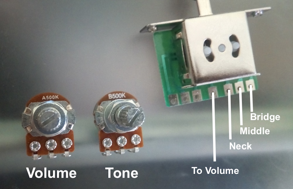

2 Attachment(s)
'A' pots are log/audio taper, 'B' are linear. 'A' are best for volume and either 'A' or 'B' for tone.
Attachment 29375
In the PBG IB-1 wiring diagram it uses an 8 lug switch with the centre two 'common' lugs linked with a wire loop. Your switch is a 7 lug version with only a single common, so you don't need the wire loop and just have to connect that single centre lug to the volume pot.
The stereo barrel jack that come with the kits can be tricky to wire as they can vary from time to time, and don't necessarily match the Switchcraft style lug layout. A multimeter is the best way to test which lugs are hot and ground (+/-), or just trial and error when you connect it. Usually these lugs are the ones to use (but it can vary between batches):
Attachment 29376
