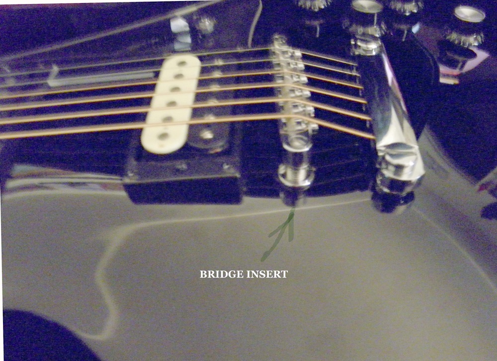

On several kits I have purchased from china the stud holes for the bridge have been out of alignment with the finger board, hence the strings are not aligned to the neck left or right. also the bridge is taller than necessary for the height adjustment of the strings. It is necessary to install the studs in order to see the alignment.

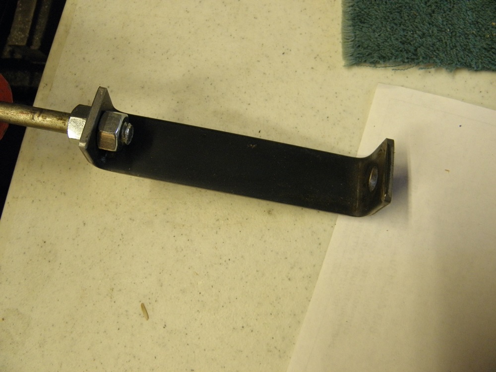

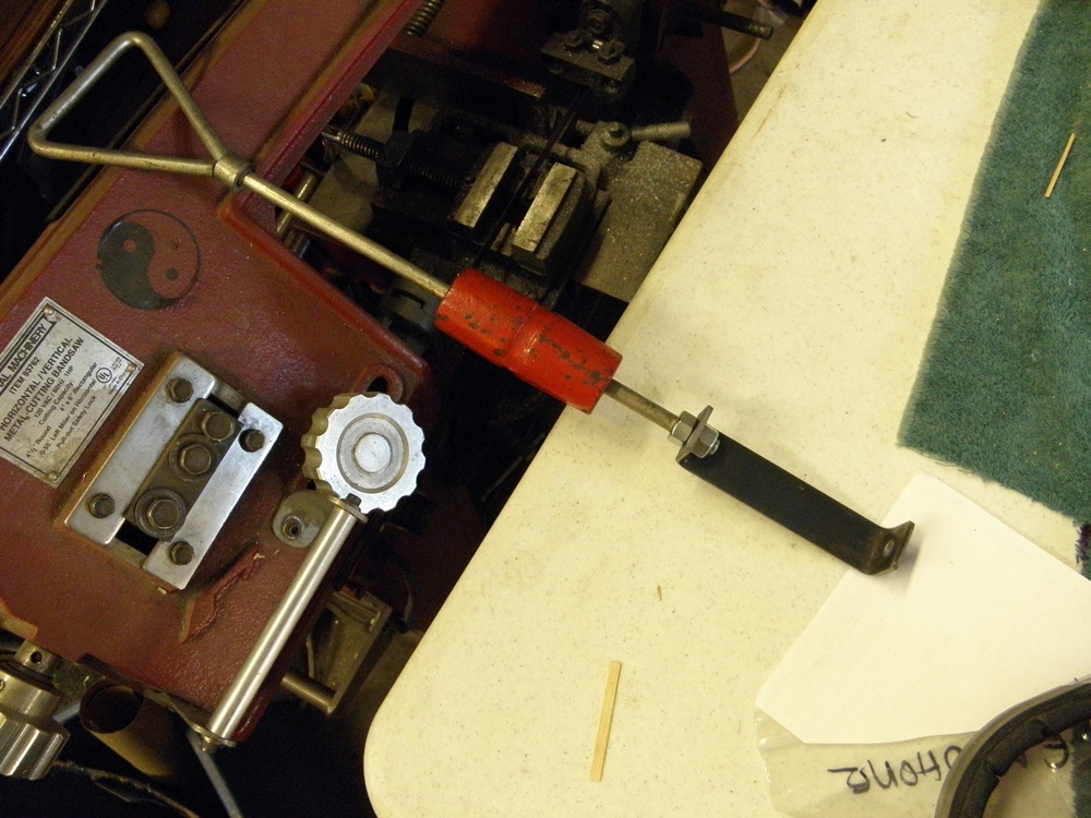

Now the studs are pressed fit in the holes and are difficult to remove if you need to to make adjustments for realignment with out marring the finish of the guitar face. here is the back hammer same as a dent puller.
