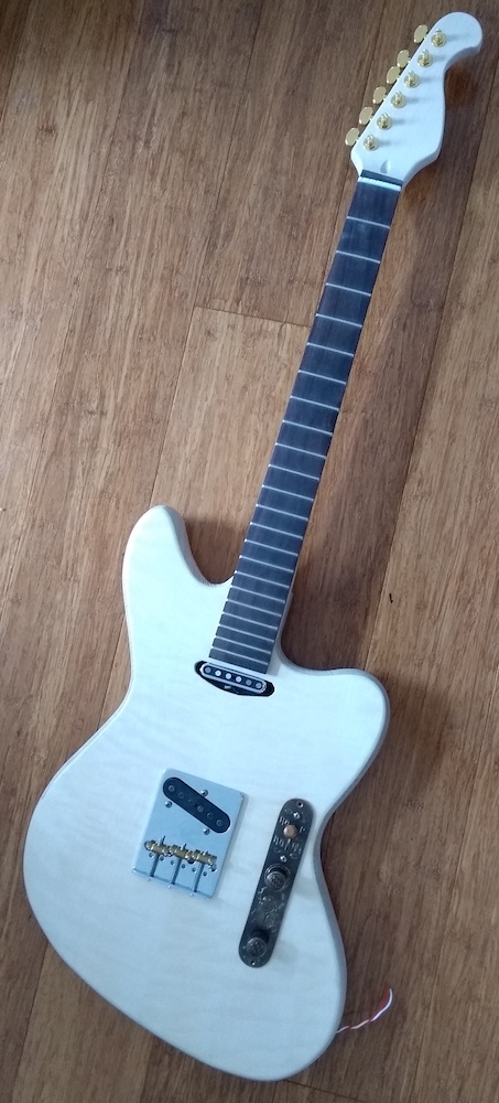

* A tele build into a Jazzmaster style body - Pitbull's JTL-1 with a quilt maple veneer
* Lindy Frahlin wired 4 way selector (neck, neck/bridge parallel, neck/bridge series, bridge)
* Fezz Parka tone wiring using a 15nf orange drop tone cap
* Push/pull switch on volume to unload the pickups
* 630V DC safety cap separates hardware from cable negative
* Australian hand wound Sliders Nocaster bridge pickup
* Q Pickups A3 in the neck
Whole thing finished in Dingotone blue with "hawk" headstock and custom hieroglyphics control plate and neck inlays.
Kit has arrived and I'm sanding
... and sanding
... and sanding
... and sanding
not the veneer though. I'll only do that once with a light touch 400
