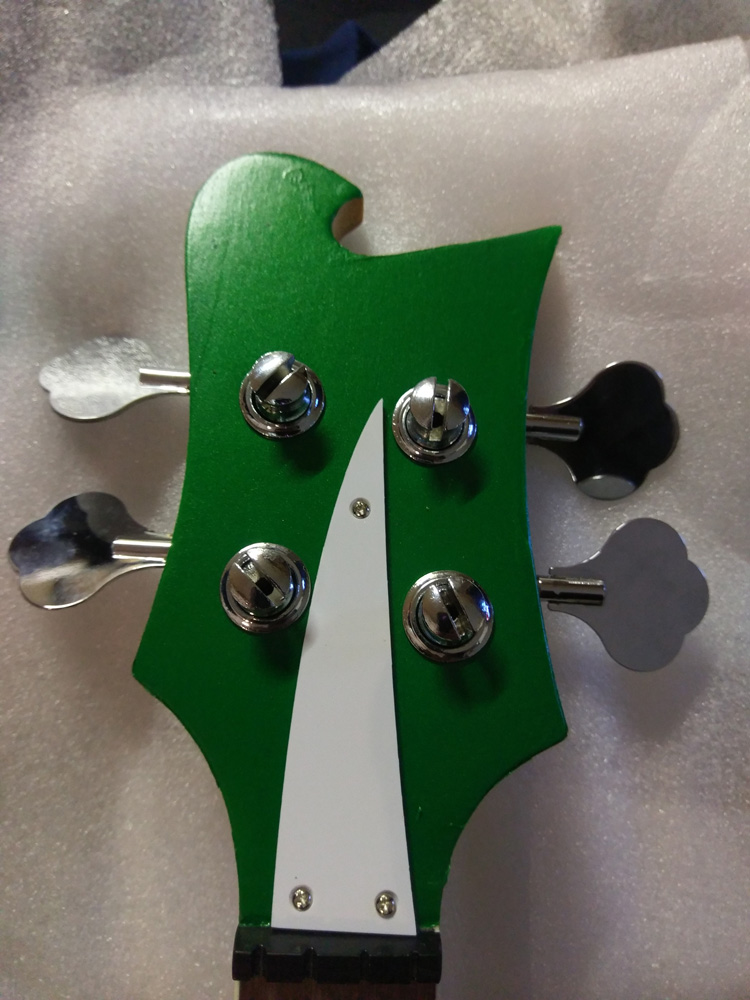

I'm building my first bass, after a long time deciding to do it, Pitbull had sold out so I got one from The Fretwire.

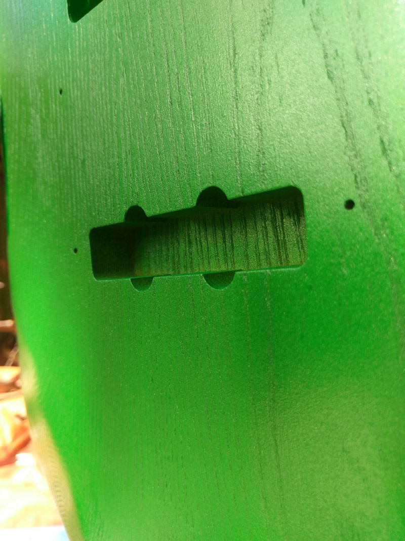

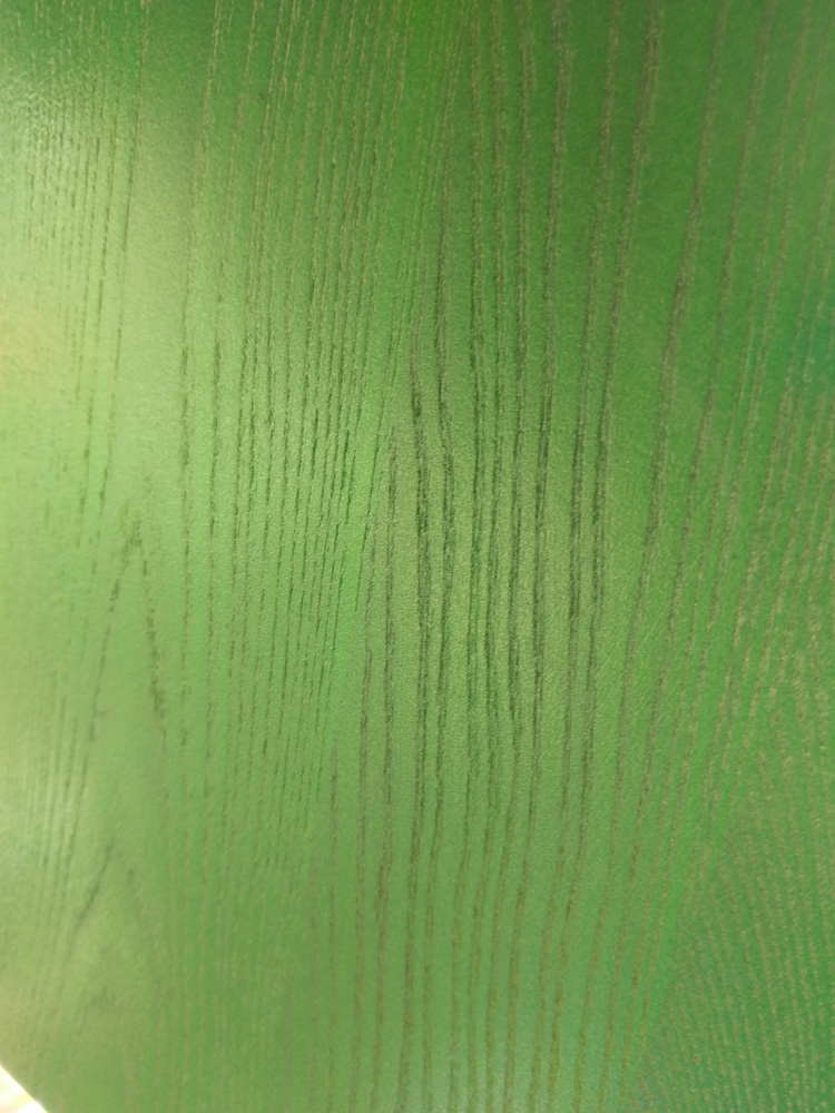

I've gone for green, and wanted to see the grain through the paint.
I got my selected colour of Ford paint and got a spray can made up with 30ml of green, 80ml of clear.
It looked good after the first can, but not good enough.
I got another can and made this 40ml green, 70ml clear.
I put two coats of Satin clear over the top, but I'm going to have to do something better. And thicker.
I did the neck and back/sides of the headstock in Rustoleum Satin clear. The front of the headstock is in green.
Waiting now for my Pitbull neck glue to arrive.
