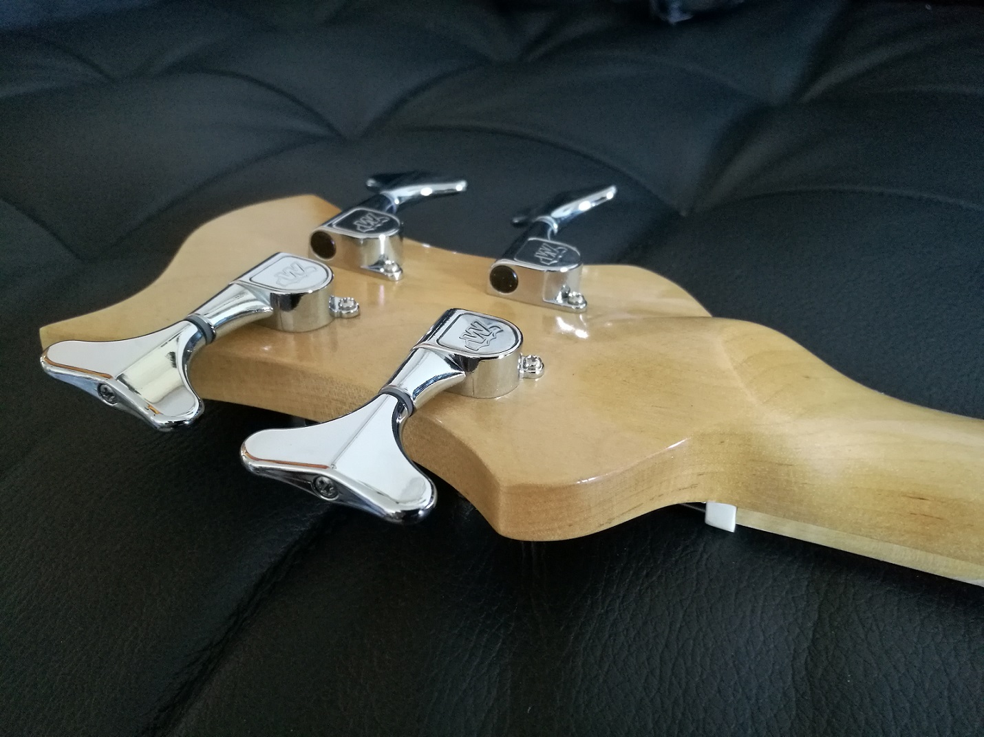

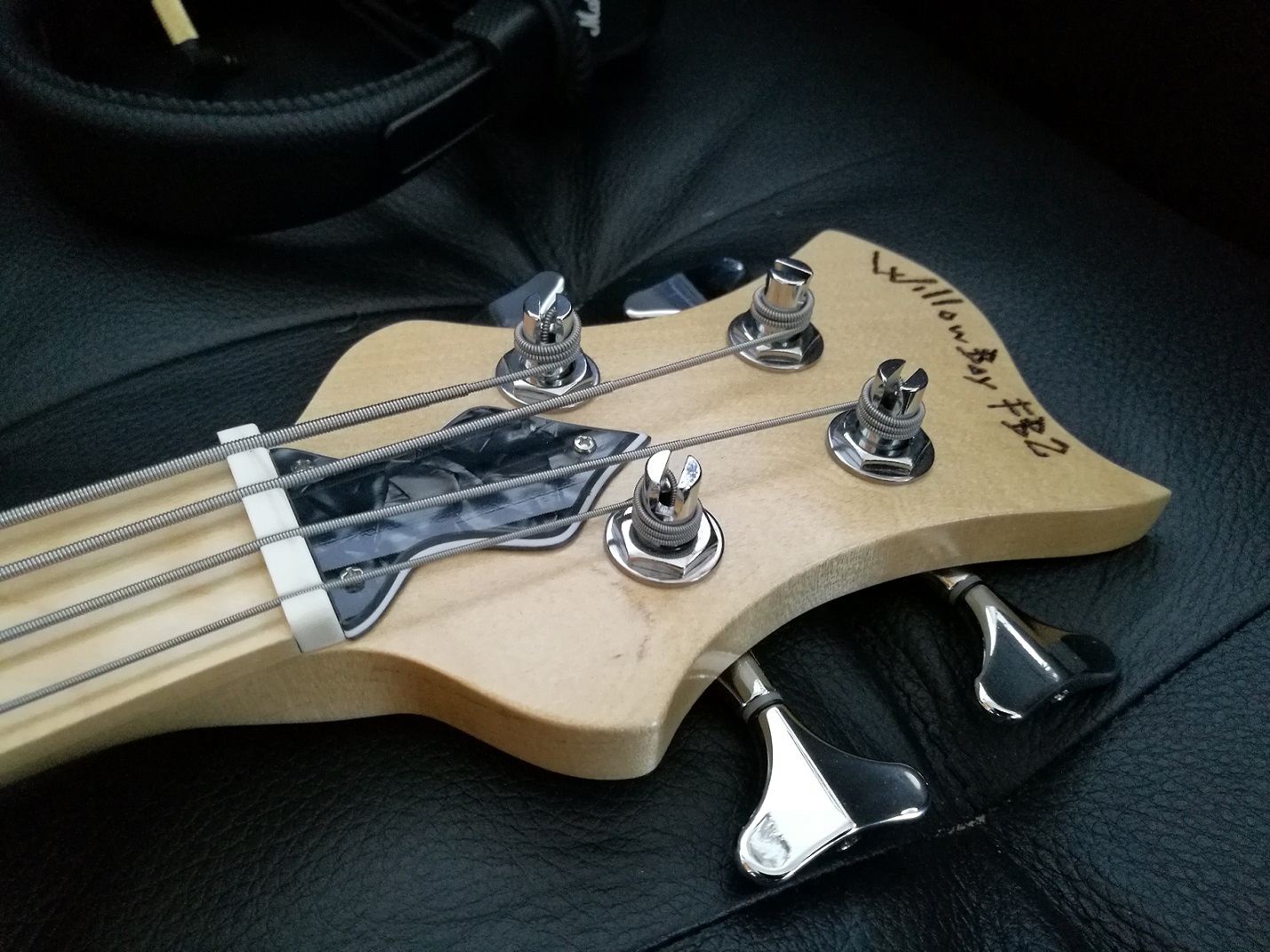

Anyways, since my main instrument is a bass, I finally got to designing my own. Always have wondered what the offspring of a Jazz bass and a Rick 4003 would look like. Then I started to draw free hand with help of just jazz bass measurements.
Made the upper horn 2cm longer since the jazz feels a bit neck heavy. Also chose the tuner configuration of a Rick to balance it even more.

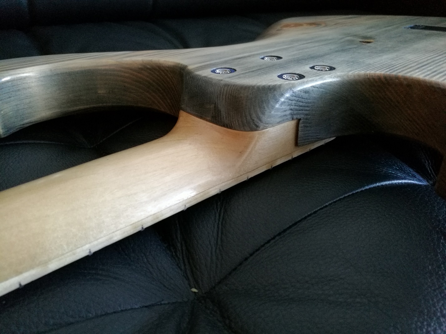

Since almost everyone said that pine and birch are bad choices for tonewood - I stubborn as I am chose to prove them wrong. Made these for myself and my cousin who supplied the pine from his own yard. All domestic wood and two most common firewoods here. Wanted to make something that would look good hanging in an old log cabin. Would love to try out some Aussie woods for builds but can't get them to Europe.

* Body:pine dead while standing (hence the natural gray color in the middle)

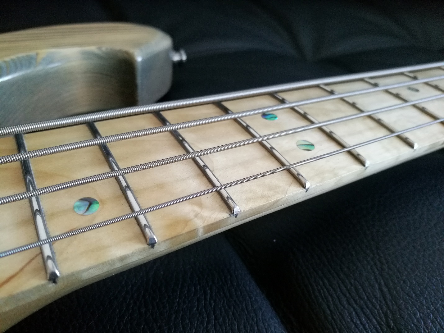

* Neck : birch from a carpenter wood supplier
* Fretboard: flamed arctic birch found from back of my father-in-law's garage

* Wilkinson tuners
* Abalone dots and black plastic side dots
* Jescar stainless steel frets
* Bone nut
* Schaller 3D4 bridge

* Body water based mild gray stain sanded off topped with Tru Oil
* Neck treated with Tru Oil

* the neck is a hybrid between a jazz and P neck. 40mm nut width and P profile from 5:th fret up. 21-23mm thickness.
