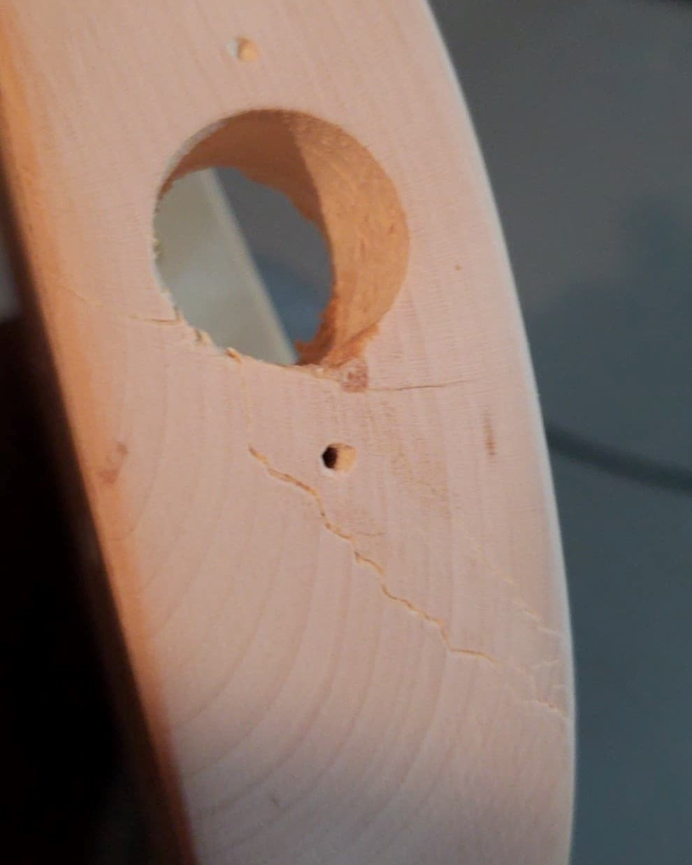

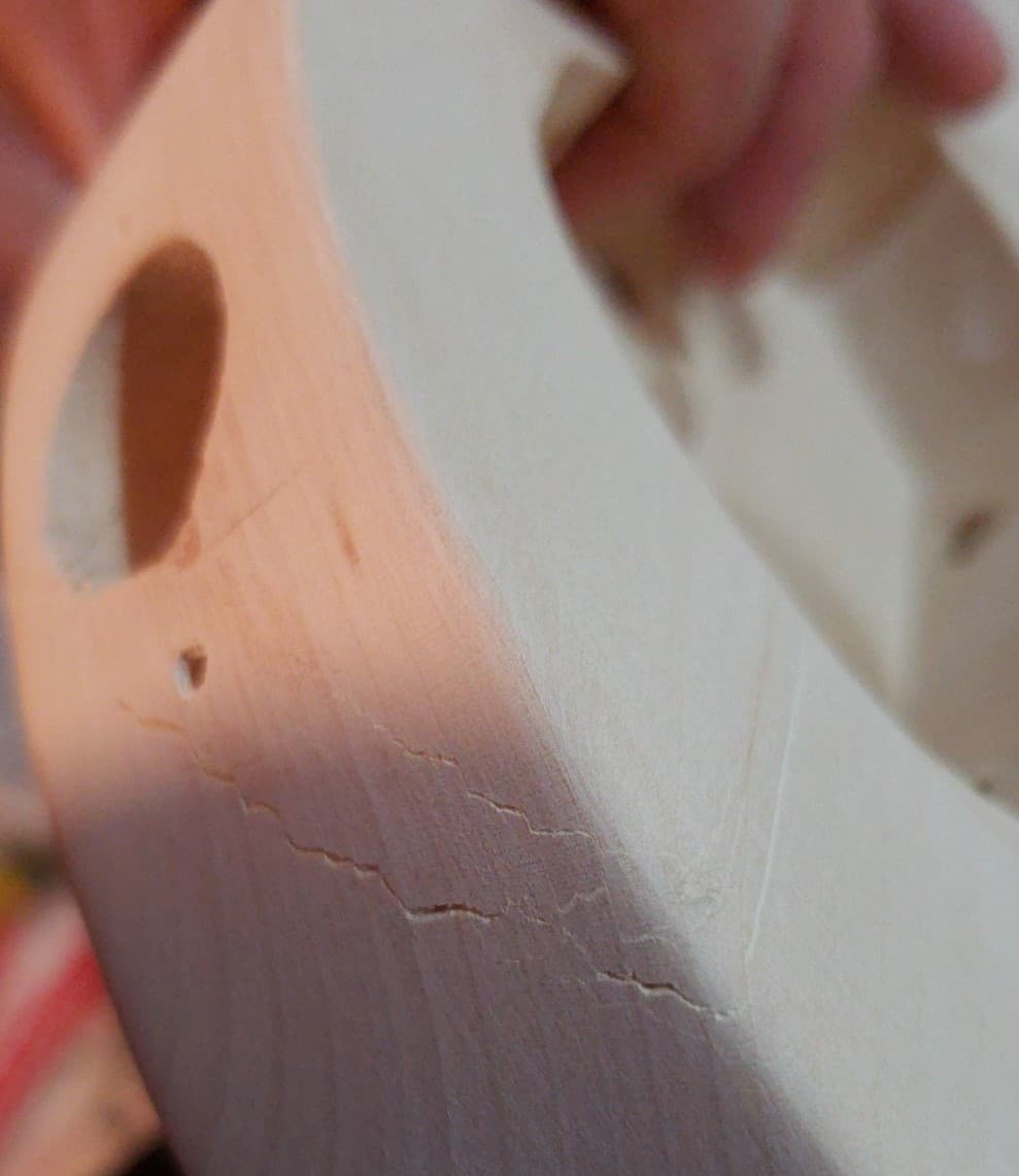

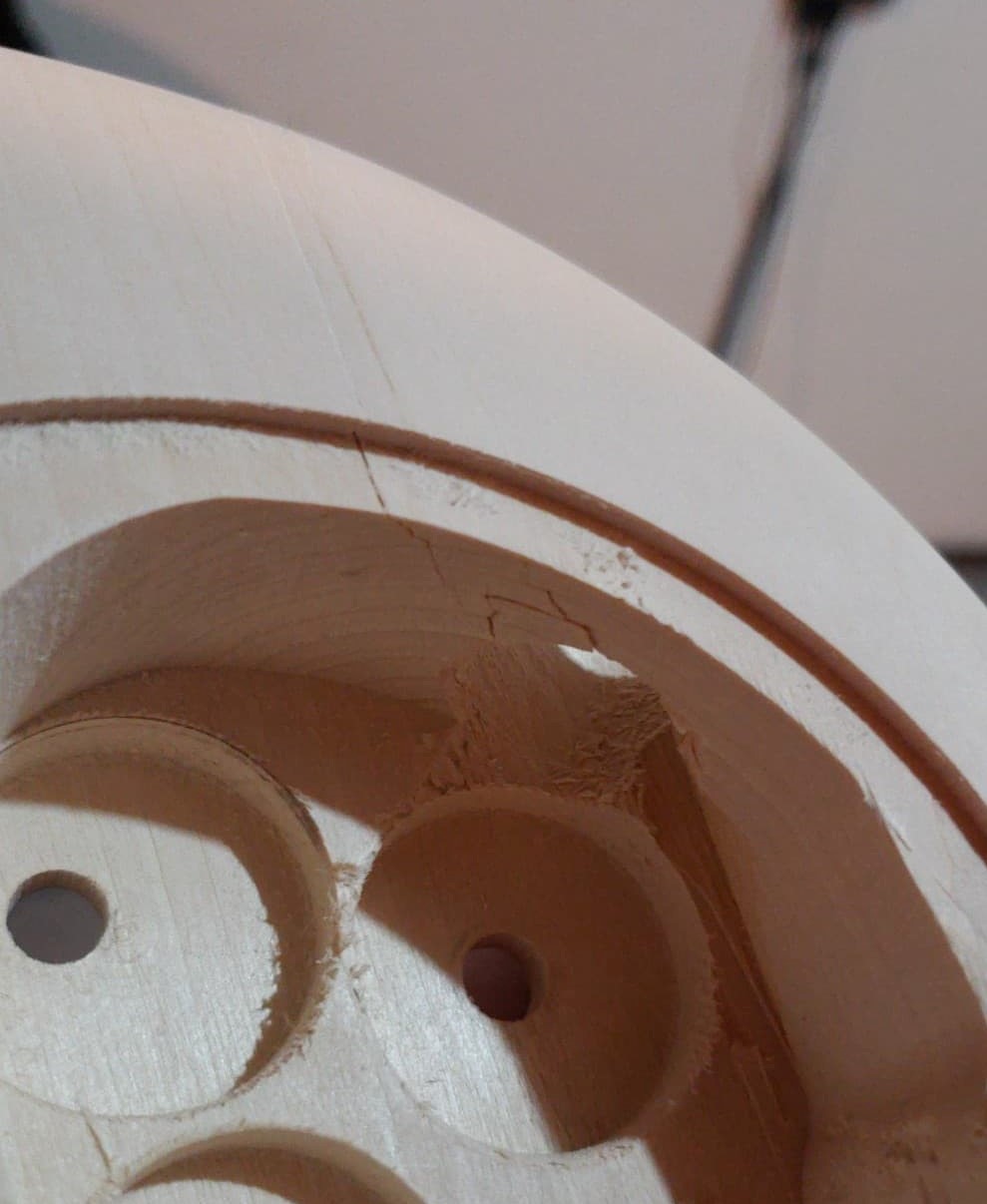

Day 1, the dry fit and mock build went great with some minor sanding required for neck fitment. Day 2, after disassembling, I started sanding the body, 120 to 180 to 240 and had it ready to start finishing. Day 3, I find the body had cracked from near the 1/4" jack cutout through to the back of the guitar to the electronics bay cutout. Looking back at the pictures (have been taking lots for a build diary) the body was not cracked the day before.
My best guess is the humidity/temperature change from wherever the body was in Australia to here in the Canadian parries was too much too fast for the wood to cope with.
Attachment 28295
Attachment 28296
Attachment 28297
So going from here, i'm thinking sanding some more in order to build up a bunch of sawdust in the cracks, then hitting it with thin super glue from inside the electronics bay such that it flows through the sawdust and crack to the outside of the body should hold things together. I'm planning to finish the sides and back with an opaque finish so I'm not too worried about the wood in that area not taking stain. The face and the veneer seem unaffected.
Is there a better way to repair this? should I wait on the repair to see if the wood is going to settle and crack some more?
