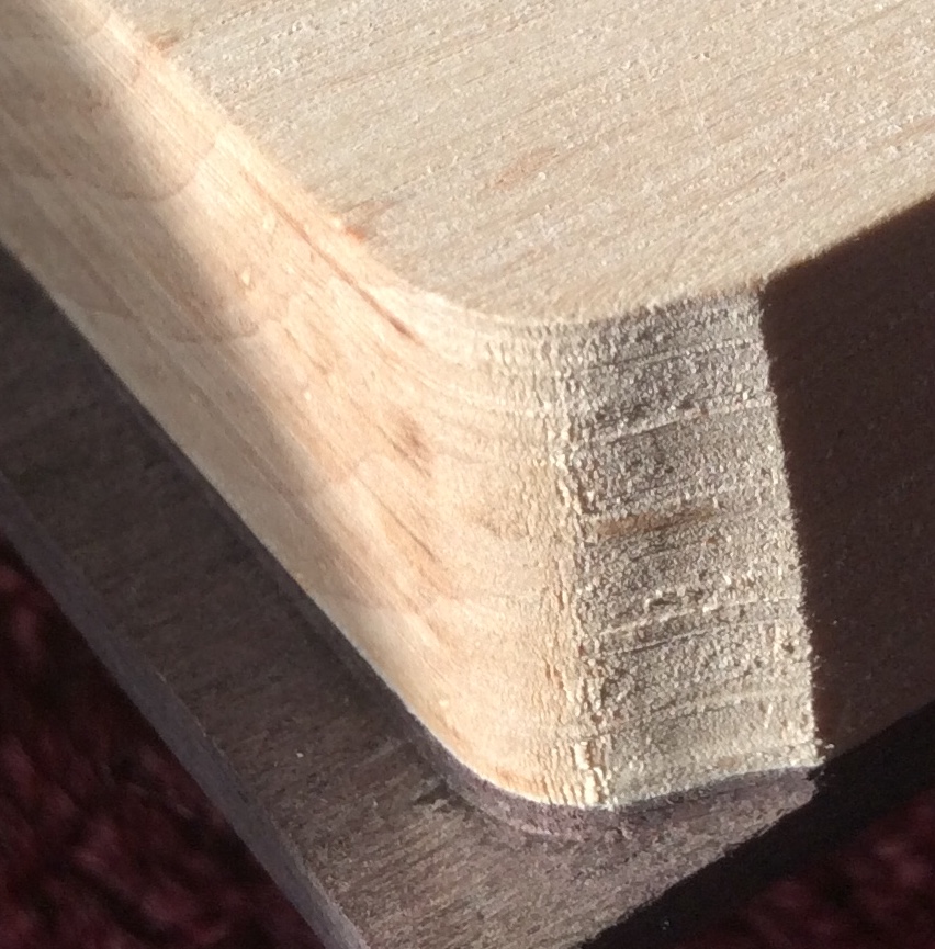

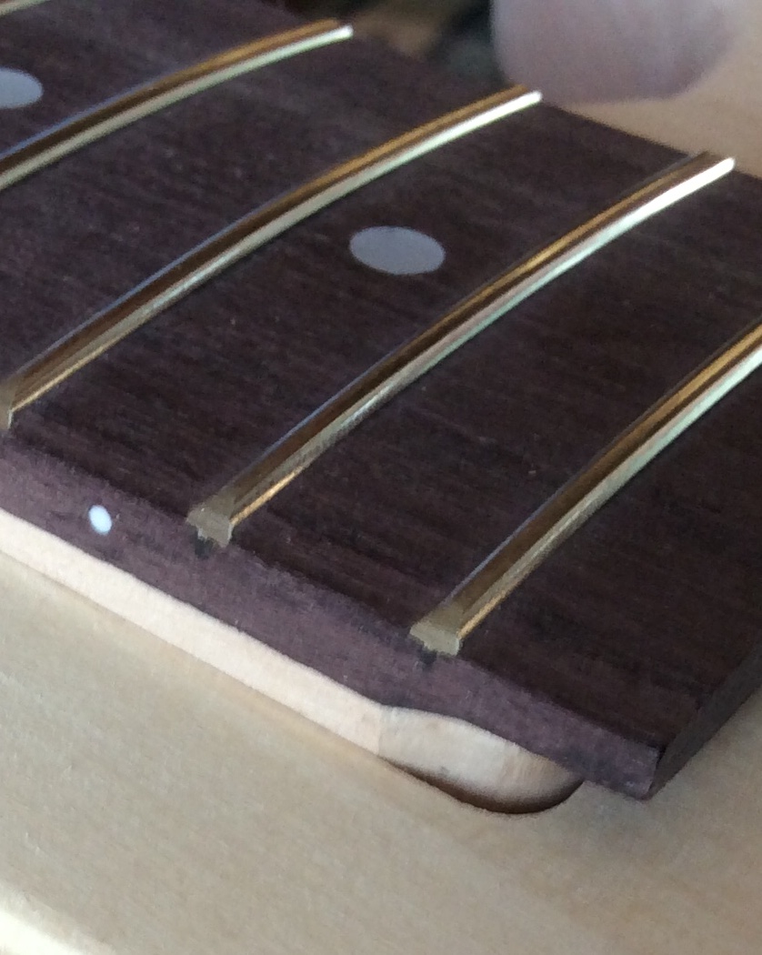

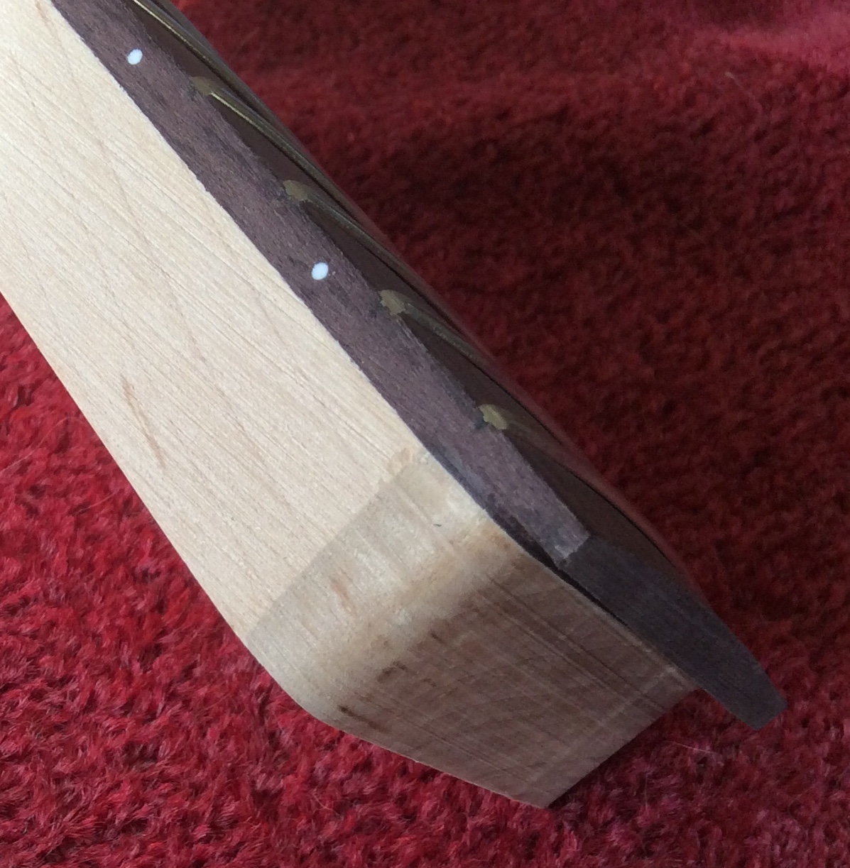

Hello Again
Well the dry build build went okay......ish. Discovered a couple of issues, first one is that the drilled holes in the body don’t align with the holes in the neck mounting plate which is weird as they are the only holes drilled into it and secondly, there is a router mark in the heal of the neck where it fits into the body that you will be able to see when it’s all mounted up. Wondering if anyone has had similar problems or if I am just incredibly lucky.
Any ideas to fix them?
Other than that, the kit is good, well put together and nicely finished with quality joints.

Hi Dolphinboy, if you can post some photos as that always helps us understand what you are dealing with.
Cheers, Waz
Attachment 27617Hi, yeah good point, ::)
Attachment 27618
Attachment 27619
Suggest sending an email to Adam as that neck heel issue will remain visible.
Hi
Thanks for the advice Wazkelly. I had wondered about filling and sanding back to match the profile but sort of concerned that the join would be obvious particularly on the top face and as it is going to be stained, would stick out.
I will flick him a msg.
