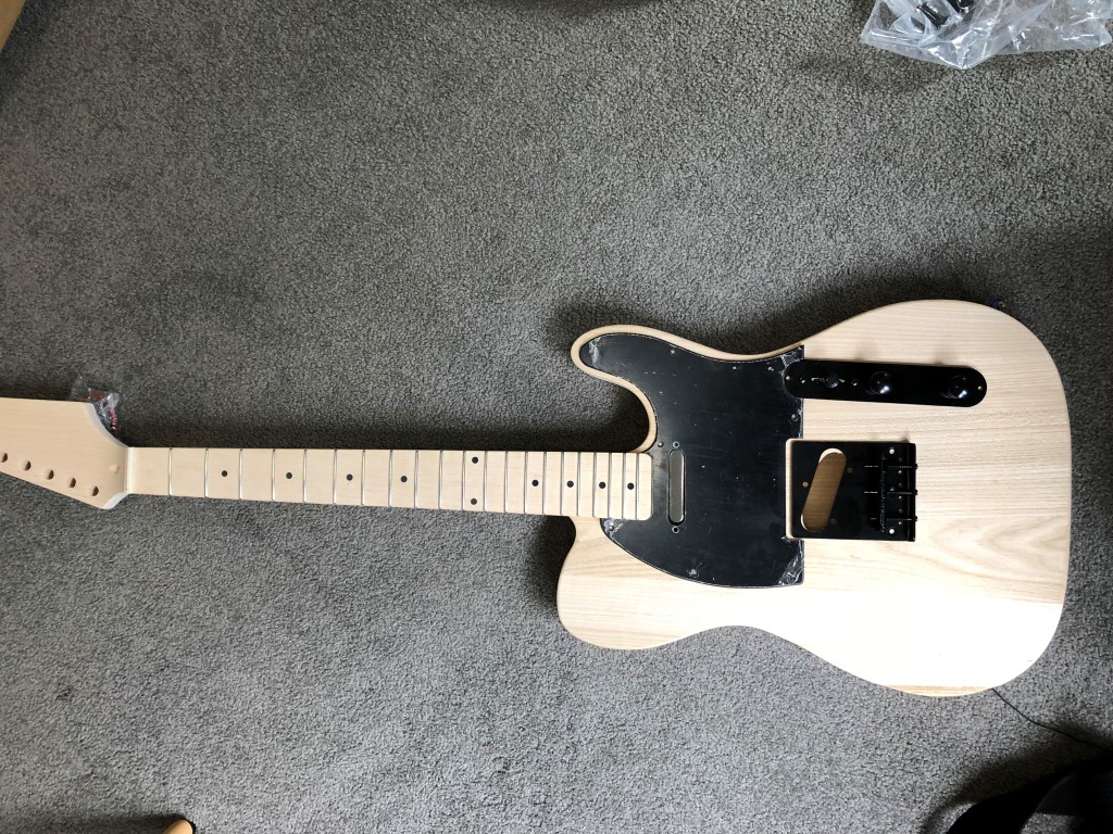

I did a dry fit this morning. The scale lengths seems good with saddles in a neutral position. The tuner holes are in a straight line. The neck fits the body well. The joint is almost tight enough to lift the body on its own. A couple of issues however:

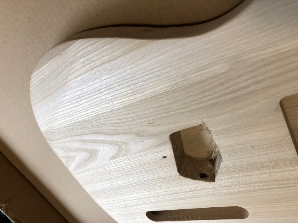

1. The tonerider bridge pup doesn't fit the bridge cavity
2. The bridge cavity needs to be brought forward I think for the bridge to fit snug against the pickguard (will depend on the scale length though obviously but it appears that it should still be OK)

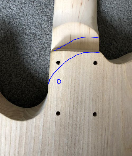

3. The holes for the neck screws do not align with the neck plate, and are slightly skewed relative to the centreline. Hopefully changing to bushings will not be as noticeable.
So it seems i will need to do a bit of work around the bridge pickup cavity, which I think has been a common problem with the TL kits judging other posts. I will do a glue check tomorrow, but there doesn't seem be any other issues with the joints.

1. How much material would be safe to take off the neck heel? I will be staining the guitar and I don't want any glue lines visible, so I can't fill the existing hole and glue it. Therefore i was thinking I should cut out the entire top left screw hole. I would also like to carve the neck itself so that it matches a bit better and is a bit more comfortable.
2. What is the best way of finding the body centreline? Fit the neck and run a line from the centreline of the neck?
