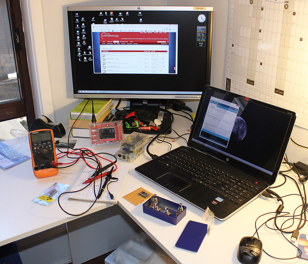

Well I got off my corpulent backside and ducked down to Jaycar to get the bits I needed.

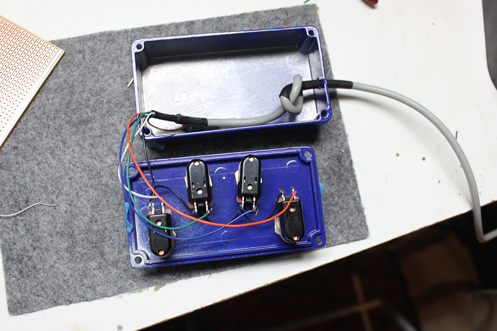

It is a footswitch array with a micro-controller to send commands to RiffStation to control the transport commands while my hands are occupied with a guitar.
The pedal is built.
The micro-controller assembly is in its housing.
Just fussing with the coding. To be honest it isn't that difficult but like most of us my memory ain't what it should be so relearning C++ is a bit of a strain.

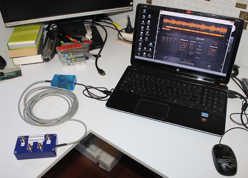

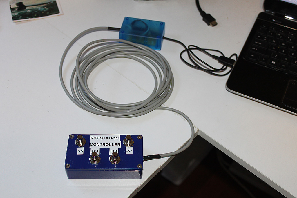

Riffstation Controller v1.0 is together.
Well it was easier than I thought.
For those who are interested it is based on a Pro Micro micro-controller (ATMega 32U4) which sends key stroke info via the USB port to Riffstation.
I have four control switches Step Back (<<), Return to Start (|<<), Pause/Play (||/>), Step Forward (>>).
Compiled in the Arduino IDE.
If anyone wants the code, just ask and I'll post it, well I'll tidy it up, add comments and post it :)
