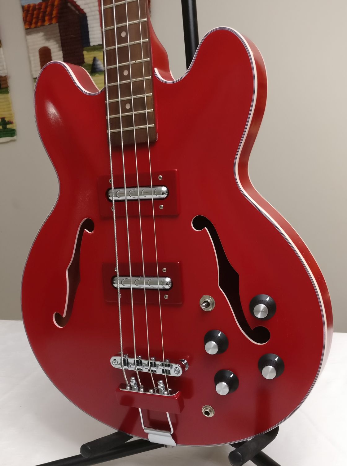

Good comments Fender3x.
The ply under the flame veneer on my latest project has a couple of small burl marks here and there which don't bother me and actually add a bit of character however some others may want a more pristine canvas to work with.
Those ESB-4 kits look great but that 3 point bridge is not practical and agree that they should instead come with a Bass TOM, something like the one on this example....
Attachment 26422
Cheers, Waz

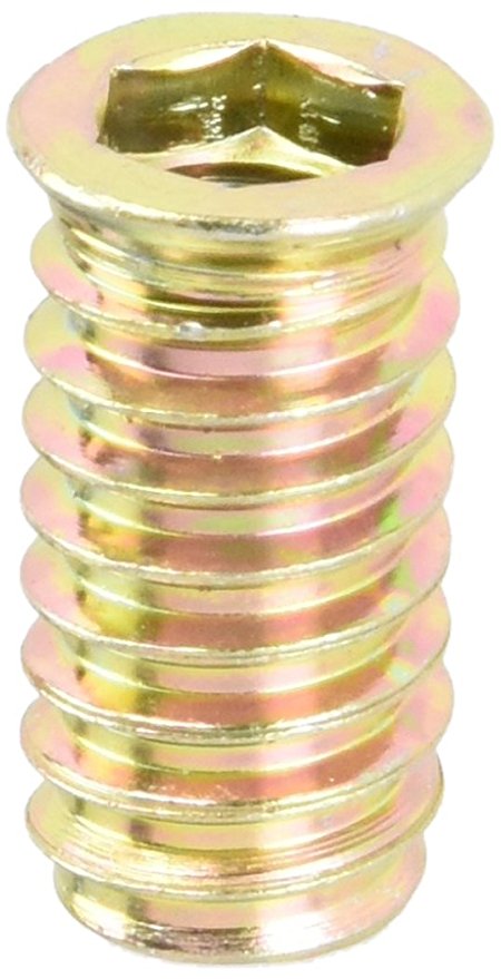

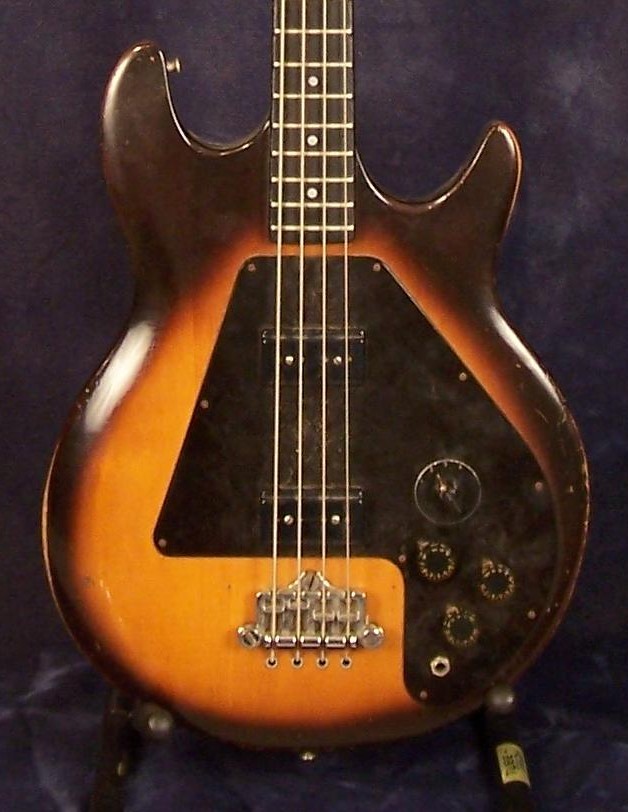

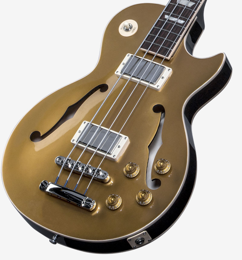

3 Attachment(s)
That's a good option. I did something similar with mine, just fashioned a trapeze tail piece rather than stop tail piece.
Attachment 26456
...Or you could use these, rather than the bushings that come with the 3 point bridge:
Attachment 26458
This might secure the kit's bridge better, but requires a smaller hole than the the ones that come pre-drilled.
I also think this could be done with the original hardware:
Attachment 26457
This last one would require new drilling rather than re-drilling, but the placement of the holes is sometimes out of alignment.
If the kit came without drilling you could choose whichever option, and it would also be less likely that you'd have an alignment issues.
