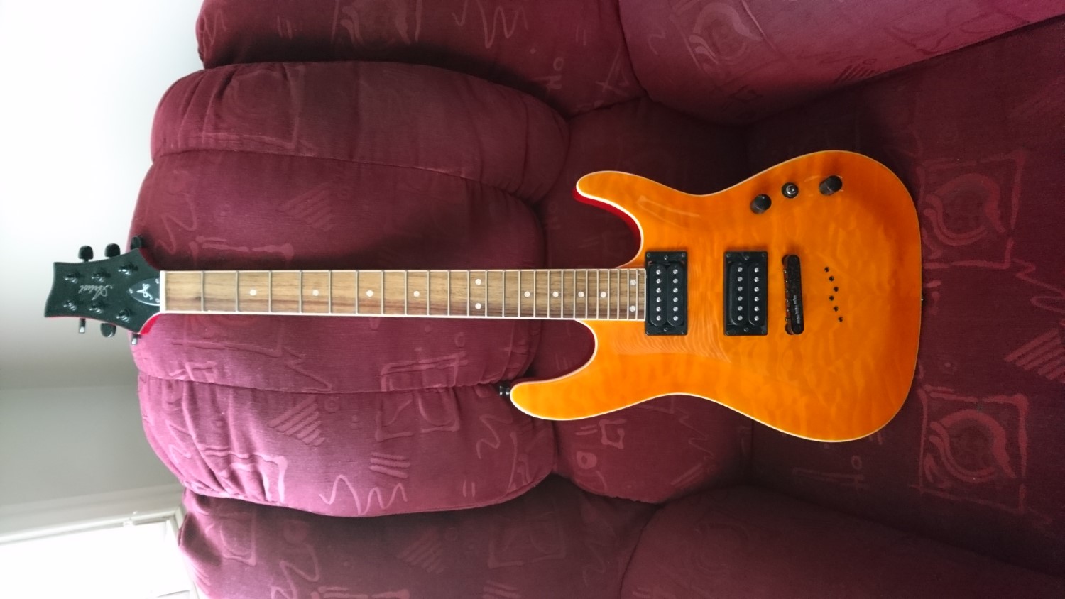

Good afternoon people!!
A good while back I asked around to see if somewhere had a cheap, dual-humbucker guitar that I could grab and have a bit of a much around with. Couple of guys here suggested Artist Guitars, and now I've finally gone and bought one. Arrived yesterday, but I was busy almost all day so didn't have much of a chance to play around with it past first impressions. But I will say, first impressions were pretty good.
Attachment 26297
Attachment 26298

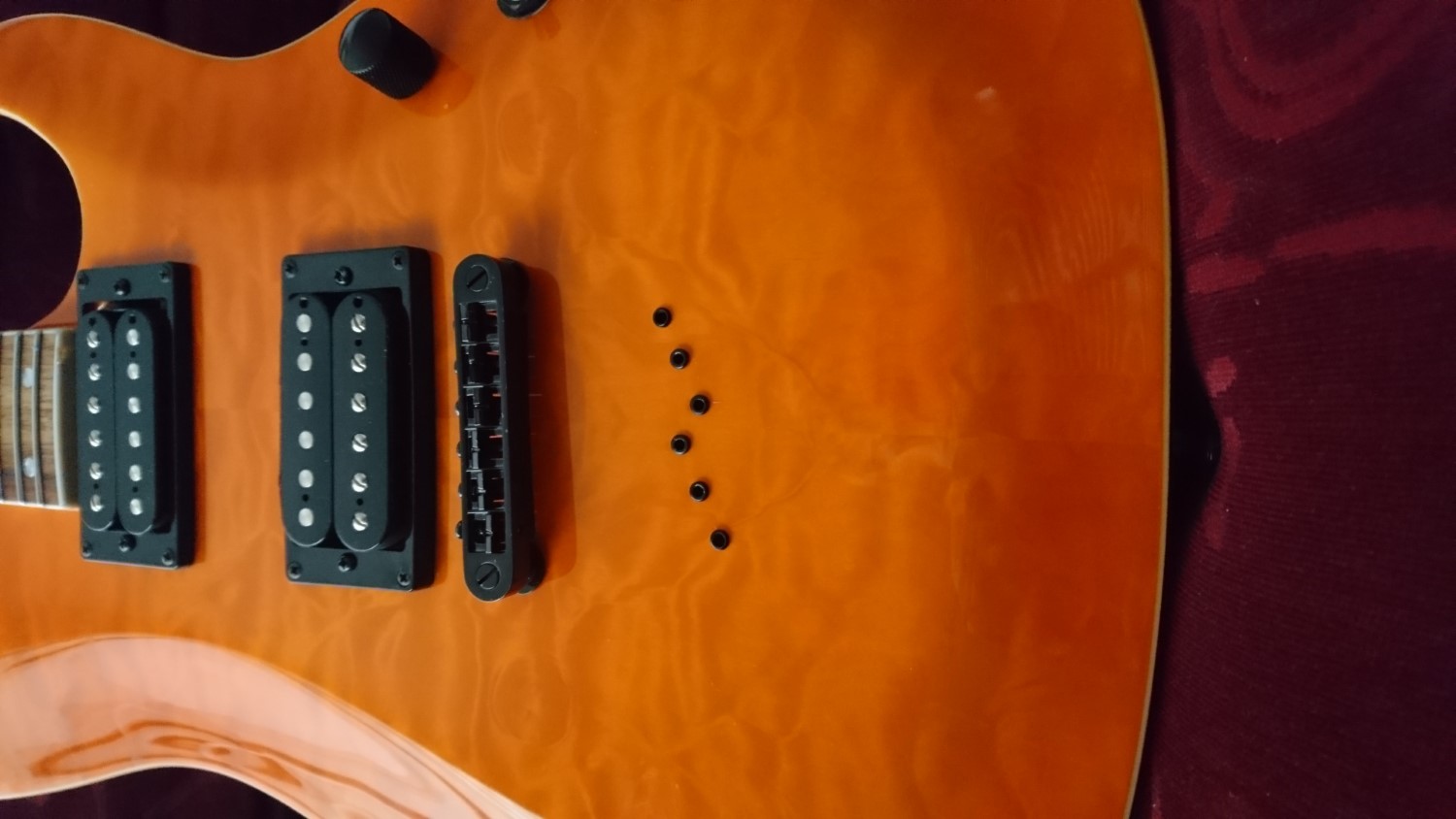

The colour is very nice, in my opinion, and it's a very nicely figured veneer on top. I was half expecting it to be photo-Quilt, but it's definitely real maple.

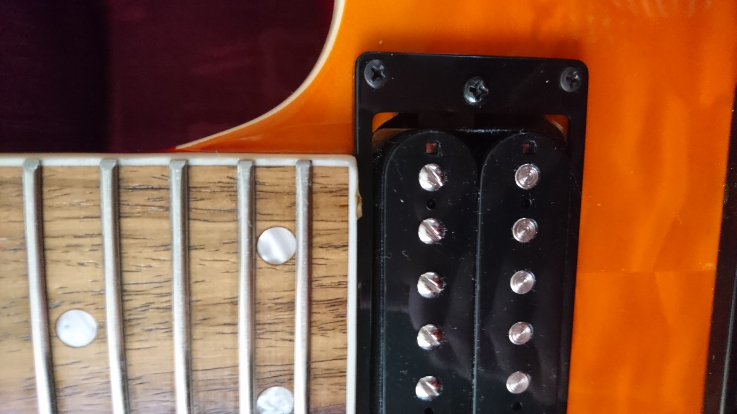

Now I did get a Factory Seconds one. Partially because it was 25 bucks cheaper, but mostly because they didn't have any brand new ones in stock and I couldn't be bothered waiting the month or two till they were expected back in. The 100-day no questions asked returns policy still applies to the Seconds too!!!!
So in terms of the flaws with it that would have made it a Factory Second? Honestly the flaws are pretty small and not noticable from any distance.
Attachment 26299
Attachment 26300

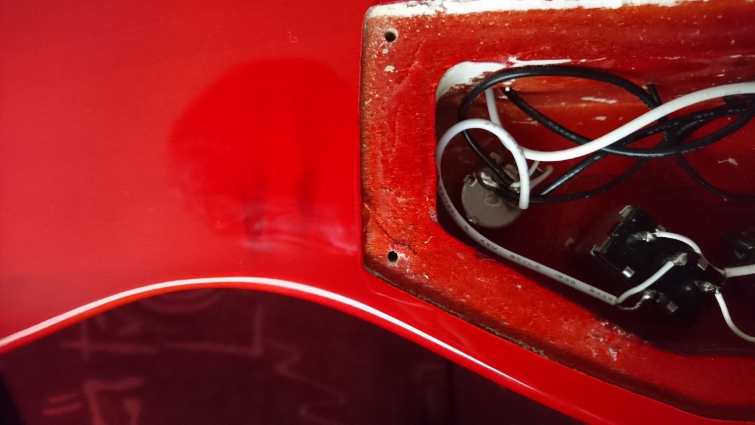

There was two runs of clear-coat, one on the end of the fretboard and one on the inside of the electrics cavity

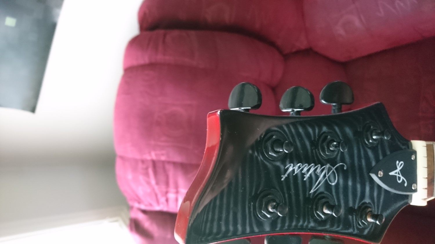

Attachment 26301
And a small chip in the paint on the headstock.
As well as a couple of scratches on the back of the body, which I couldn't really get on camera well.
Honestly, quite small stuff, and none of it puts me off the guitar at all.
Now, in terms of the rest of the guitar's quality. The guitar didn't come out of the box perfect, but hey it's from a warehouse I'm not gonna fault that too much. The neck had a slight backbow in it so I was getting a bit of buzz most of the way along the neck, and the tuning was out by a good chunk, but that's nothing that can't be fixed with some simple setup work.
Pickups seemed pretty decent in the bit of playing that I did. Nothing out of this world, but they sounded totally fine clean, and pretty clear while distorted, so that's all above board in my eyes. I did notice while I pulled the back cavity plate off that they are two-conductor though, so I will inevitably swap them out for something else if for no reason more than to add series-parallel switching. But I don't think I'll be in a massive rush.
On that topic too, the soldering work on the inside looked pretty damn neat! The wires are all a bit messy but I'm not one to judge on that front, my wiring jobs inevitably get the same way XD Pots are not perfectly smooth, just a tiny bit scratchy, but nothing awful, and the toggle switch feels quite solid (though the fact that it's part chrome while the rest of the hardware is black rustles my jimmies slightly)
