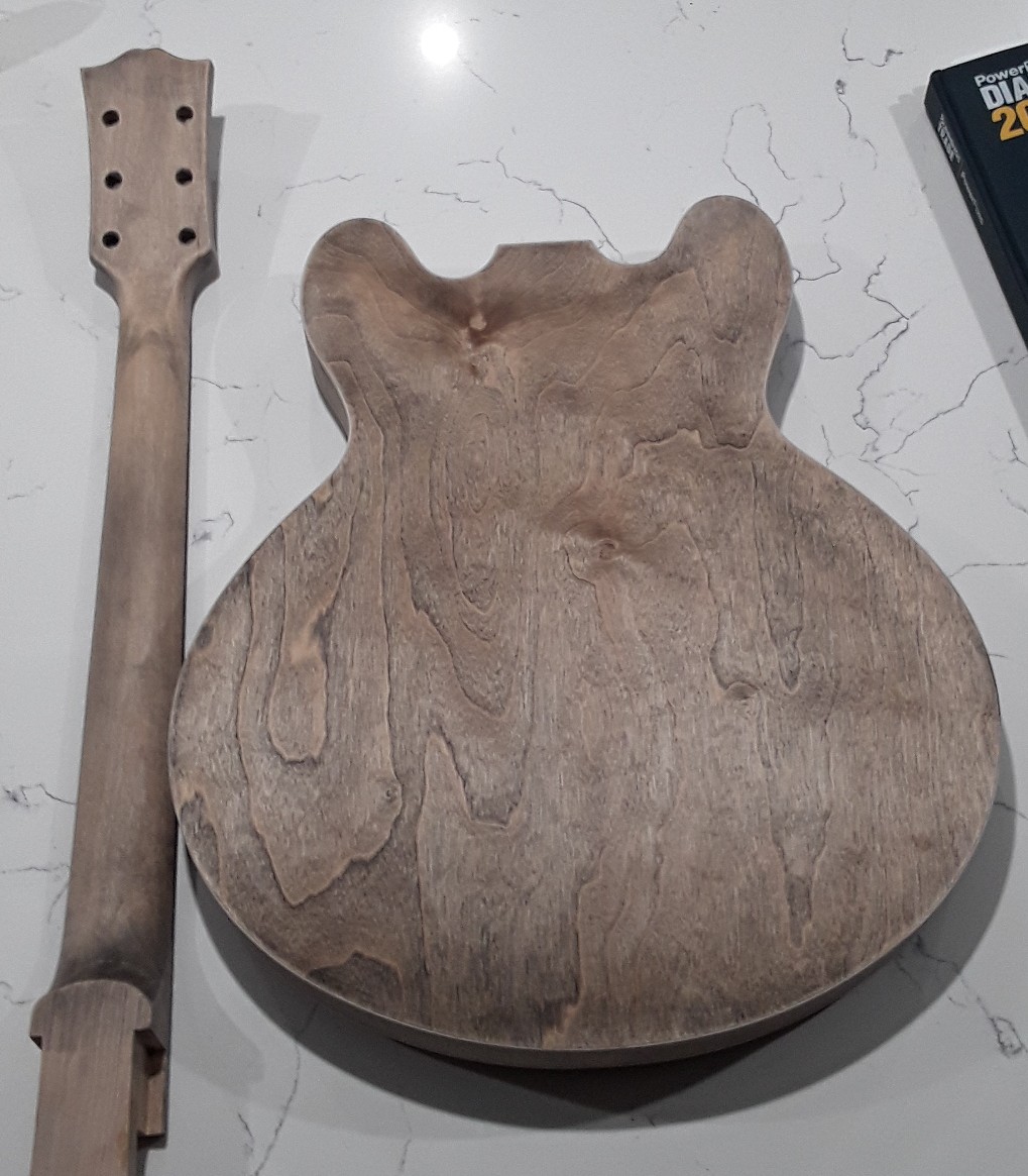

2 Attachment(s)
Attachment 25279Attachment 25280
Im hoping to stain the back bondi blue then use this over the top
