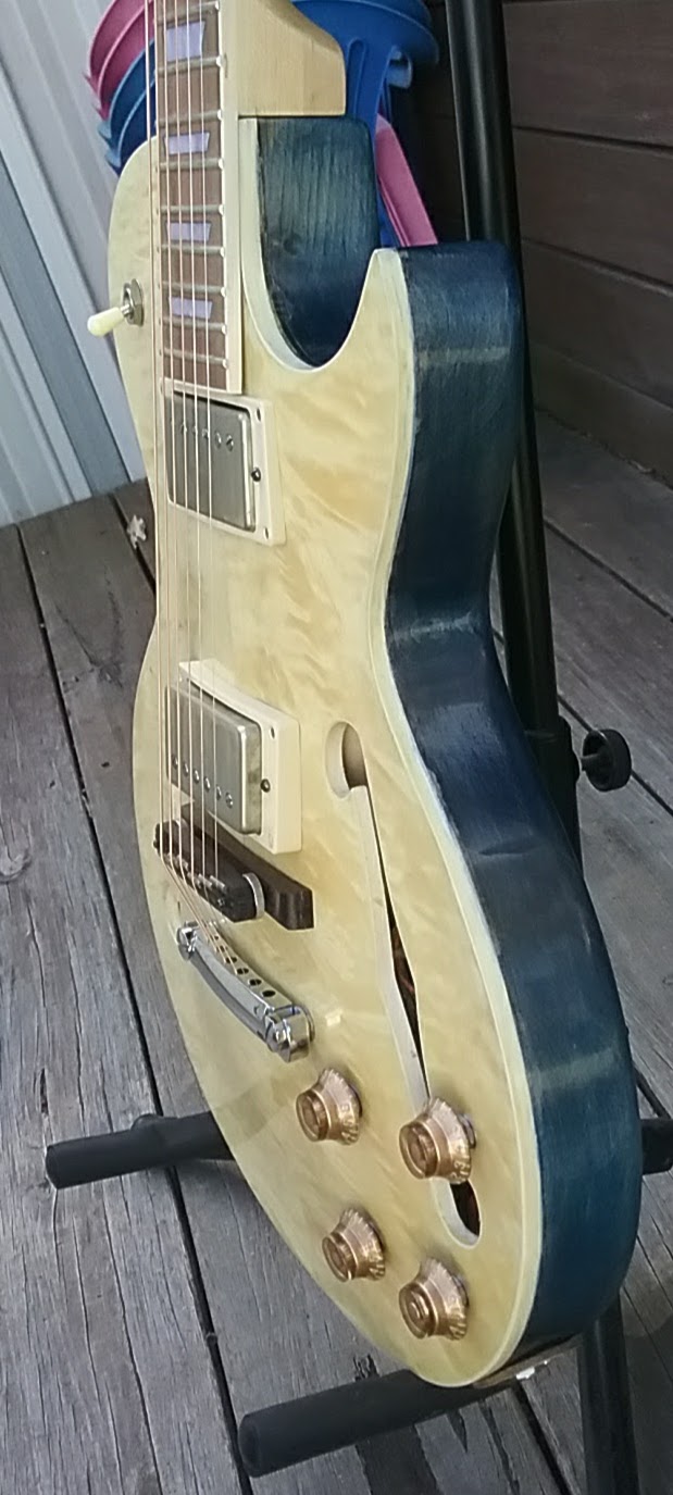

1 Attachment(s)
Nice kit lucas, the one i made is great to play, id stain the quilt it will look amazing Attachment 24762you wont be sorry this is how mine burned out
