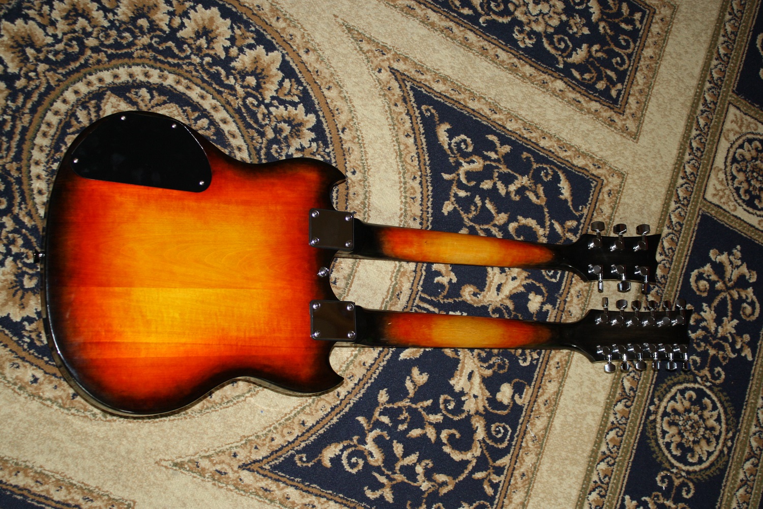

Hi YS,
The burst on my SGD-612 is with Coolangatta gold in the middle, a mixture of 50/50 Outback sunset and Karajini red and Black stump for the outer edges.
Attachment 23611
