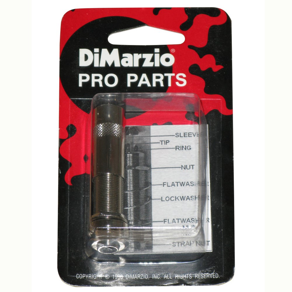

I have an Entwistle Zebra hum bucker and Babicz trem bridge on back order - apparently some of the wild weather in the states has caused some issues that end. Then it will be new pots, jack and capacitor.
